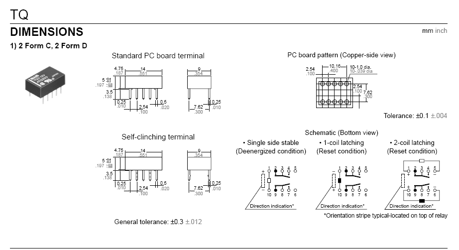

What part number of relay is that? Have you got a jumper where the PCB has "note" since you said its a 12V type? Have you installed the diode under the relay in the right way? BC517 and the proper relays by Omron, Nais TQ series, or NEC had 100% score of working together in the multitude of builds referred here at least. They normally take a couple of seconds to click.
Omron G6H-2 12V.
Sure I have a jumper and a diode in the right direction (it's actually some ultra fast 1A 40v Schottky, but there is no difference here I guess). I get exactly 12vdc after the reg, so should be something in BCs/ relay area. Will take a look again this evening for possible mistakes been made.
a darlington bc517 is not the correct way to switch a relay.
Use two separate transistors. A driver to tell the switcher to activate the relay coil.
Set the switcher to ~hFE=10 for lowest Vsat (10mV to 100mV) while ON.
The lowest Vsat for darlington is ~700mV and that is a big proportion of a 5V supply feeding a 5V relay coil.

The line marked side goes towards the diode on the PCB. This attachment will help picture the internal connections also.

Change the diode to a normal one pls.
no:D
seriously I've swapped it to IN4002 and as there was no difference, so I put my ulta hi-end Schottky IN5819 back :D
Anyway, the problem has been solved by replacing BC550 with BC639, works flawlessly now! BC550 was kindly asked to leave the pcb and find some more cosy place in the rubbish bin...mkt cap also has been removed.
