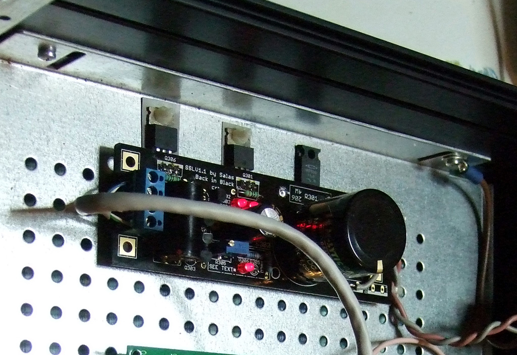

Guys what resistors do you propose trying in the CCS?
The final value for me is 1R giving ~1,1A.
Resistors I am considering are 5W mills, 5w duelunds and MP Caddock

I cant' say nothing for Duelunds but I've tried in my Mez, for CCS setting resistors: Mills, Caddocks and plain MOX.
The resistor that sounded fuller, more detailed and musical was the Caddock.
The MOX is a bit harsh but detailed, the Mills,sweet but a bit dull with loss of detail.
In a similar app (the CCS setting resistor of my My_Ref variant PS) Caddock MP were better than any audio grade and industrial resistor I've tried (KOA SPR, PRPs, carbon film, metal film, tantalum film, etc.)
That s cool 🙂 Are you talking about MP915 series?
And they are really cheaper than the rest too 🙂 Plus they should be easy to mount on a heatsink themselves.
No, I'm talking about MP930. I think they're better suited for a hot rodded Salas shunt.
I've used MP915 for my simple shunt on the My_Ref.
But it depends also on how well they're heatsinked... 😉
Dario, like this MP930 one I used in the photo?
Exactly 🙂
Cool! MP930s, That's what I used too. I just happened to have a pair of 10 Ohm in the parts bin, In the other set of holes I used a pair of millitary grade 1% metal film 21.5 Ohms = 6.8 Ohm HOT ROD!!

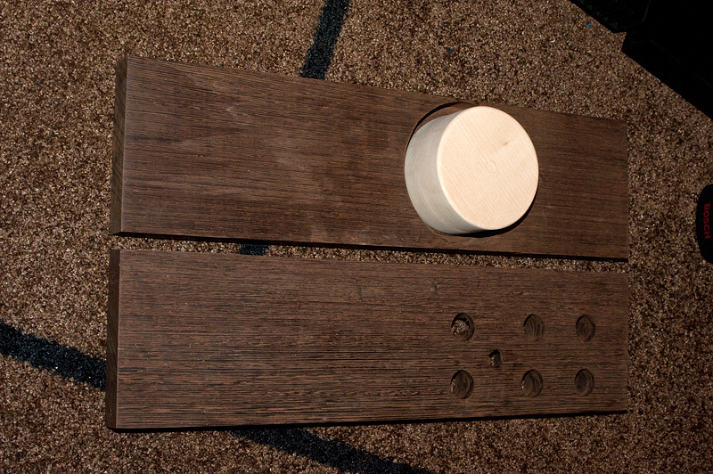

I finally managed to get a circular saw, so I worked on the chassis today.
Here are the front and back panels. They were cut to size, squared and sanded (back is upside down :S )
I still have to open the led and IEC holes but I am exhausted and it s getting too late to use the router....
I still have to decide how I am going to finish the wenge. I tried some raw linseed oil on a scrap piece but it s getting too dark. I might leave it like this and just finish the knob to protected it from hand-dirt. The end grain is pulling dirt like a magnet...
The knob's face was rounded a bit and its base was routed so it is now about 2cms in the front panel, with a padding of about 7mm around it. It looks very nice IRL. The photo is not doing it justice... I love it so far... I just need to be extra careful not to ruin it now with some silly mistake...
Tomorrow I will cut the side panels and hopefully start gluing it together

I tried to apply a layer of oil on the knob, but the end grain is getting really ugly... seems like it s dirty...
Possible alternatives... hmm... I have some sipo mahogany but I don t think I like the combination...
I think I will route the knob out of the wenge too...
