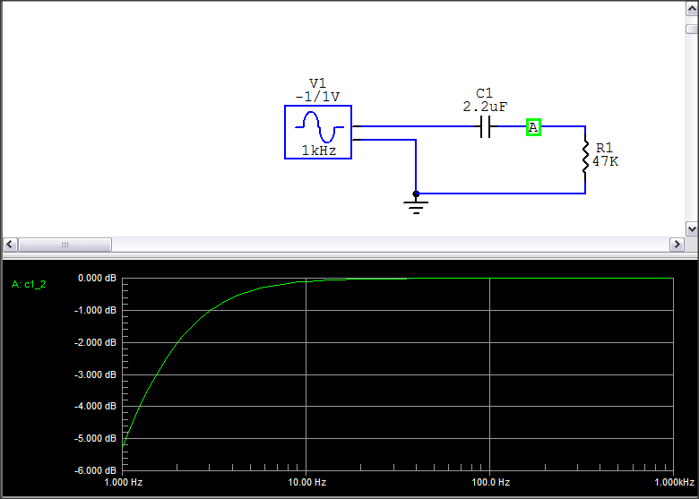

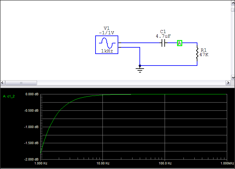

I am currently building a DCB1, but really do need to use output caps as my LFD amp is DC-coupled with no servo.
I saw a drawing somewhere of a recommended configuration, something like a 2.2uf cap with a 1M resistor to ground? If someone could advise on this that'd be great.
Best regards,
Neil
Enough, but not very deep for minimal phase turn, 4.7uF even deeper.

Good choices.
If you really got space in the box, I would recommend 4 monstrous 2.2uF Russian capacitors to make two 4.4uF pairs bypassing each pair with 0.1uF monstrous Russian Teflon. I believe they exceed the German silver in oil type even in that config for far far less.

Salas,
I have settled on ~90ms as the RC for the DC blocking filter in my systems.
I have presented this many times and I get repeatedly told that I cannot possibly hear any difference in bass response with the filter set this low.
You are proposing 4u5F and 47k for an RC of >210ms which is more than an octave lower.
What do you find when using this frequency for your power amp roll off ?
