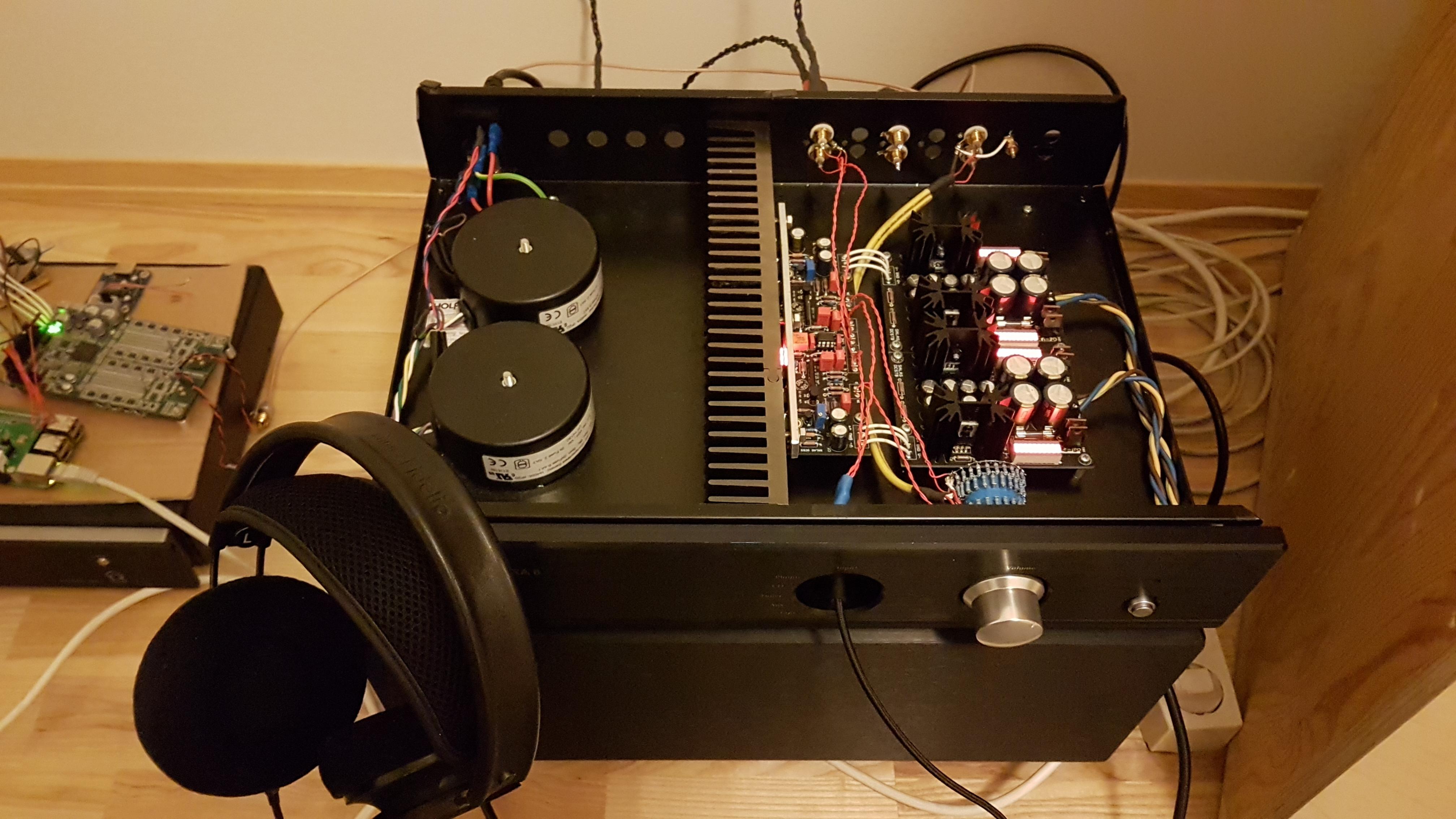

Testing as headphone amp. Headphones is philips fidelio x2. This is the best amp for its purpose I have ever heard/tested.
Many thanks to Salas and Tea-Bag for this opportunity.

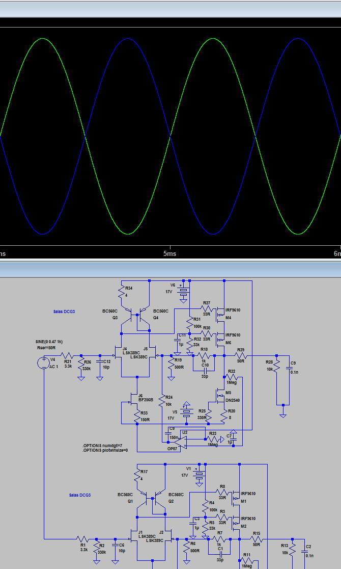

Salas, advice is needed. Could it work in simulation.
thanks.
Apparently it can create opposite phases by simply connecting a source floating across two inputs. The 2nd harmonic will go higher than with normal SE in each phase and it can rely on a truly differential power amp to cancel it out. Blue & green traces are the outputs.

this similarly mean connecting the DCG3 R7 resistors to each other instead of to Ground in a balanced build?
thanks.
Since only transducers could be floating sources, when you don't want to use something like this http://www.mouser.com/ds/2/609/AD8476-877860.pdf for SE source to precision DIF, the two 499R can be lifted from GND and tied together while the second input is tied to GND. That would give equal to SE 2nd harmonic after a differential next (power) stage, not canceling due to pseudo balanced source input. Depicted with a differential op-amp next stage for simplicity while plotting the channels phase outputs and the red trace op-amp's recombination output.
Some coax length with its shield on one end grounded could be used for connecting those resistors since there is enough physical distance between two channels.
Wow Salas that is great!
I had to read what you wrote three times before I think I understood.
So what you are saying, please correct me if I am wrong, is that the DCG3 bal which has two DCG3 gain blocks will do a SE to balanced output if the SE input + is connected to the +phase and the SE reference is connected to the _ phase but the H2 will be slightly higher.
Also, it will do SE to balanced output if the two R7 499r are connected to each other instead of to ground and the _phase input is grounded and the H2 is similar to the SE version of the DCG3.
Does it therefore make sense that in a balanced DCG3 build one should tie the two 499R's together irrespective of whether one is using a pure differential input from lets say a balanced DAC or a SE to balanced converter like the AD8476 or a SE source directly with _phase appropriately grounded. BTW the distance between the two R7's is only 42mm.

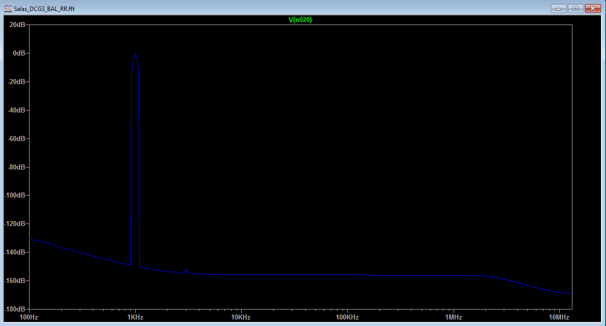

1) If you have a true balanced source (a floating transducer or differential DAC chip outputs like MagicBus/Kostas has) you need not do any mod. Only connect each phase to each channel. As he did. In that case any second harmonic in the phases nulls after recombination at a further differential stage's output (truly balanced symmetric power amp for instance) and the THD plot simulates as picture 1.
2) If you also have single ended (grounded to one side) source that you want to drive both phases channels from (pseudo balanced) you should connect the R7s together and ground the second channel's input as noted before. In that case after recombination in a further truly balanced stage the THD plot simulates as picture 2.
3) When connecting a truly differential source between channels inputs to the above configured (R7+R7) but with the second input not grounded you still get same simulated performance as picture 1. SE/BAL configuration switch or configuration jumper in the female XLRs will be needed when having both SE and BAL sources to choose from.
4) If you want to make an SE source behave like a truly balanced source your best bet is to use a special precision chip for such conversion jobs. So to potentially have the second harmonic null of picture 1 like Kostas was after. As much as it is possible by CMRR in a practical fully differential system (source to speaker).
But you may don't mind or like some low 2nd harmonic, also you may don't want more silicon in the way of your source signal. That way with an SE source and R7s connected + second input grounded you get picture 2 at best which is equivalent to using SE source and single DCG3 normal. Not too bad still (-112dBV 2H at 1kHz 1V output).
