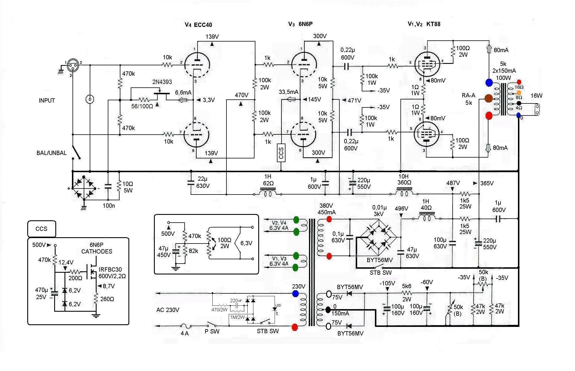

Audibly more than enough. Amps are KT88 push pull about 16W - input stage gain 29x driver stage gain 13x. Speakers SPL 94 db/W/mMaybe 0.7V RMS per phase after 6x in your case. Will it be enough for your amp?
Is there any feedback resistors divider setting a lower fixed gain in your tubes amp? Or all that gain (minus OPT ratio) is really there because open loop? If yes its alright, except insensitive cans would be under-served with that I/V source as you mentioned. Maybe get ~32 Ohm particularly sensitive cans like Philips Fidelio X2 which give 90dB SPL with only 90mV RMS and have great cans while you save from making a second dedicated buildAudibly more than enough. Amps are KT88 push pull about 16W - input stage gain 29x driver stage gain 13x. Speakers SPL 94 db/W/m

Amps are nothing impresive. My own design and construction for the diy satisfaction but I like the way they sound. I attach schematic.Is there any feedback resistors divider setting a lower fixed gain in your tubes amp? Or all that gain (minus OPT ratio) is really there because open loop? If yes its alright, except insensitive cans would be under-served with that I/V source as you mentioned. Maybe get ~32 Ohm particularly sensitive cans like Philips Fidelio X2 which give 90dB SPL with only 90mV RMS and have great cans while you save from making a second dedicated build

If I understand correctly you suggest to ground the negative phase so that balanced output is maintened with SE input. This is the proper way when we deal with a differential amp - LTP - but dcg3 isn't such. Do you think it will work? Anyway I would like to have options for bal in/bal out or SE in/SE out in my system. Should line out be grounded?Nice!
Does it work properly when you are using RCA SE input?
The issue I see is that when you use SE input the signal goes to the + phase of your PCB but for the - phase to work you need to connect the - Phase on the PCB to your signal reference which you have chosen as the chassis. A solution for this is to connect a wire between the -phase input on the PCB to signal reference with a switch in between. You flip the switch when using SE input which will then make a connection to chassis in your case. Flip the switch the other way when using XLR. Otherwise you will be powering up both phases but using only the + phase and will not accrue any of the benefits of this setup.
Again when using SE output the - half of your amp is not connected to anything and is in essence floating in the wind. Some work better with the output grounded. Maybe Salas can inform whether this will cause any problems.
nash
Yes. I do it on my BA3 bal pre. You can measure the output from both phases using SE input this way to confirm that you are getting output from each phase. However, I connect RCA signal reference to the PCB not the chassis.
You can connect the - phase output to the signal reference, or leave it floating or connect it to a resistor to signal reference of the same value as the input resistance in your power amp to simulate a balanced impedance connection, whichever sounds best. I would feel more comfortable with the resistor approach. Or you can combine both phases thru a transformer at the input of your SE power amp.
Yes, wrt noise a switch to ground the unused phase is necessary. Output would still be SE wouldn't it?
Yes, it will be using half the build only. Maybe better do that at the input than engaging the "unbal" at the power amp in case some DC transient can short through the output stage and relay. Although there is a 10 Ohm in your build across a lift bridge so not a dead sort. But I don't know, maybe simply doing nothing is still noiseless and sounds exactly the same in your set up. You will have to examine the practicalities because no experience for that config from the rest of us with dcg3.

MagicBus rethinking this I feel I may have confused you a bit with the switch etc.
Basically with a SE input you need to connect the + of the incoming signal to the + phase of the PCB and the incoming signal reference to the - phase of the PCB. Doing this will result in output from both + and - phases. Hope this helps.
