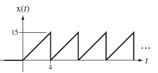

That is why I always test the TX wiring using a ramp signal

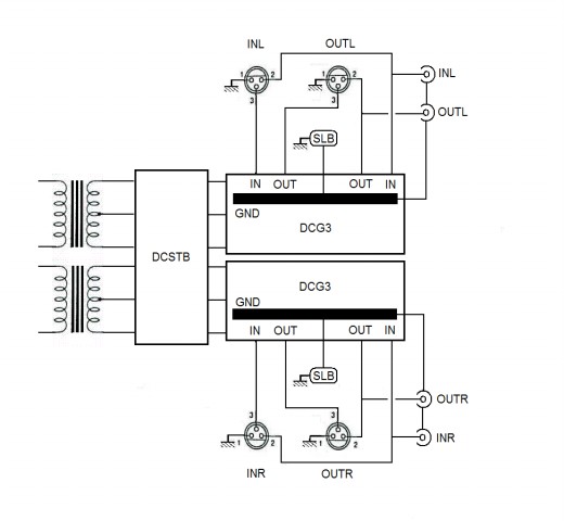

Here it is! Sans front and top covers but fully operational. Drilling and wiring XLRs is not what I enjoy mostly but I'm glad it works the way I did it. Please refer to the attached schematic. To be honest, I was expecting to have troubles with input XLR pin 1 connected to chassis. This is the way to connect differential amps but DCG3 isn't such. I guess signal passes through the ground lifters. I'll test it with and without SLBs.
At the time being, I've only had a brief test to confirm it delivers sound. I took the risk to connect it directly on my PCM 1792 current output DAC chip with a single 2 ohms resistor for I/V conversion. That means 11mV DC offset at the input of DCG3 but it doesn't seem to bother It also means that the signal level is too low. I was anxious about that because DCG3 was going to sit in place of a 18x preamp. Well it does thunderus levels as line stage and, of course rather weak as headphone amp on my 600 ohms AKG K180. But neither the 18x preamp could move them in this set up. For this, another DCG3 after the first is needed Did I mentioned that there is not any coupling capacitor or transformer between the DAC chip and DCG3 output?
There will be intense listening seasions during the weekend, I hope!
First balanced setup! Can I steal the pics for blog?
So far so good. No drama. What is the expected 0dbV RMS level of the I/V and what gain you set in the preamp?
Tea-Bag, you did great job with the kits! DC offset @ all four outputs is less than 1mV! Of course you can use the pics for your blog. I have them in higher resolution if it helps.First balanced setup! Can I steal the pics for blog?
