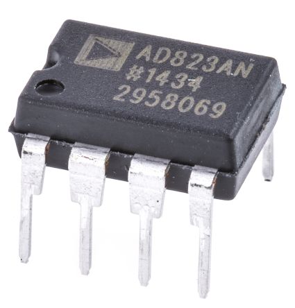

You couldShut down, still holding around 1 mV offset, time to shut down. Do you think I should try same AD823?
I just sure dont want it to cook my pre amp, I have from mouser AD823ANZ, 3 of them. There is a small divot mark on one end, that end goes towards the relay, and small U shaped cut out on the mount it plugs into right? If there is a possibility it damaging components I will just put a new one. If it just wont work right if damaged, but no harm to preamp circuit, I'm game to try it.
Possible the old one could damage something? Now that I have the signal wires back on I could have music through it in a few!

No hum, very quiet at speaker. nutz only getting sound one speaker. Maybe mis wire at volume pot. both sides still bias at .93ish, offset low. Did spot a miss wire, but shouldnt of caused this, on of the inputs had line G mixed with In. Fixed that fired it back up. Now it hums and there is no sound from either channel. checking bias, as normal. Offset....1.5V. Yes 1.5 volt.
Swapping hot for cold signal side can mute a channel. Offset is another domain, DC. Not directly related unless something else went wrong. Like a Mosfet shorted on bad insulation again as you moved the assembly. Check that you still got correct rail voltages, and that the output relay system still works as fixed. Same for the input relays selector board. Check the rest of your wiring and try the offset procedure again.
I think this thing is haunted. Powered down, waited to drain and pulled AD823. That one did not fit well in the socket like the first one.
sort of rocked back and forth if you pressed on it. Without AD823, I was able to get to 0 or there abouts, powered down, drained and installed new Ad823 which fit tight like the first one. Offset back to normal, I probably still dont have both channels.
Seems to have worked, that explains the dropped channel. let it cook a minute or two to see if it acts up again. Hopefully the bad fitting AD823 was the cause. It just didnt seat firmly. Pressing on it, it sort of rocked from one side to the other. This one pressed in firm, no rock. Yet.Swapping hot for cold signal side can mute a channel. Offset is another domain, DC. Not directly related unless something else went wrong. Like a Mosfet shorted on bad insulation again as you moved the assembly. Check that you still got correct rail voltages, and that the output relay system still works as fixed. Same for the input relays selector board. Check the rest of your wiring and try the offset procedure again.

It has run for two solid nights, offset typically .5, a little more or a little less. I'm calling it good. All the smoke stayed inside this time, except one BC550 and it's zener buddy next door. I am pretty sure it was occasioned on first fire up. I saw a tiny spark on one end of a fuse holder in power supply. Fuse popped in that location, light bar next door went dead. That is when I figured (with Salas"s help) the BC550 and zener were toasted. Once they were gone, offset adjustment was for naught, turning them had no effect, offset just cruised up and down never settling.
When I checked continuity on the mosfets, trouble, several buzzed. What I learned is the tightness required isnt as much as I thought, and over tightening compresses everything so much contact is made. Loosening them a touch solved the continuity issue. It has played wonderfully since.
