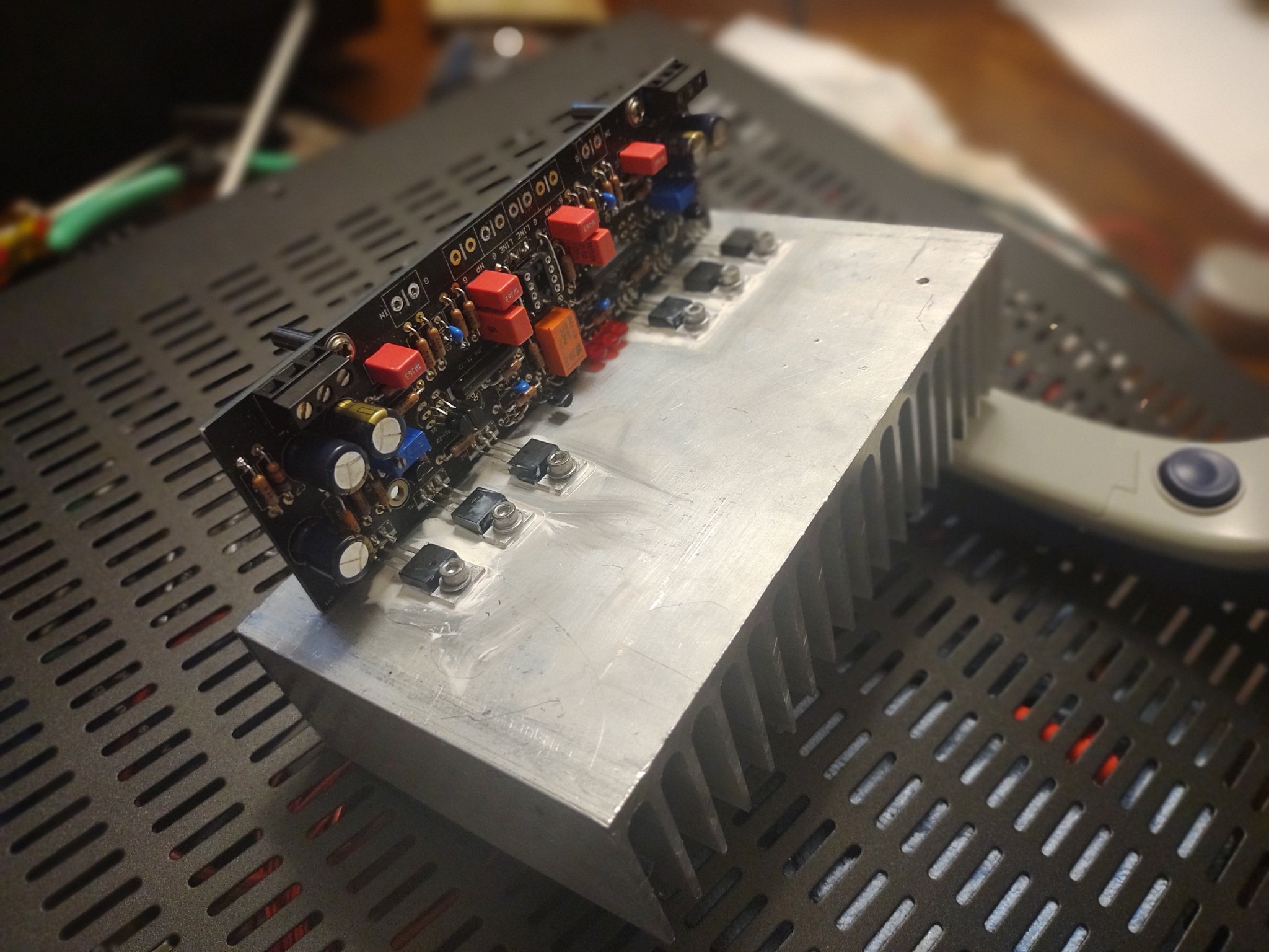

Guess it's time to remove preamp board. Good excuse to get the extra goop off the heatsink. Since I would have to prove those pieces to test, I think I will just replace them.
The heatsink is not yet screwed to chassis, so by loosening the 6 wires from PS, removing screws to standoffs entire heatsink preamp board can be removed. I will reattach it temporarily with longer wires so I can work on it "out of chassis."

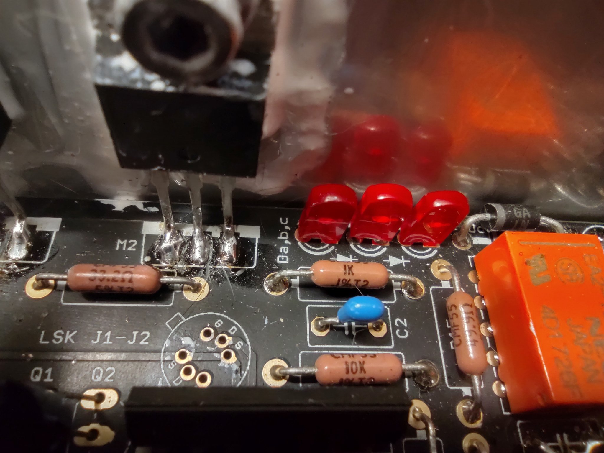

Here's the 3 LEDs. They light right up on fire up.

That is exactly what is going on. LEDs light just before light bars on PS if I remember correctly.If there's no 5sec delay until they light up after you hit power "on" its further proof that the delay circuit isn't doing its job.
