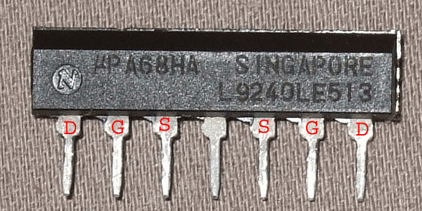

You could start by measuring Vgs for Mosfets (Vdc btween pins 1&3) 2-4V is good
Vbe for BC transistors (Vdc between pins 2&3) 0.55-0.7V is good
RDS (Ohms between pins D&S) for uPAs when the power is off. Should be in the tens or early hundreds of Ohms but not near short or in the kOhms.
RDS (Ohms between pins D&S) for uPAs when the powe is off. Should be in the tens or early hundreds of Ohms but not near short or in the kOhms.
Will it test installed or should I remove first on the upas?
