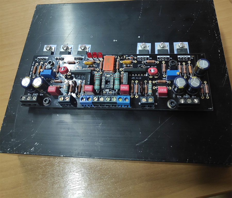

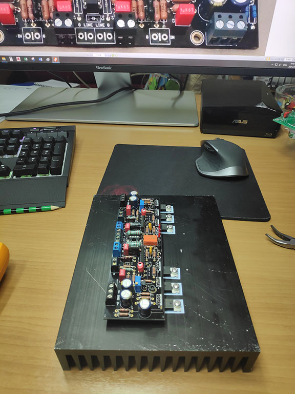

The correct res and caps has finally came...
You probably used this big heatsink because it was available, right ?
And there comes the question for those living in hot-climate countries (like Greece)
use big (maybe oversized) heatsink or give more ventilation to the chassis ?
Don't tell me to experiment, I have dozen projects, none closed, it's a course I tell ya 😛
Solid case looks cool not to mention that custom-made holes (laser/plasma cut) cost. But I'm worried about heat in summertime. One solution is to have the heatsink not enclosed even if put in the bottom of the chassis. Seen it in amps too, a whole part of the bottom cover cut in the dimensions of the heatsink.
The problem is not only the preamp module but also the psu. Even though DCSTB was colder than BIB/UBIBs the center heatsinks where quite hot.
