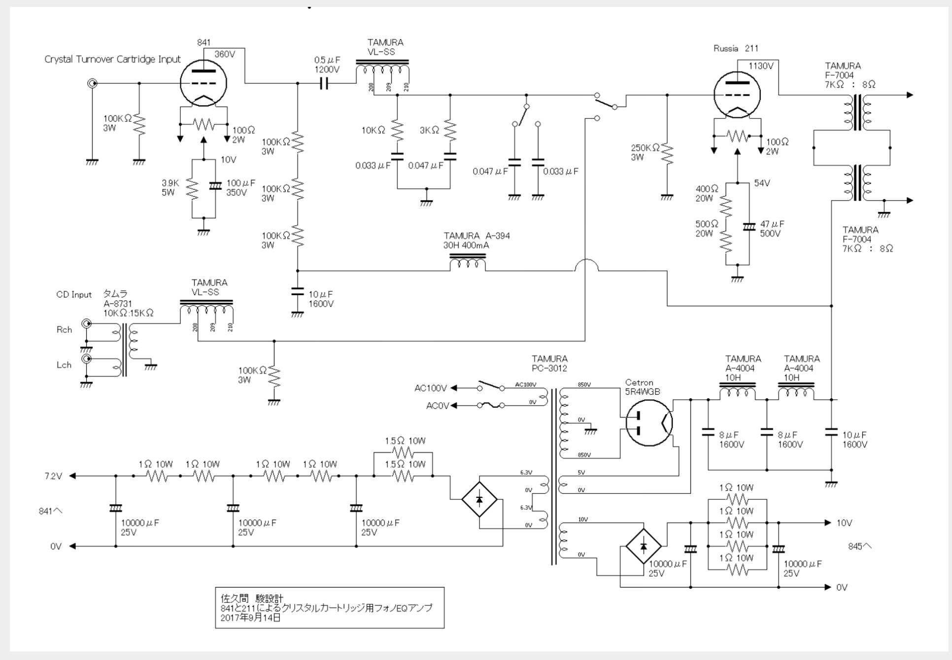

I really like this amp from Sakuma for its simplicity.
Can anyone experienced comment if it can work well?
I'd like, simplifying again, to think of it with a single 211 tube.

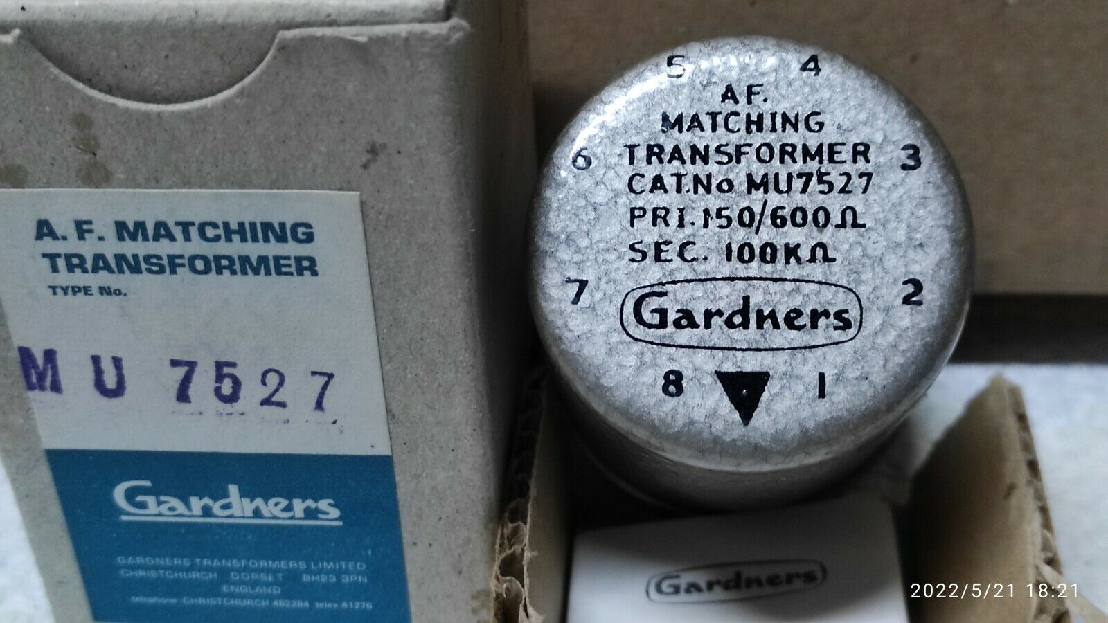

STU-001 I think they are now unobtainable. I have recently purchased two pairs of these gardners, they have the same characteristics. Of course I understand that a very powerful pre-amplifier is needed, but the great advantage is thus having one amplifier in two slim chassis, instead of a monster the size of an aircraft carrier. A 437A or EC8020 preamp terminated with a 5K/150 ohm TU would perhaps be able to give the 211 the necessary swing.

Quite a step up ratio on that input transformer. Is it even obtainable?
I am not aware of any transformers with these characteristics currently being produced and sold. Not so long ago, Tamura transformers with the same specifications as the STU-001 appeared on Ebay, but with a different initials. My Gardners are new and I bought them on Ebay at a very low price (30$ each) ...
Transformers with these ratios are not that uncommon, as they are usually MC step-up transformers. The Tamura TKS-27, for example, has the same ratio as the STU-001. The main difference between those transformers is the power rating/voltage swing they can deliver. For the TKS-27 it's 10dBm, for the STU-001 it's 5W(!). The TKS-27 is the size of a fat octal tube, the STU-001 the size of an output transformer...
The 211 amp from Sakuma it is a joke as other project of this man.
One consideration , the input pot is 150 ohm.
Have you considered how much will be the Zout of the source to get the right performance at - 6dB of attenuation ( just an example) ?
Also the frequency response (with this type of inupt trafo)?
Then other consideration can be made

Regarding the 211 circuit I haven’ t seen any answer to my question about the source that drive the amp

And I am asking again in which way you can drive properly a Sakuma 211 circuit of post nr. 99
Walter

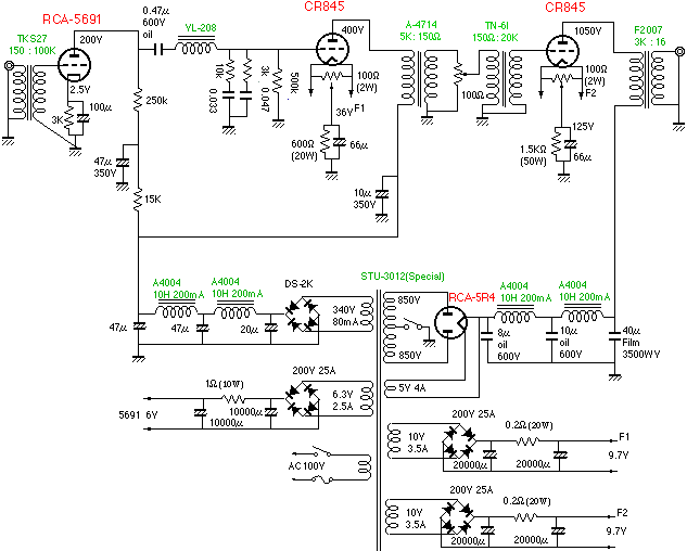

Sakuma liked low impedance drive, his volume controls were usually very low resistance by normal standards. Driving his amps was simply a case of using a suitable pre, no mystery involved.
Here‘s a phono pre based on an 841 driving a 211. And another pre using an 845 driving an 845. Low impedance outputs.
I picked a couple of extreme examples perhaps, he had many designs.
