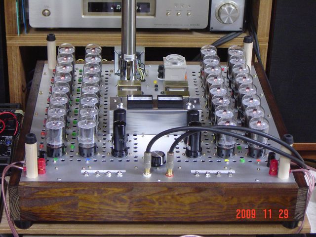

If you know anything about Sakuma you would quickly realize that he was in no sense designing high fidelity audio equipment, and never said he was, his intent was to design something that in his terms captured/recreated the emotion of the music; that was always his very personal quest and primary goal. He had some interesting ideas along the way, his later ideas are so far outside of accepted audio engineering practice not to mention theory that many of us don't/can't take it seriously. Bit of a let down frankly.
I quite like the concept. It is a bit eccentric the way the power tube is used in the supply filter, but please note that the current trough the "shunt" is 15 times larger than the current in the gain stage, so the psu sees a "soft" static load. The second choke is 10 times larger value so current in the signal loop will see a much larger impedance looking toward the power supply. It feels like crude current fed shunt. I bet it sounds clean and with super rich and saturated tone rendition. Will try it some day.
Any additional steady load on the power supply makes the power line ripple worse.
The 300B looks like it was installed there for a play-off against the 841 tube originally. Then got wired in as an AC load for some mysterious reason.
Now if the 300B grid were driven by a sample of the AC ripple, it could remove the supply output ripple as an active Aikido style noise reducer.
You are absolutely right , but that is the art part in the Sakuma amp.
It will increase the psu ripple that is a repetitive noise but it will prevent the modulation of it and all the by products that are really annoying.
Ok, Sakuma-san is looking for a sound of his own, nothing close to the sound of an acoustic instrument, rather a sound reminiscent of an old AM radio, albeit a very good one. Reaching that ideal sound is the art part.
But all this still does not explains why to use a complete SE triode stage to load the power supply: soundwise a bleeder resistor could do - more or less - the same (yes, I agree it helps).

The 300B was already there for a playoff against the 841. So it became a convenient 40 Watt resistor to use, without the smell of burning phenolic added to the ambiance.
Improvement: short out the input xfmr load, and AC couple some power supply ripple to the 300B grid.
