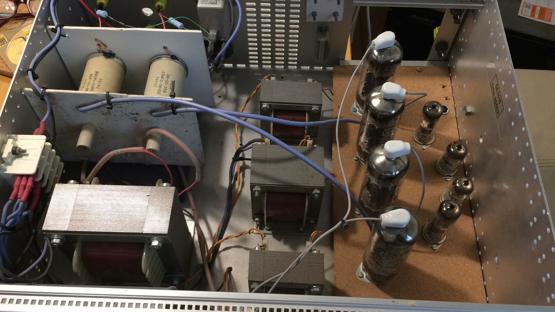

A dog run thru my amp the other day (i was demonstrating the amp at a friends house) when someone opened the front door. He got so exited, as dogs can get, and kicked out some tubes. Luckily the amp was not powered at that moment. I like hot dog but not in this way.
A lesson learned!

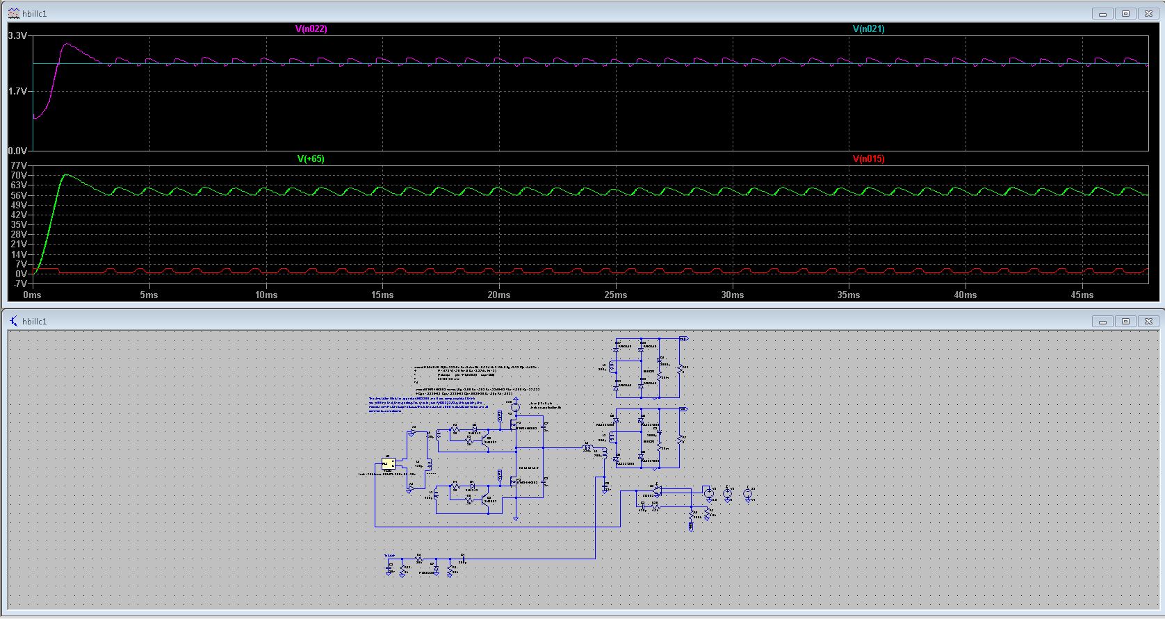

Busy with designing, or better reading and then designing a resonant smps for hybrid amp, now busy with filament and HV smps, I was advised a flyback, but I do halfbridge resonant with smaller fets, resonant is much cleaner with EMI and that is better for the amp, smps are nice things make amp smaller. I think for both supplys, there is no need for a regulation, I can use voltage regulators.

I also use resonant power supplies with many of my amps and D/A converters. No need for regulators indeed.
