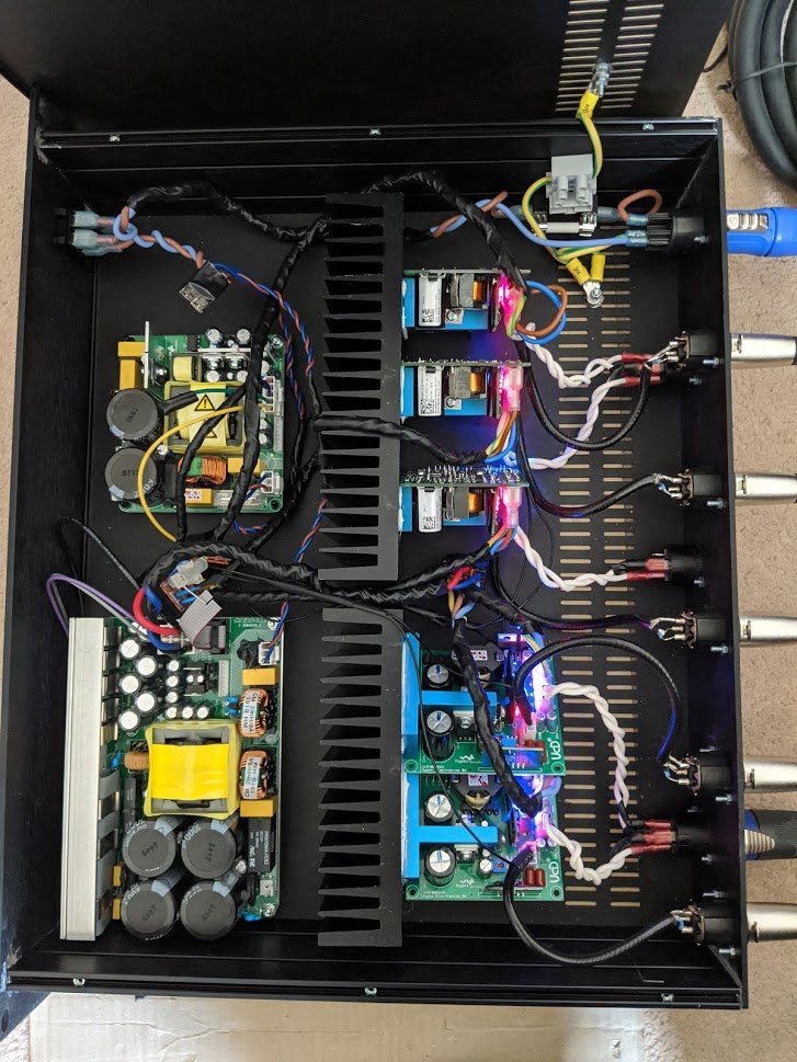

I managed to get the amp built and working thanks to the advice in this thread, chassis seems safely grounded (as per the approach outlined by @sq225917) and no audible noise issues.
By audible I mean, I can connect a 110dB CD to it and if I put that next to my ear then the noise is consistent across every channel, this is inaudible at maybe a foot or so away. Whether this is a good result or not I don't know but it doesn't seem to be an issue for me.
A pic of the interior for reference, if there is anything that could be improved then appreciate any tips. Hindsight says I should have cut the signal cables a bit shorter & used separate heatsinks for the 3 amps so I could run power cables between the heatsinks.
I had bought the parts already before this thread so decided to build it as is but the bit I still don't understand is why I don't have a problem with hum. The XLR connectors are grounded to the chassis and the chassis is earthed so why no noise problem? (which I was expecting given comments in the thread). I am clearly missing something.

It looks OK but using "open" fuse blocks is unsafe. This while a fused terminal block is also used. Please rewire to the existing fused terminal block and click in the black part with a suitable fuse in it.
I see you used a double pole switch which is good. Also completely insulated AMP connectors, hurray! The mains wiring to the on/off switch was too short hence the "dangling in the air" solution. I would use a terminal block there.
So you are unsatisfied not having hum? 🙂 I don't know if you connected audio GND to PE?! I am not hindered by any knowledge of XLR systems but connecting the outer shield to PE is not the same as connecting the audio GND pin to PE in the connector is it?
Problems occur when using unbalanced stuff and every device has audio GND connected to PE directly. Please use the search function on any anglosaxon audio forum for "hum problems" as they come for free with that direct audio GND - PE connection system when used in every available device. They call it ground loop problems. When using an FM tuner with centralised antenna system it will occur as the shield of the coax cable is normally connected to PE.

Thanks for the advice, I'll change the fuse.
The dangling in the air bit is a terminal block which splits the wire from the switch to the 2 power supplies, the wire is a bit short so I change it if the block dangling in the air is unsafe/inadvisable.

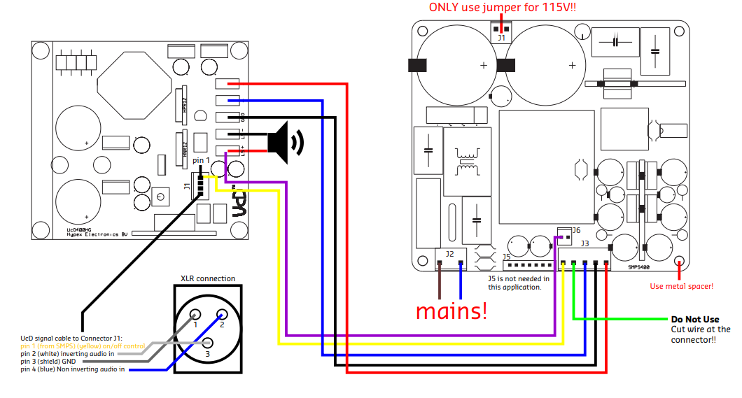

I think this goes to show that I don't know what audio ground actually is specifically, at least not in reference to some of the other docs I've read anyway. For example, is it the same as the "signal reference" from Audio Component Grounding and Interconnection ?
My wiring is basically as per the hypex docs so you can see 2 things called GND in this scheme, one connected to the shield (and hence pin 1 & the chassis) and another connected to the power supply (the thicker black line).

The Hypex drawing is illogical to me as you need specific module info with it.
