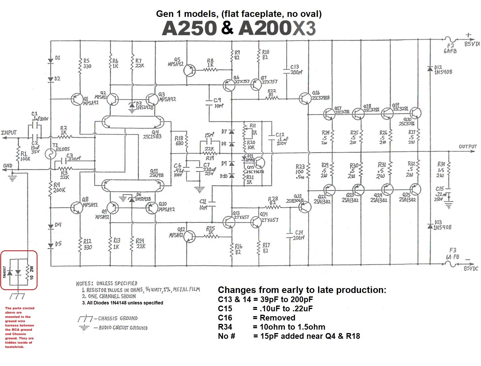

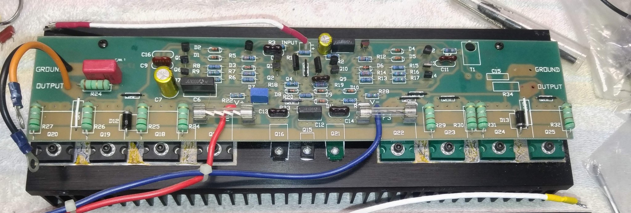

This SAE amp is a virtual clone of the Acurus A250 amp. Picture of stock Acurus A250 board and schematic for the A250 is attached. Its obvious the same person/company designed these two boards. In fact, these appear to be amp modules and even the heat sinks, bolt patterns for the covers, etc, look identical. It'd be interesting to find out who, Mondial or SAE or some other company designed these boards.
The layout of the board is just about identical between the two. The input is a cascoded complimentary diff with active current sources, and the location of all of these components is identical between the Acurus and SAE boards. Mondial did install a bias adjustment circuit and pot. Mondial also has their thermal switch in the same place as the SAE amp only Mondial used a TO-220 style flat plastic pkg'd switch there versus the round thermal switch and subsequent cut-out in the board to accommodate the height of the switch for the SAE. Funny, none of the Acurus amps ever used an inductor in the output like the SAE has, but one of the old Acurus A250 schematics has an inductor hand drawn into it on the input. Mondial integrated the output zobel onto the board, where SAE had it hanging off of the binding posts. So it appears that the Mondial Acurus boards are updated versions of the older SAE design if I had to guess anyway....

Looking at the schematic from post 1, I would guess vrery nice sound out of that old beast.
Only that two capacitors (C90 and C91) worries me but could be I'm wrong.

The schematic in Post #1 is in no way related to this amplifier. Your 1st big clue is the fact that the amp schematic in Post #1 uses sixteen 3281/1302 output transistors per channel. The SAE A205 amp that is pictured in post #1 only uses eight 3281/1302 output transistors per channel.
The Acurus schematic I attached in Post #43 is about as close as you're going to get to viewing this SAE A205 amp, but it should be about 98% accurate.
The earliest versions of the Acurus amps used 1 watt rated TO-92L MPSW92/42's for Q6,Q7,Q13,Q14. Later versions used the 1 watt rated ZTX657/757 combo in that location as shown in the schematic I posted. I see that this SAE amp used the MPSW 1watt parts on one side and standard 625mW rated MPS parts on the opposite polarity and then used heatsinks due to the lower wattage rating. I guess their supplier was out of the MPSW parts.
I see 1988 date codes on the primary capacitors in the amp shown in the 1st post and 1990 date codes on the primary capacitors of the amp shown later by the OP. Based on this I would surmise these amps were built late 80's and into the early 90's as the OP suggests in post #44. This aligns with the timeline of the Acurus amps that came out in the early 90's and used an upgraded version of this same board and circuit.

I've worked with one of the earliest Acurus A250 where the PCB's came with a fixed resistor instead of a BIAS-pot, about 620-680ohms if my memory is correct.
Looking at the pictures on page 2, I'll bet the A250-schematic besides form small minutes as posted by @Chamberman would be almost identical to the SAE.
The 90's Acurus amplifier lineup are quite easy to make a decent performer with a few mods, I'll bet the SAE would benefit the same by the looks.

Installing a bias pot into the bias control transistor voltage divider network shouldn't be a problem. You can look at the Acurus schematic posted above to see how it's done. The Acurus A250 which uses the same heatsink but is running +/- 90vdc on the rails will bias at a max of 10mV as measured across one of the emitter resistors. However, Mondial spec'd it at like 5mV. If you're running really inefficient speakers then 10mV may be too high and overheat the stock heatsinks.

Be aware that R20 in the Acurus schematic BIAS-network states 10Kohm. This is a mistake, and original 1Kohm is used here.
