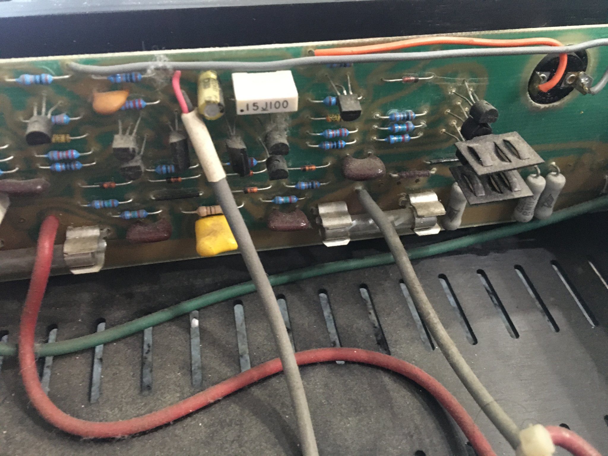

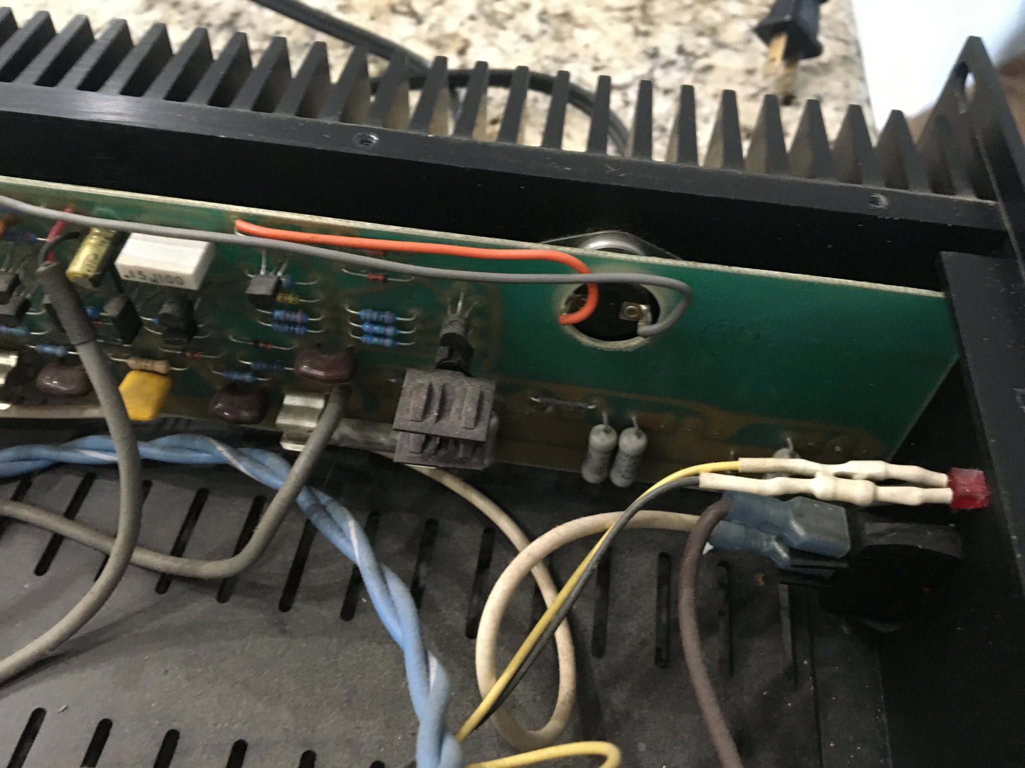

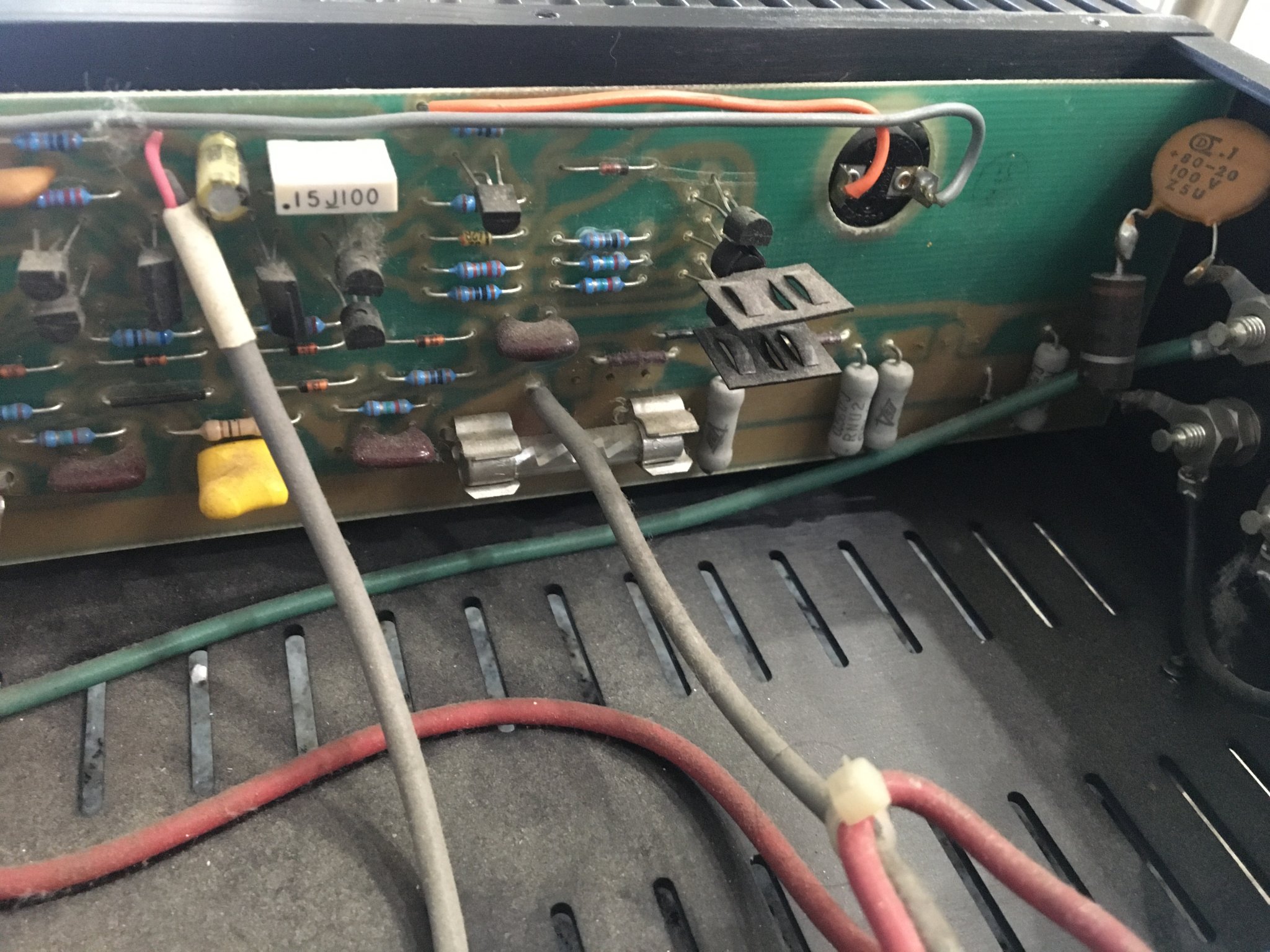

Switch on back could be a half Arsed hard bias adjustment of some sort , but not a trimmer.
measure the grey resistors ... any of them.

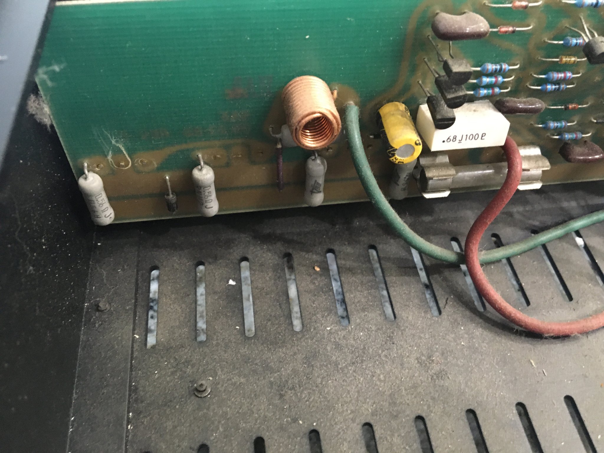

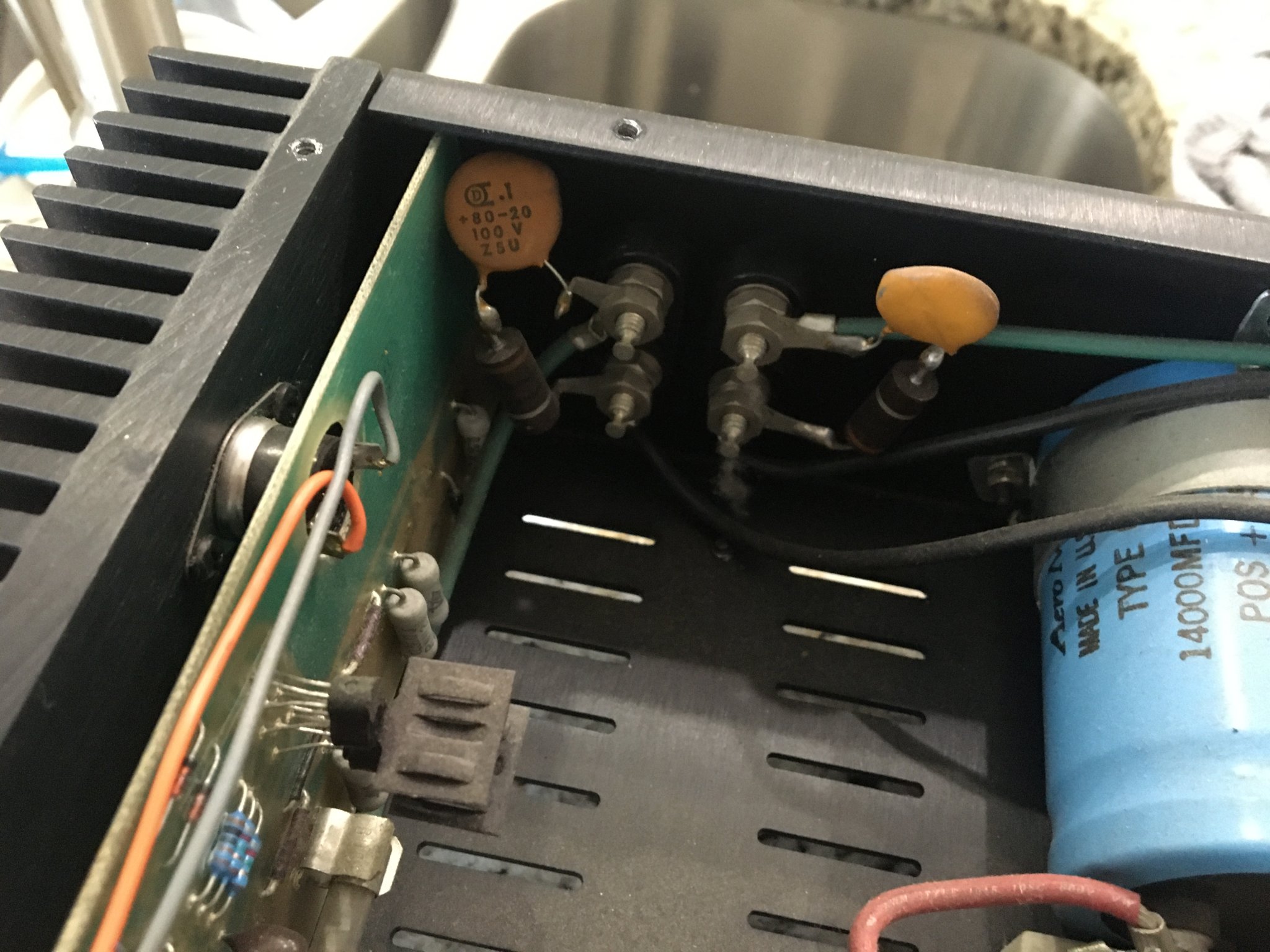

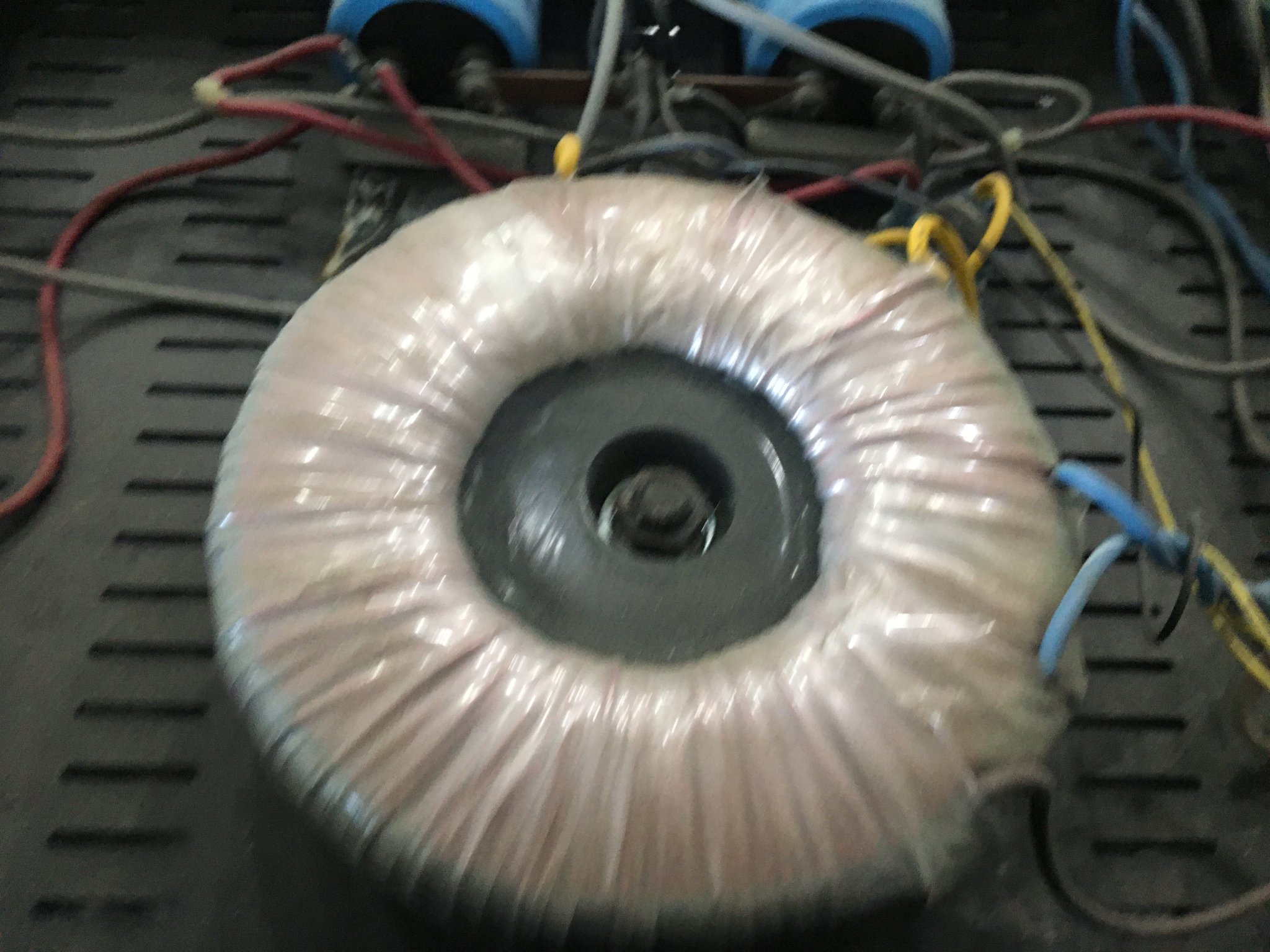

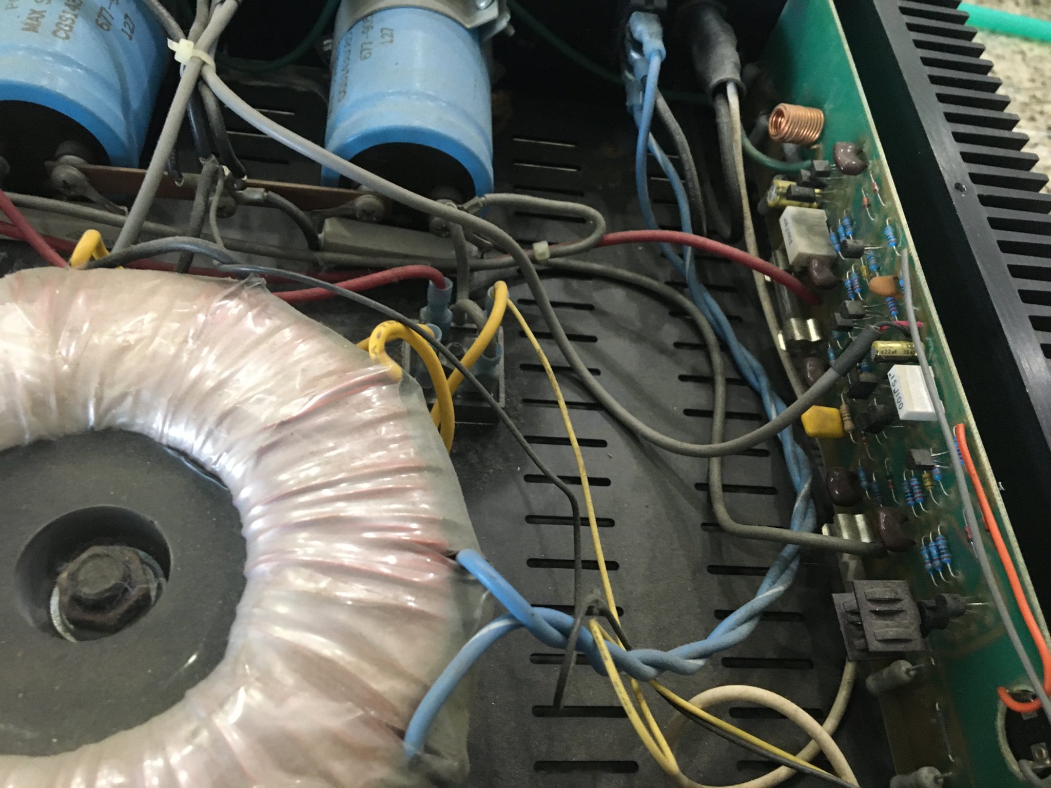

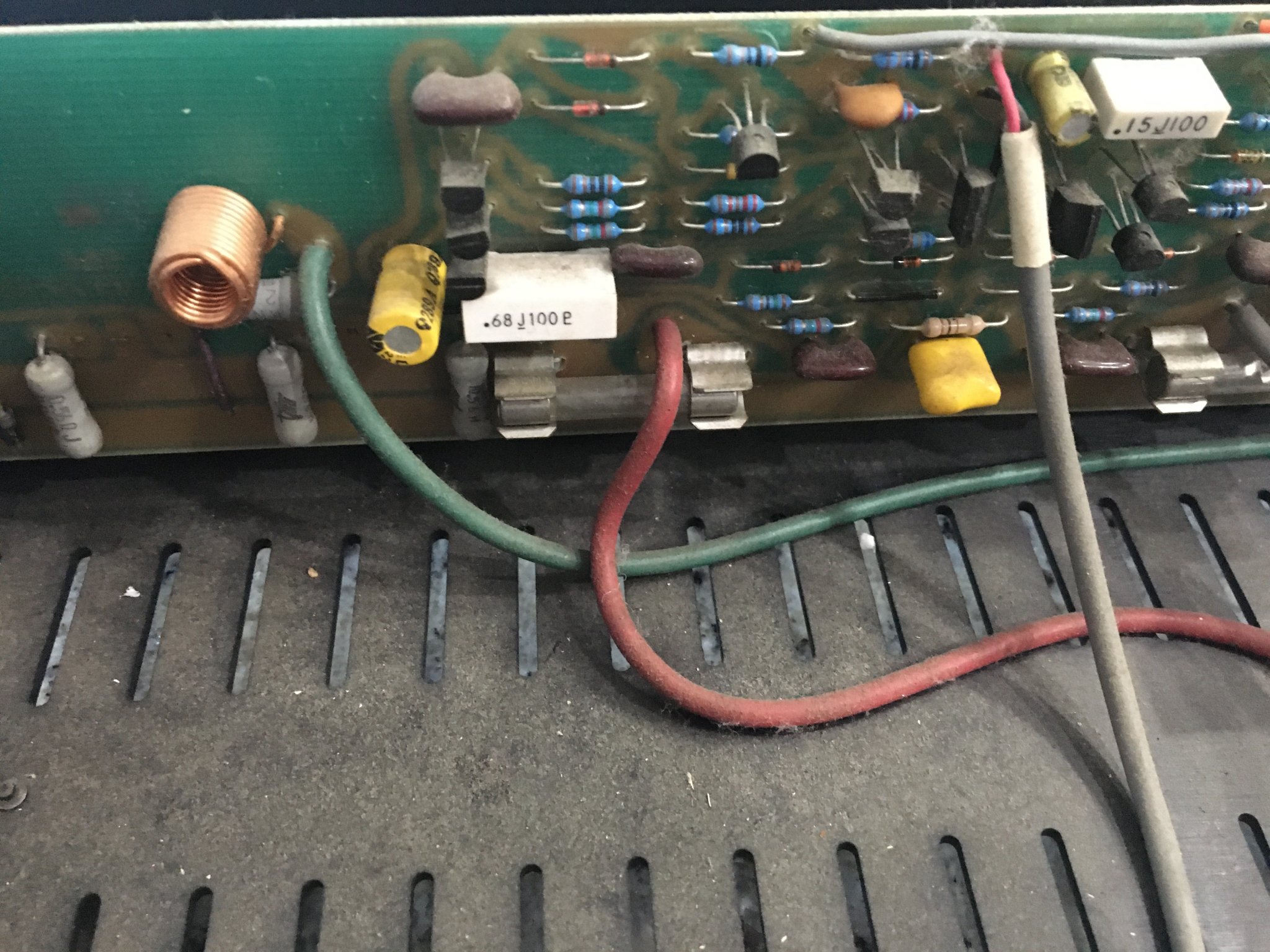

Got the amp today, sound ok I guess, very much like my old B&K ST-202 but with more bass
very well made, heavy construction in the chassis

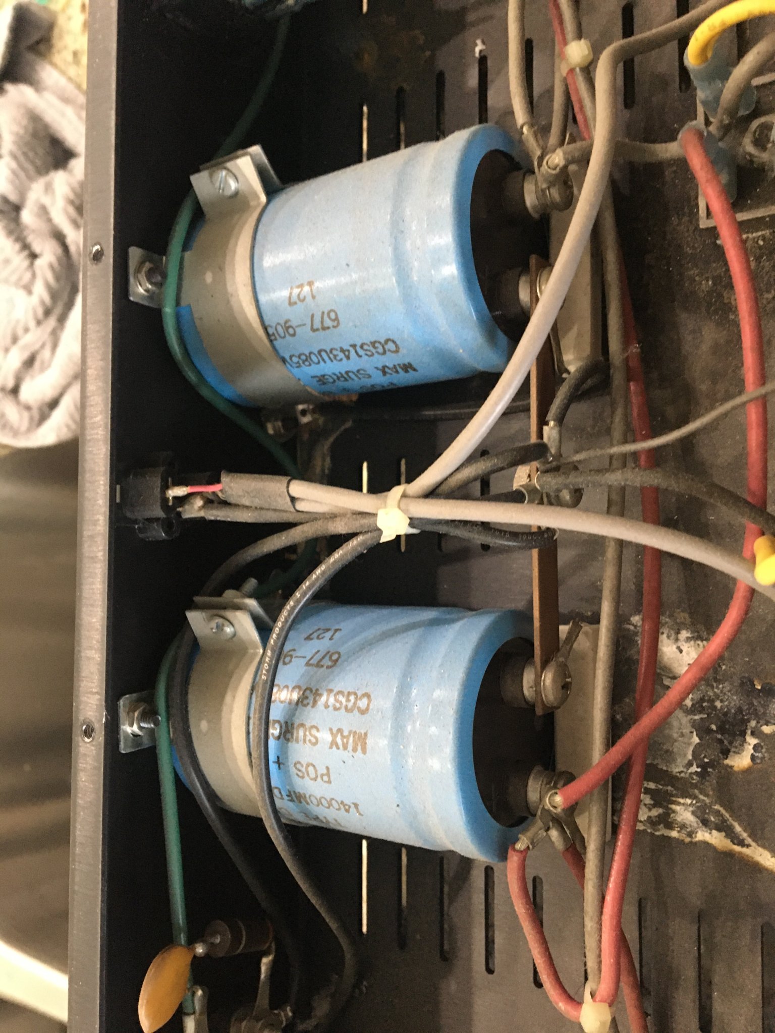

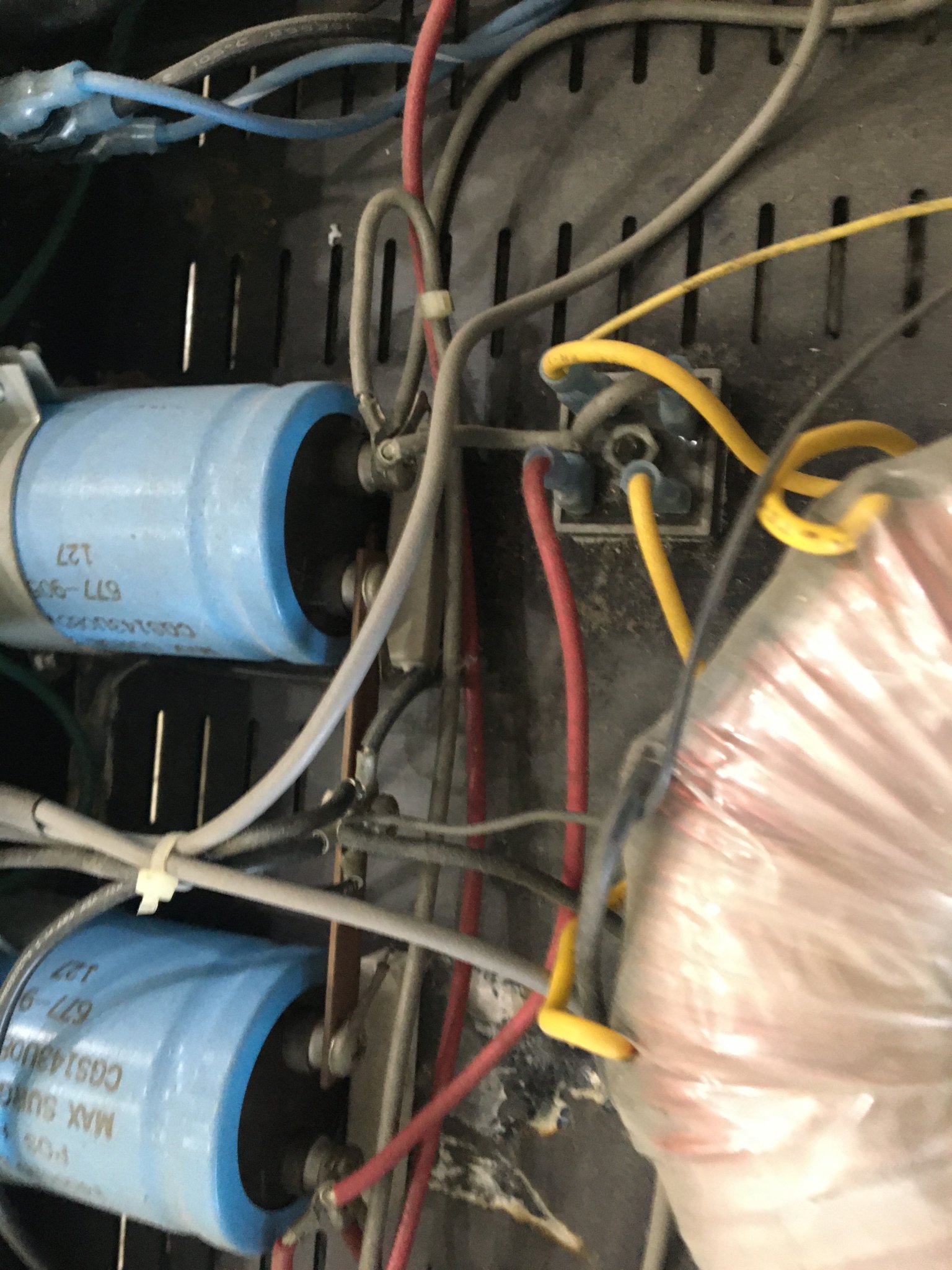

I saw a few capacitors , tried the back switch 100/200 watt, did not notice any differences, the switch in connected straight to the power supply
A lot of power, maybe way too much for my system

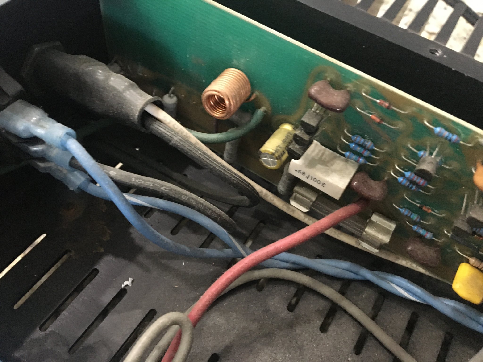

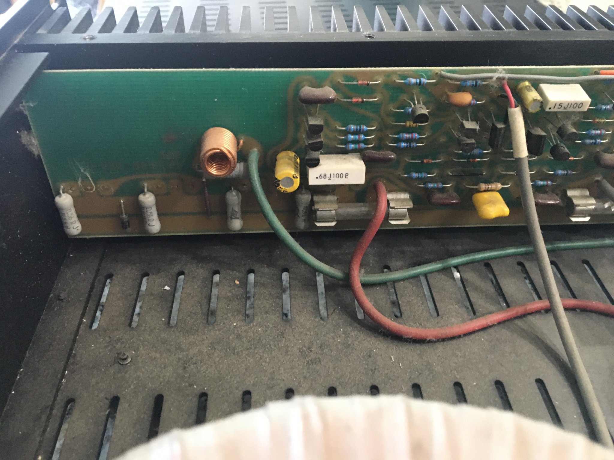

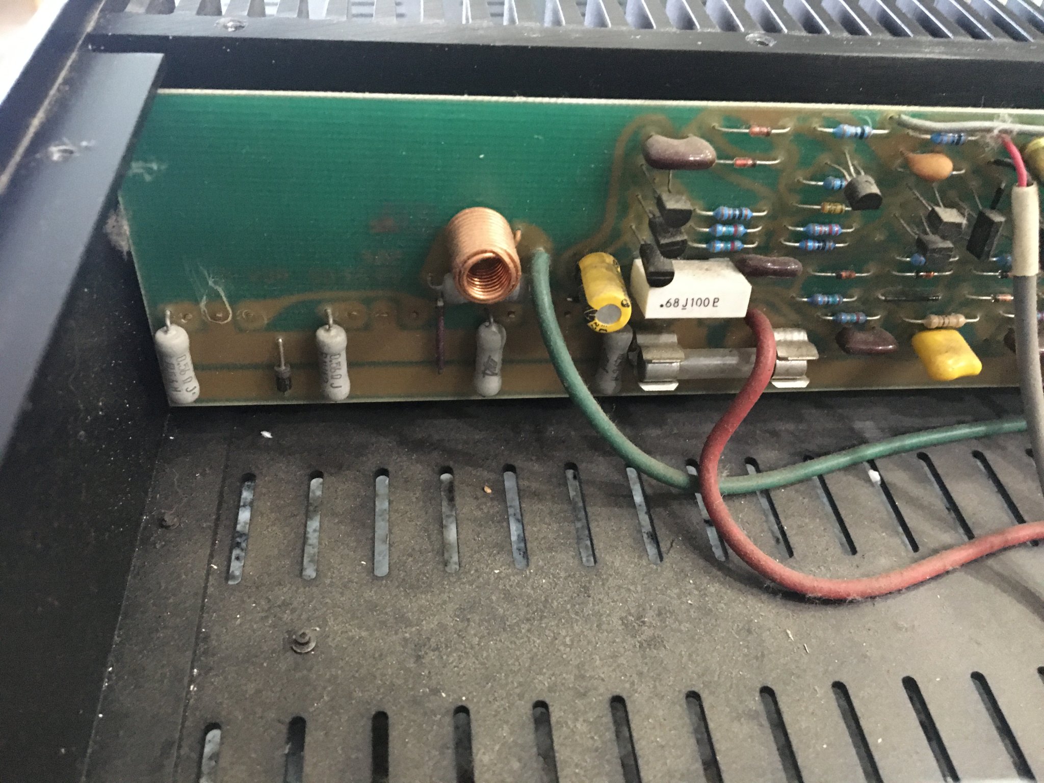

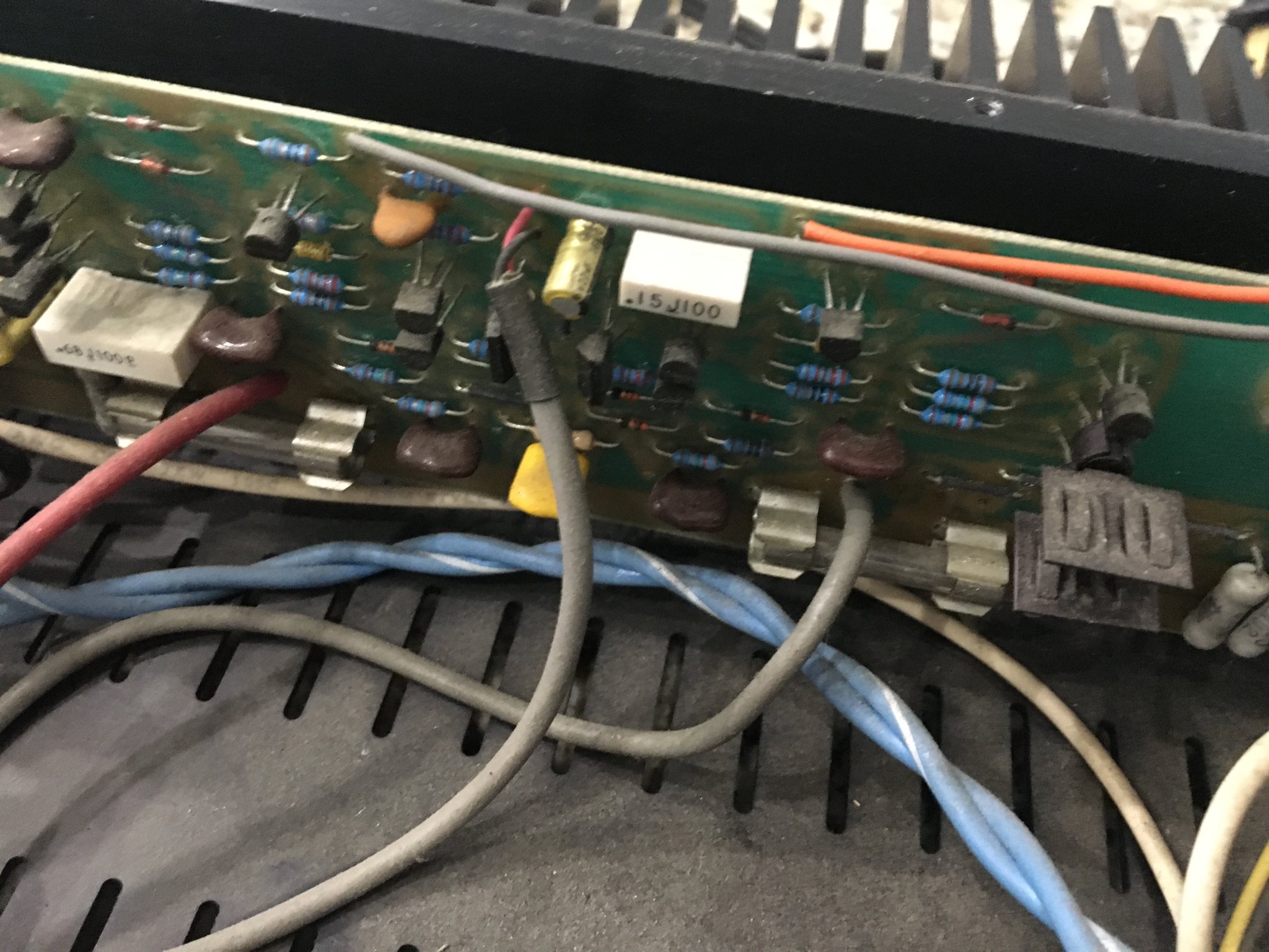

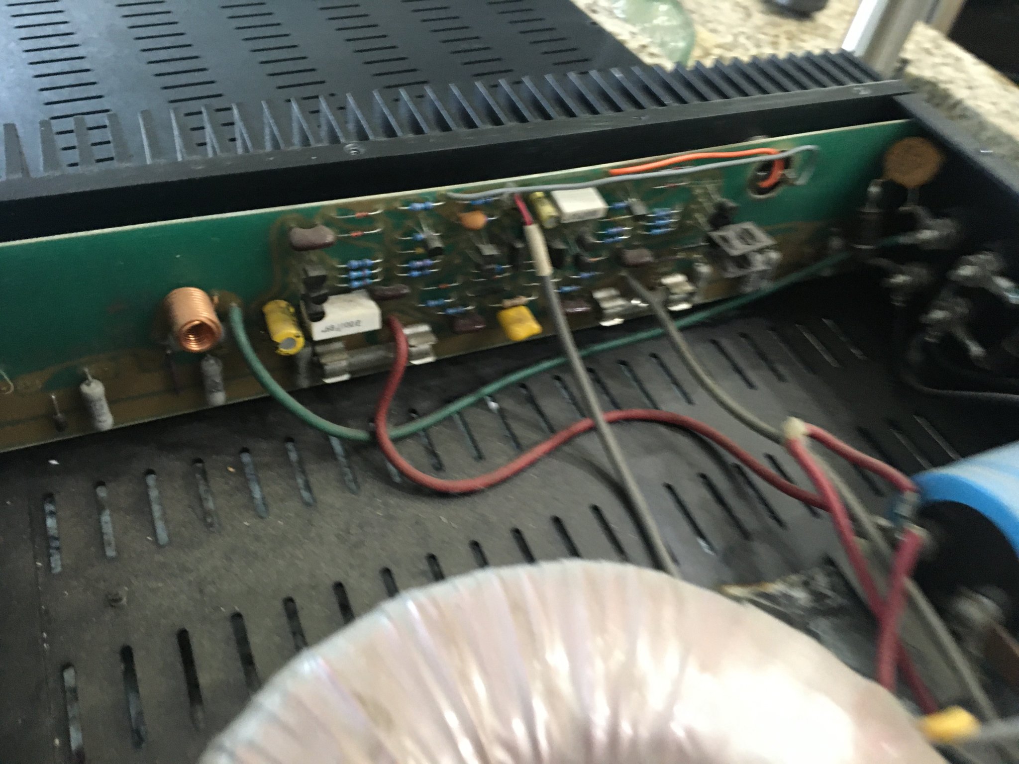

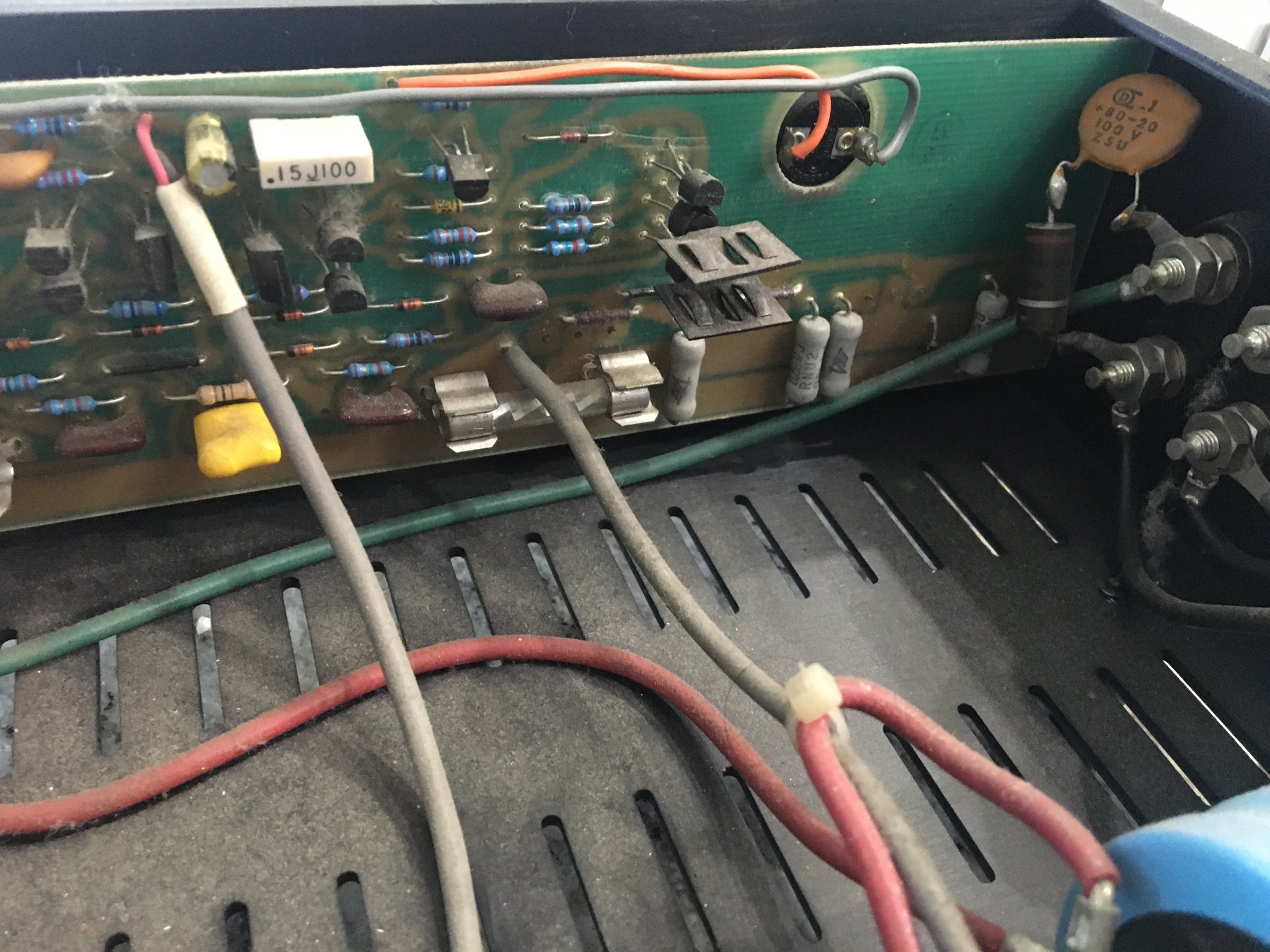

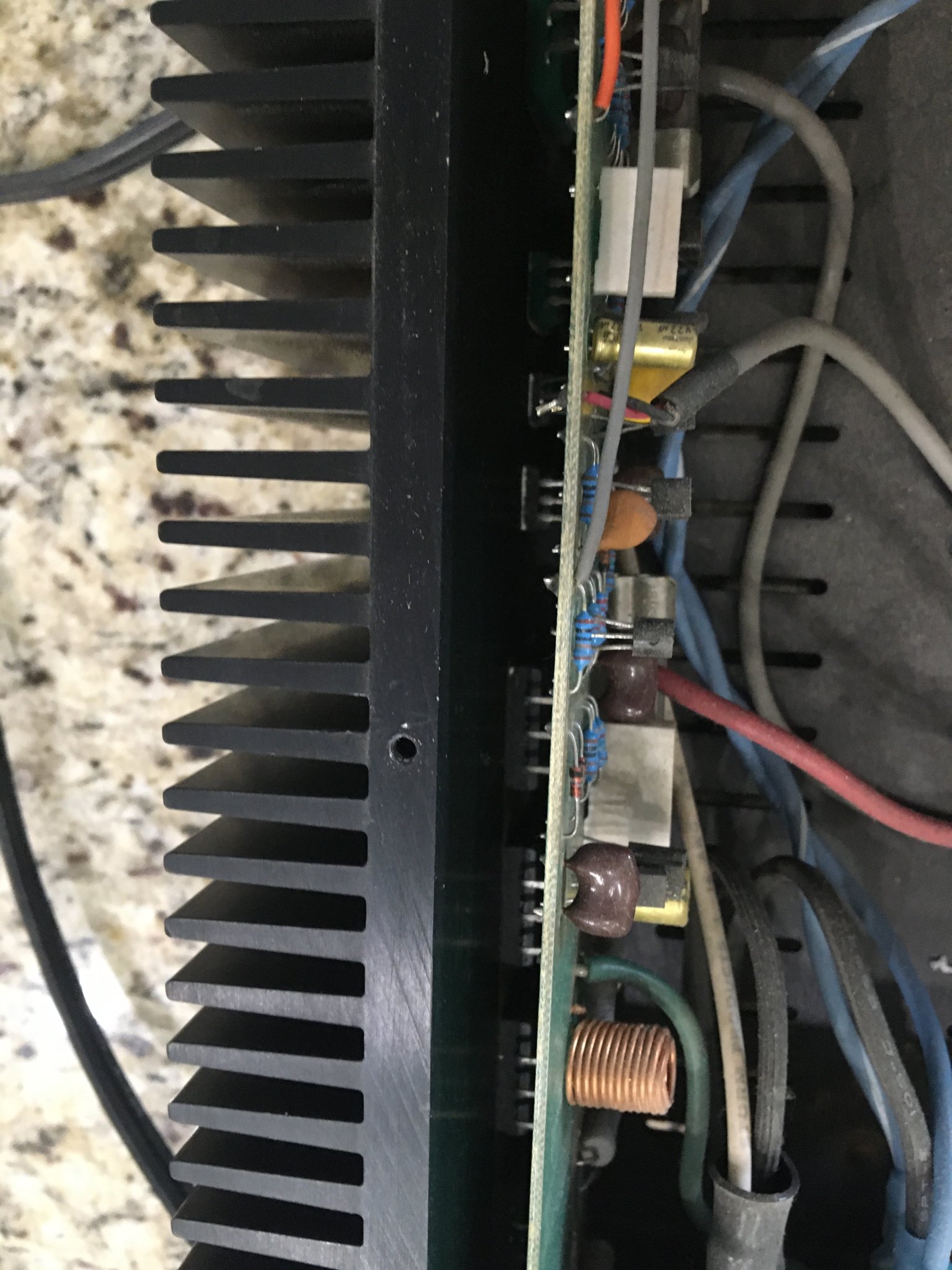

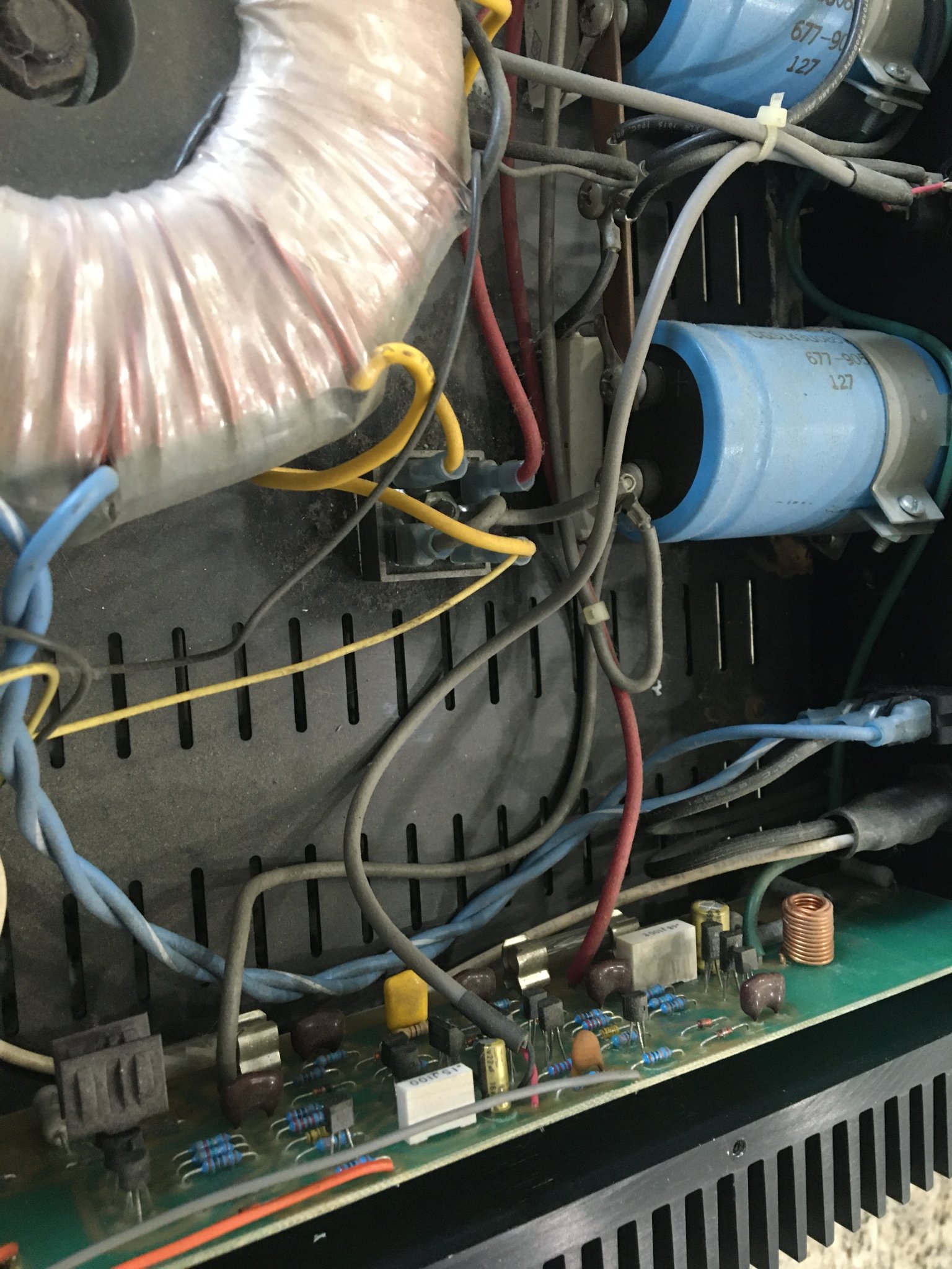

You should be able to improve the sound by replacing those dark brown capacitors with polystyrene and polypropylene film caps. Polystirens are really good up to a few nanofarads, and polypropylene film onwards... The original caps might be silvered mica caps - terrible in amplifiers... especially in AB designs with a fair amount of negative feedback. But, they might be mylar - still bad, but not as bad as silvered mica. Thanks for sharing the photos.
Do you see potential in the amp ?
what does the switch in the back do ?
No bias adjustment either ?
I have a 2300 model that I have to use as a spare. My advice would be to leave it alone if you don’t have tinkering skills.
The switch is a thermal cutout (you should be able to read the temp cutout rating on the switch.... maybe 65 deg C?)
The bias trim pot seems to be replaced by a resistor.... it shouldn't be difficult at all to replace the resistor with a trim pot.
I'd rip the guts out and put a nice 2-gain-stage, single-ended class A PCBs inside... of course, less power, but beautiful sound.. 🙂
I see the drivers and vbe in Image1512 , so it is EF2 BJT. if you could identify the 2 resistors on the vbe you could add a trimmer.

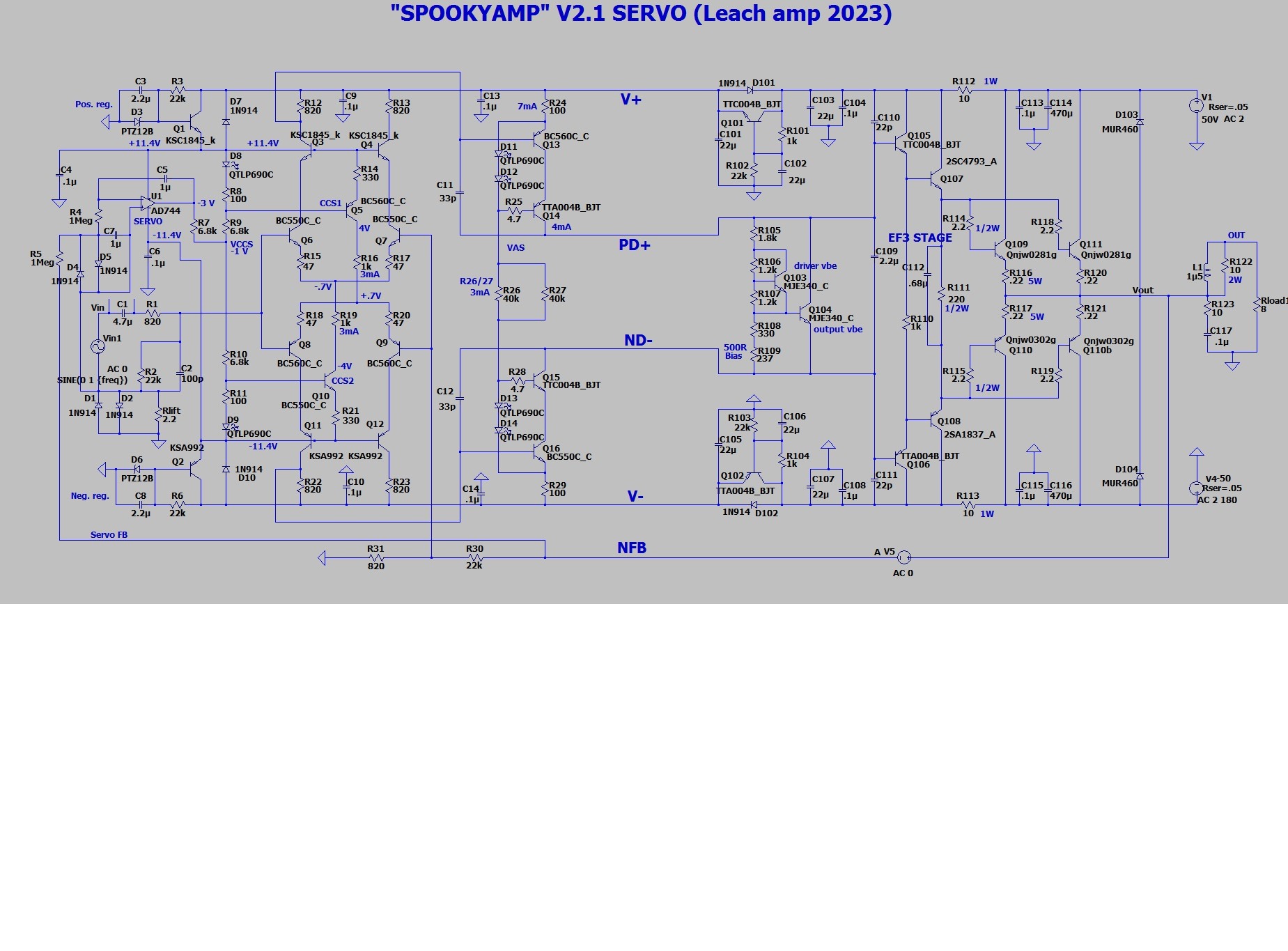

Yes , I reverse engineered your amp by looking at the board. It's design is basically what I posted. It could be "tweaked" with offset and bias trimmers.The amp is working fine, it sounds like a hafler xl-280
Should I just recapped or aim for diy audio board ?
It does not have regulated input LTP's , cascodes , "ripple eaters" or a fancy VAS. It could be an EF3.
Three things the improved version of this design does.
- 1. PSRR can be -100db+ , running off a single supply still seems like dual mono.
- 2. .002% instead of .01% 20Khz , this might not be noticeable depending on the application.
- 3. "Fancy VAS" + servo makes the circuit nearly "bombproof".

I've seen 70 year old silver mica's that still are in spec.Haha.. then keeping the silvered mica caps is a must...
according to the owner the amp was in storage for 20 years, it does look in mint condition
My idea was to send it to my regular tech for a recap with quality cap and better film caps

Here is how they should of designed it.Do you have any more mods ?
Cascodes (Q3/4/11/12) are regulated at +/- 12V. Servo (U1) also uses the 12V supplies. Q13-16 is a self clamping Hawksford VAS , can
clip all day and not blow up , LEDs D11-14 absorb the saturation current at clipping. Red led's are thermally negative to the semi's , temperature
have almost no effect on the circuit.
U1 shifts (VCCS1/2) with voltage to balance Q1-2 and Q3-4 , NO offset.
Output stage is the same as my 40 year old Harmon Kardon 680 amp with newer devices and a few tweaks.
Q101/102 are cap multipliers and make a 22uF capacitor seem like a 3000uf cap. Very clean power.
1/10th the THD (.002%/20Khz) of your amp and 30+ db more ripple rejection (-114db) than your amp. a few more parts , but worth it.
It self zero's the offset AND has a refined bias circuit WITH a trimmer to adjust it.
PS - it actually is a old design , dozens were built 8 years ago.
