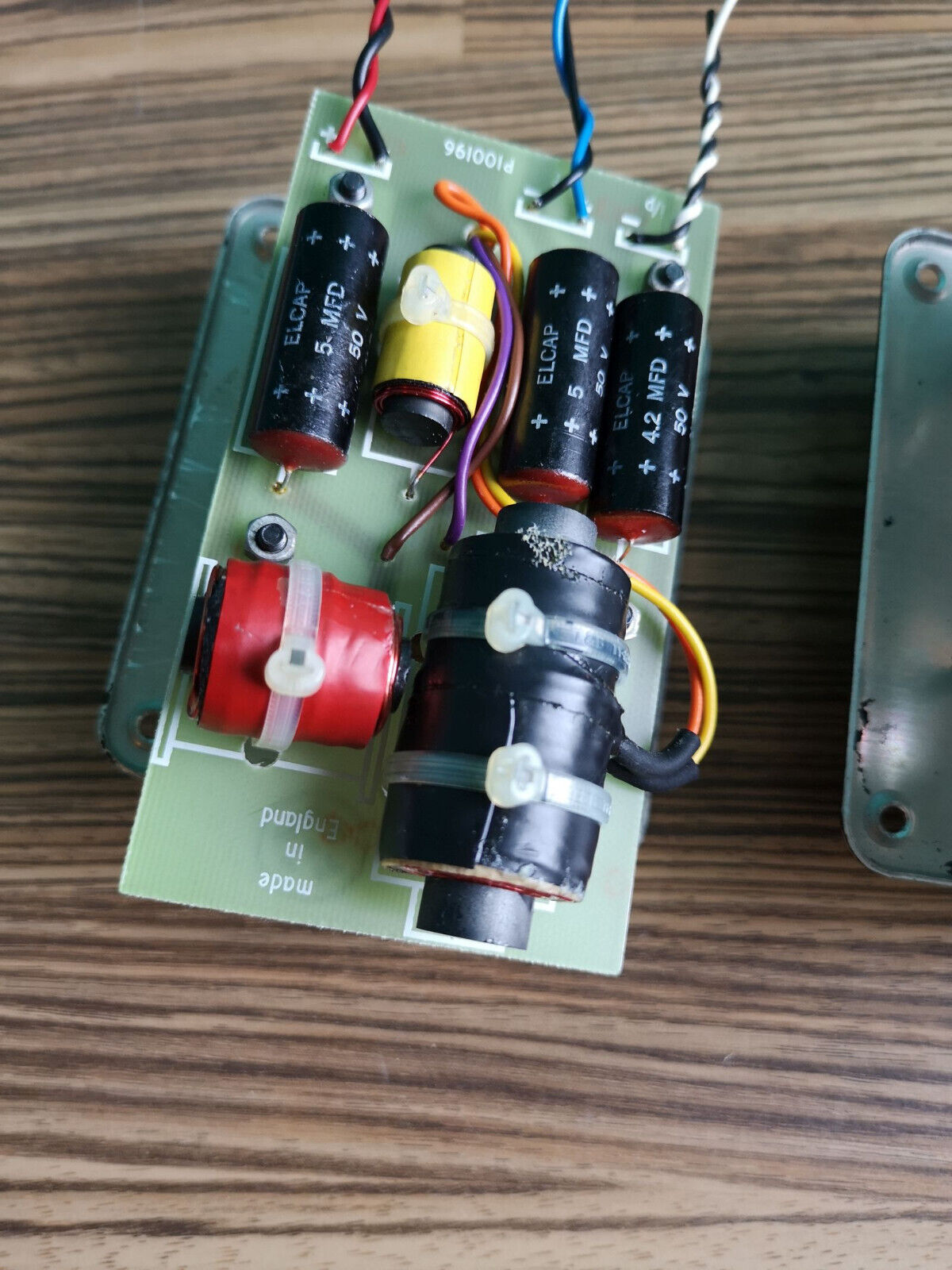

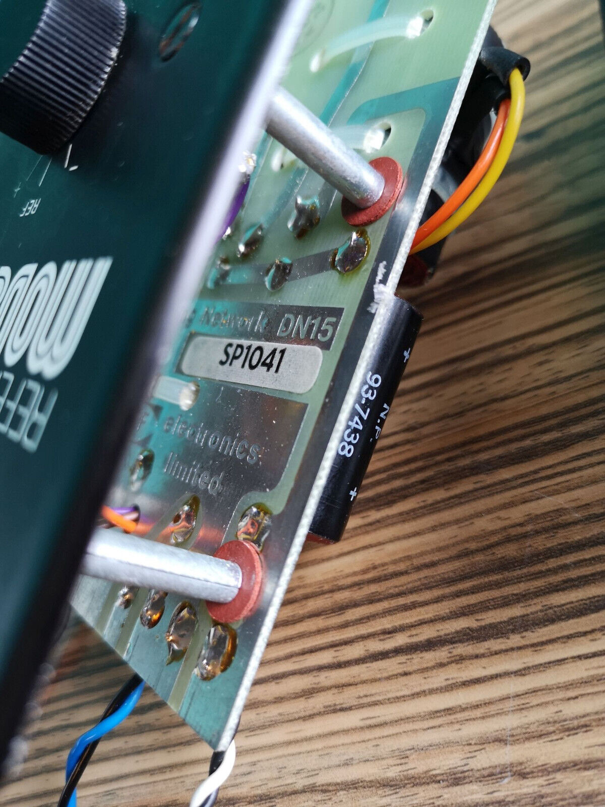

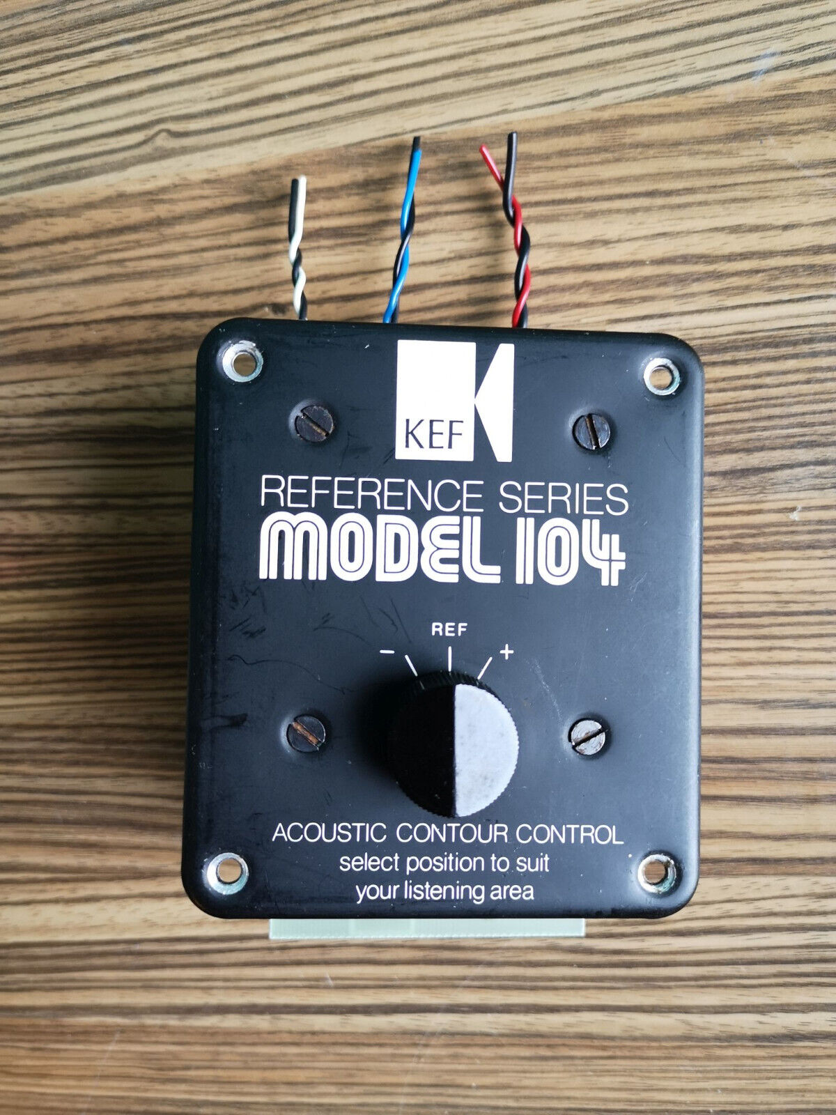

the lythic caps may need remplacement.
Yes, when the replacement driver is sorted out, we should perhaps talk about replacing the old electrolytic capacitors in the crossover.
If they are the black and red ELCAPS as shown in the attachments, they will have suffered badly from ageing and changed their capacitance value to the detriment of the performance of the loudspeaker system.

Was is MKP or MKT ? I found the same on my DM14 ! I am talking of the black, as the red I didn't see any before today, not a coil ?
Edit : I am not too worried about the bass driver, if not the original, the volume seems seen everywhere, a mess to change if ported and needs to adapt the port, but very feasible (Seas?) ?
From my point of view, this loudspeaker must be saved and refurbished as a part of a family story.
Damit, by the Qween (well the non as good baby King now) I really believed they were baby Solens' (red side black body) and I didn't change them in the B&W DM14 !
