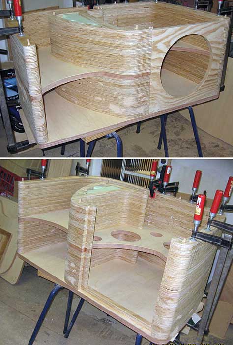

so I wasn't sure what it looked like / was.
Pretty as Andrew's stuff usually is, but i decry the significant waste of material (and, my feeling, not the best application of the panel's natural properties) to execute these kinds of designs. Certainly not "green")
dave
Not in my opinion. And it is no more accurate than a CNC panel saw (or a table saw with an on the ball operator.
Its prime purpose is to apply brute force to get swoopy shaped cabinets.
It is useful if you need an unusual shape and allows some things that might be harder to do other ways, but what you give up to get there is most often not worthwhile.
I don't know how many enquiries we have fielded on doing translam Olson-style horns with smoothed corners.... a good way to ruin the performance.
dave
ok - thanks - I just assumed that the folded horn was trying to take a smooth shape and bend it to save space.
so I thought it was logical that smooth internals would be superior to angular shapes inside.
I also assumed that before cnc, it was easier to build a series of straight lines than curves.
in reference to my accuracy comment - it wasnt restricted to the cutting - I also meant that the dowels kept the slices spot-on during construction - where the traditional method allowed the DIY'er to allow small movements.

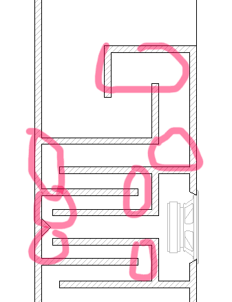

In sachiko the steps serve a purpose -- the expansion at every fold is a low pass filter which remives HF energy from getting out of the mouth.
dave
i had thought that was taking place before the mouth with all of the right angles of the expansion chambers before the mouth chamber. anyone hear both options and how much do they really help compared to the sloped option?
secondly, if it is needed and the slant wall was already installed or if one would like to cut down on overall weight, anything detrimental in constructing the stepped inner more like a staircase without each step spanning the full depth of the cabinet to the back wall?
