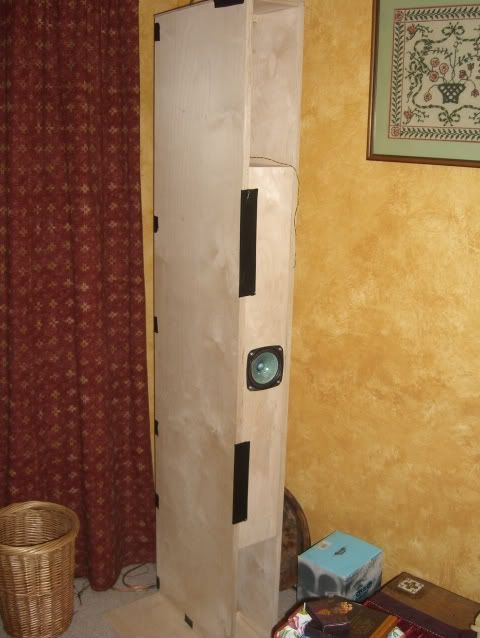

strider75 said:That internal pathway is soo cool. A shame you need to cover the other side up with ply. Maybe a piece of inch thick plexiglass??😀
😀 Good idea with the plexiglass mate, we could watch the Mice running around too if the music gets a bit boring!

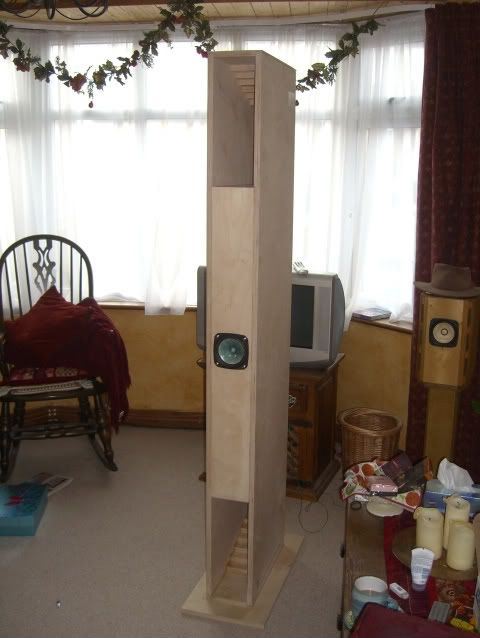

Another mega full-on day today resulted in the 2nd cab having all it's internals fitted...

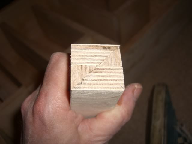

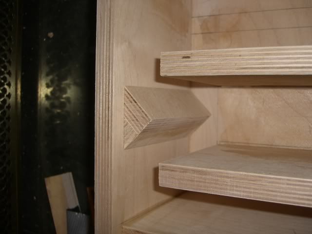

...and then I made up to 2 little triangular shaped dividers with the aid of my super-duper new belt sander...
and then stuck 'em in...
Thats another 9 hour solid day of building, love it.
Bit of wool felt fettling tommorow.

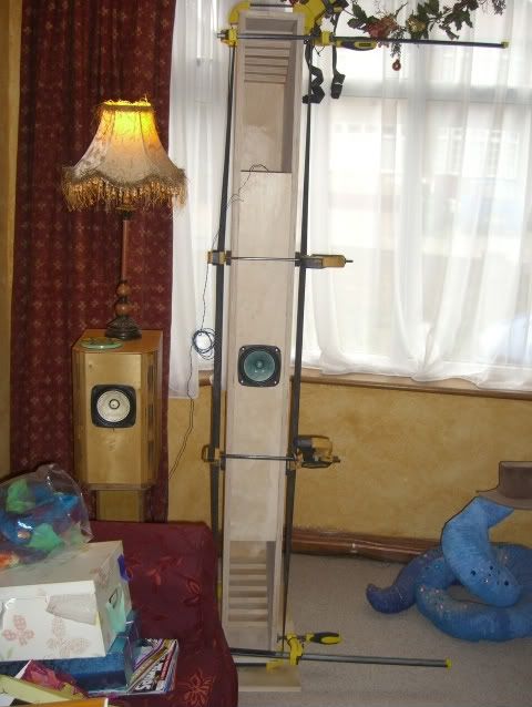

Question, on a horn enclosure like this, what's the accepted way of getting the driver cabling out of the cab?
Directly out the back behind the driver? Feed it down the port pathway then exit closer to ground level?
I'll keep the cable tucked (blob of PVA ?) into the corners obviously.

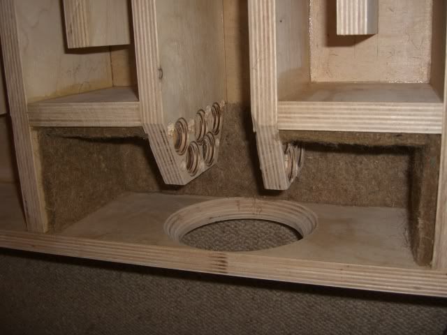

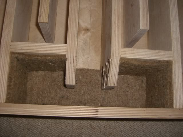

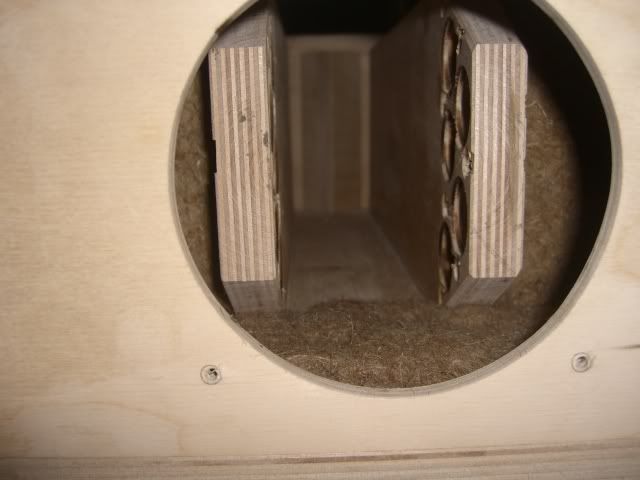

Wool felt damping. Like this OK?
...and with the driver in...
Nothings glued in yet and I've also noticed I've dampened the top AND bottom. Scott mentioned " Very little damping should be needed. Top, one side & rear of the filter chamber (not blocking the throat, obviously... ) " from an earlier posting.
If I remove the bottom-most bit should that be OK?
Sorry for all the questions, still learning here.
DTB
DTB
Should be fine as-is. You can always remove a little later if you feel it would benefit from it.
As for the wire, I personally dislike having binding posts a long way off the floor, so I'd be inclined to keep them closer to ground level, but high enough so they won't be visible at the back of the lower horn mouth.

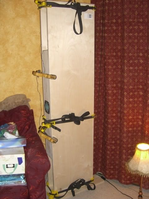

Well, curiosity got the better of me....
Oooo...VERY different sound from the Fonken's. I know it's problee bad practise but I wanted to hear what they sounded like before the final glue-up. I know the cab is probably rattling about like bonkers but up close the o/p form the horns is very dominant, move back and the whole thing harmonizes. The Mids are sooooooooooooooo springy and lively, very 'horny' on first impressions.
All the above is listening to only ONE cab clamped not glued.
I'll temp lash the other together and see how they sound together.
TBH, I'm 'concerned' the mids are overpowering, could it be the loose side-panel resonating?

Probable. There shouldn't be any midrange coming out of the horn. Note that it's a 126 as well, not a 127, with an inherently different character (it's somewhat sharper across the midband), and they are designed for a minimum listening distance of 8ft, so listening close up won't do them any favours, as you found.

I re-measured my listening position, I'm about 10ft away. I can go further back, another 23ft but I lose my sweet 'imaging' spot then, my listening triangle gets very tall but no wider IYKWIM. Our house is a weird layout, downstairs has 3 rooms all knocked through but each room has small side partition walls marking where each room boundary used to be.
I've lashed up the 2nd cab with gaffa tape (stop sniggering at the back!) and yes, the 2 of the them together sounds better. A lot better.
But summat was still 'lively'... Julie described it as 'unforgiving' and y'know what? She's right. I investigated further and found the back of the cab wasn't held properly together so I reconfigured the clamping arrangement. Lo and behold, a lot less honk. The 6ft side of one of the cab's has a slight warp in it, I can pull it straight with clamps and it lines back up again just fine.
Like this the Left channel sounds very good...
...whereas the right hand (gaffa tape special!) less so.
Sticking a pair of spare clamps on the right hand side dampens the honk down, getting there.
I'm thinking of gluing one :shock:
There's summat soooooooo right about the way they play some stuff... but I'm not 100% convinced. Time (and a lot of glue and clamping force!) will tell.

They're not supposed to be forgiving. They're a high-gain design. 😉
The drivers will need some hours on them. They were sitting for a while, so you'll have spend a little while loosening them up again.
Once you've glued them up, if you still want a more damped sound, add more damping to your own taste, as we discussed a while back. That part is up to the builder as they're the only one who knows their room, system, taste etc.
Thanks for the words of wisdom again Scott.
Okey Dokey, I'll glue-em up tomorrow, then I'll run 'em in for a few days in anti-phase down the shed and see how they sound then, I must admit, towards the end of the afternoon they did sound better, I know that fo' sure as it wasn't such a leap when I went back to the Fonk's.

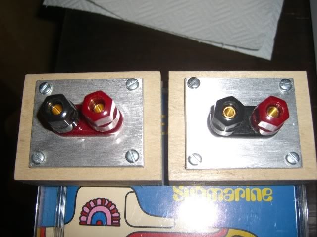

I know I'm gonna get 'points deducted' by DaveD or ChrisB fer using slot-head screws but that's all I had, I'll replace them later, honest!
Did a quick tidy-up down the shed and found I'd made 1 and 1/4 buckets of BP sawdust in 10 days...
Clamps come off tomorrow (the cab, not me) and I'll glue the terminal blocks on and solder the binding posts on.
