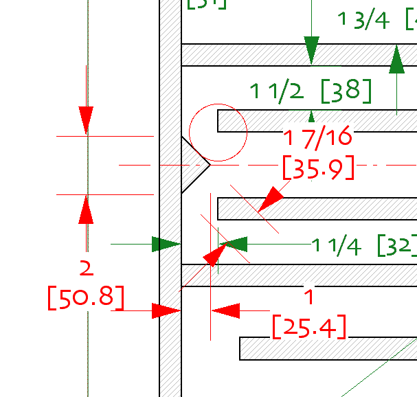

A question.
We've touched on this before but I'm a trifle confused... it's concerning the little triangular-profiled piece that sits on the back panel directly behind the driver, looks to be some sort of divider to send sounds into both horn sections.
Well, the plans make it look to be a 90 degree piece but no dimensions are given, Scott mentioned a wedge shaped piece 1 1/2" high x 1 1/2" wide but when I draw that out on a piece of paper it looks different, odd.
Can anyone confirm what I'm to do here, I'm stuck😕

so kids, sing along with the bass player "the square of the hypotenuse of a right triangle..."
if cut from a piece of solid, the long side of the deflector should be approx 2 1/8" ( 53.88mm).
probably a lot easier to just rip some strips at 1.5" / 45` both edges, glue up with a masking tape "clamp", and cut to length afterwards - IIRC that's what I did on the Aiko cabinets
Dave the bass said:We've touched on this before but I'm a trifle confused... it's concerning the little triangular-profiled piece that sits on the back panel directly behind the driver, looks to be some sort of divider to send sounds into both horn sections.
Exactly.
In the Changs either will do. Even just a piece of wood glued egde on.
In the nagaoka horns, the size and shape are more critical as the passage size wants to reain about the same.
Detail attached.

Yeah, I saw on another build instructions on the Frugelhorn site that in one cab (Olivia?) that the triangular bit was there to stop port-to-port interference. Saburo is a Nagaoka horn I'm guessing ( sorry i don't know the history of these) so I'll build as per the detail picture you've attached.
Thanks for that picture Dave, really appreciate all the help here Gents, thank you.
