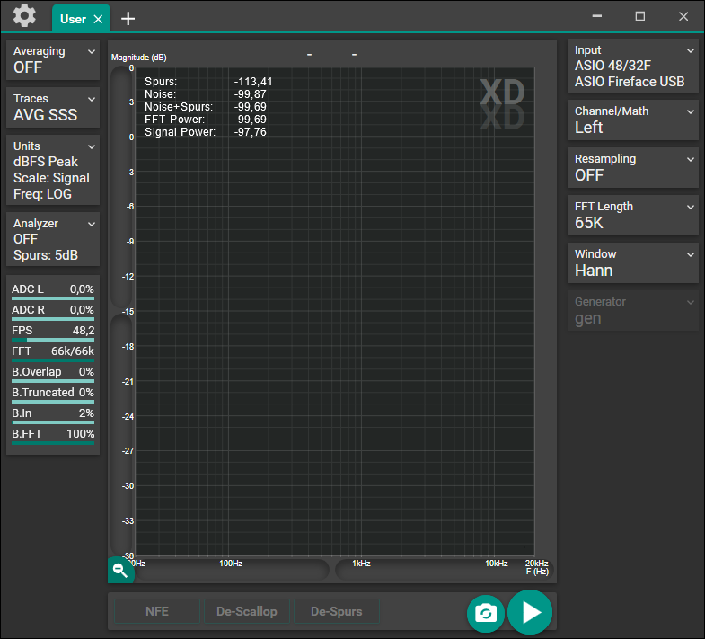

I am happy to try your software, but no data is displayed - no matter what option are used. Even the dummy-data is not displayed...
Any ideas?
Any ideas?

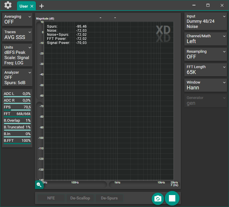

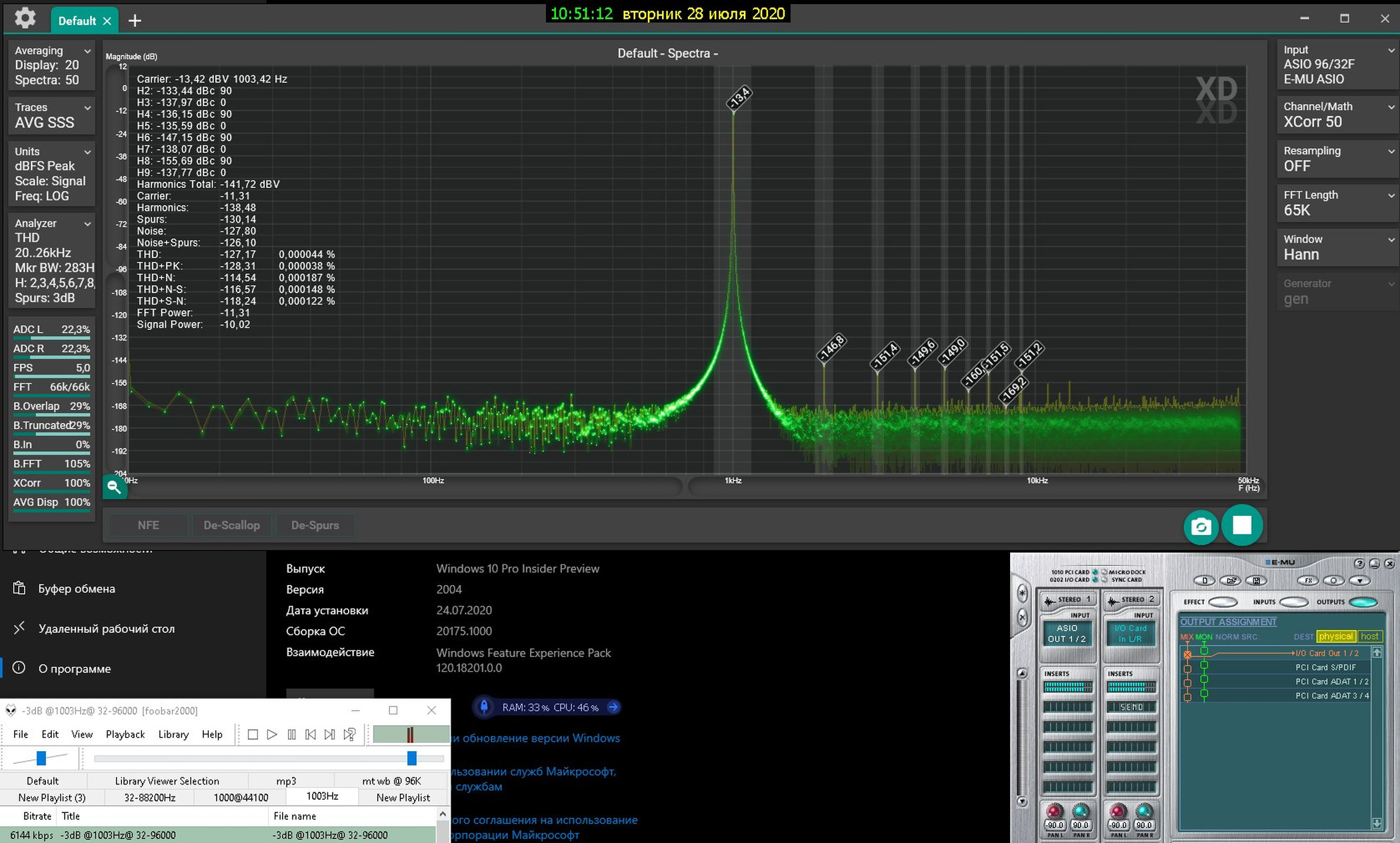

Hello, attached are two screenshots. One with physical soundcard and ASIO, the second with virtual dummy data.
I have a Win10pro 64bit machine with intel Xenon E3-1230v3 CPU. Windows version: 1903, Windows build:18362.959
Hope that helps. I am happy to deliver more Info and do more testing, if needed.

Whew, it works (just has no traces to draw, in "traces" section there is a pink gear icon which opens a window where you could add traces/markers and set their shape/color/style/where to draw them (overlay/phisphor)
you need to click on "+" in the tabs bar and select one of the presets, they come with preconfigured trace styles.
It's weird you've got "User" preset currently displayed - have you made it yourself?
In latest version there is "Default" preset that pops every time you close all of the presets and then restart the program. (or start it the first time)
"whew" came from relief it's not direct-x related, as it's almost unfixable 🙂

Well, I figured it out myself in the meantime.... hitting the "plus" on the upper left in order to configure a new spectrum analyzer window gave the initially expected result.

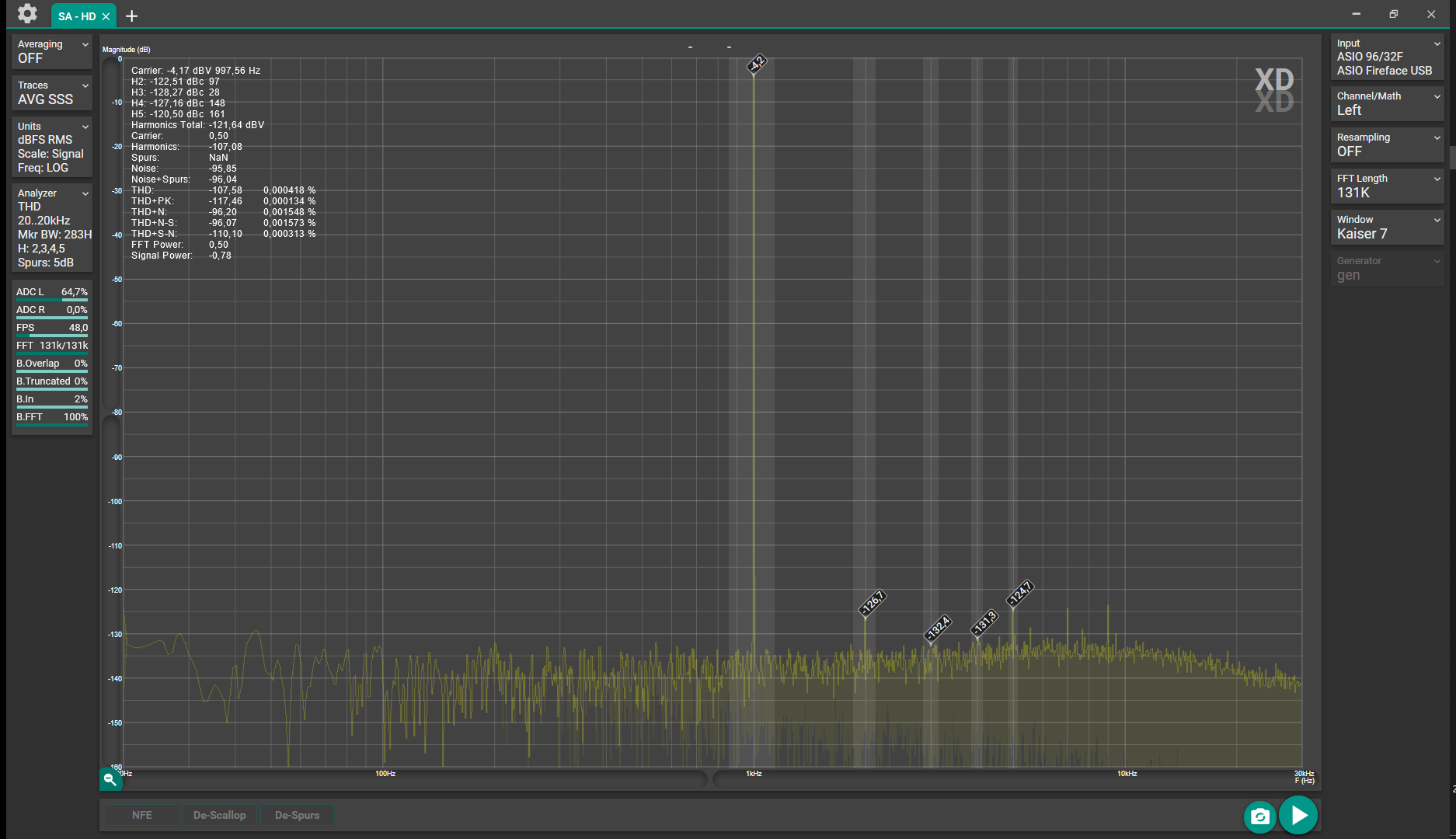

Attached another screen, with one soundcard feeding the other...
I must admit, I really like it on the first look. Tons of options, I am still exploring them all 🙂

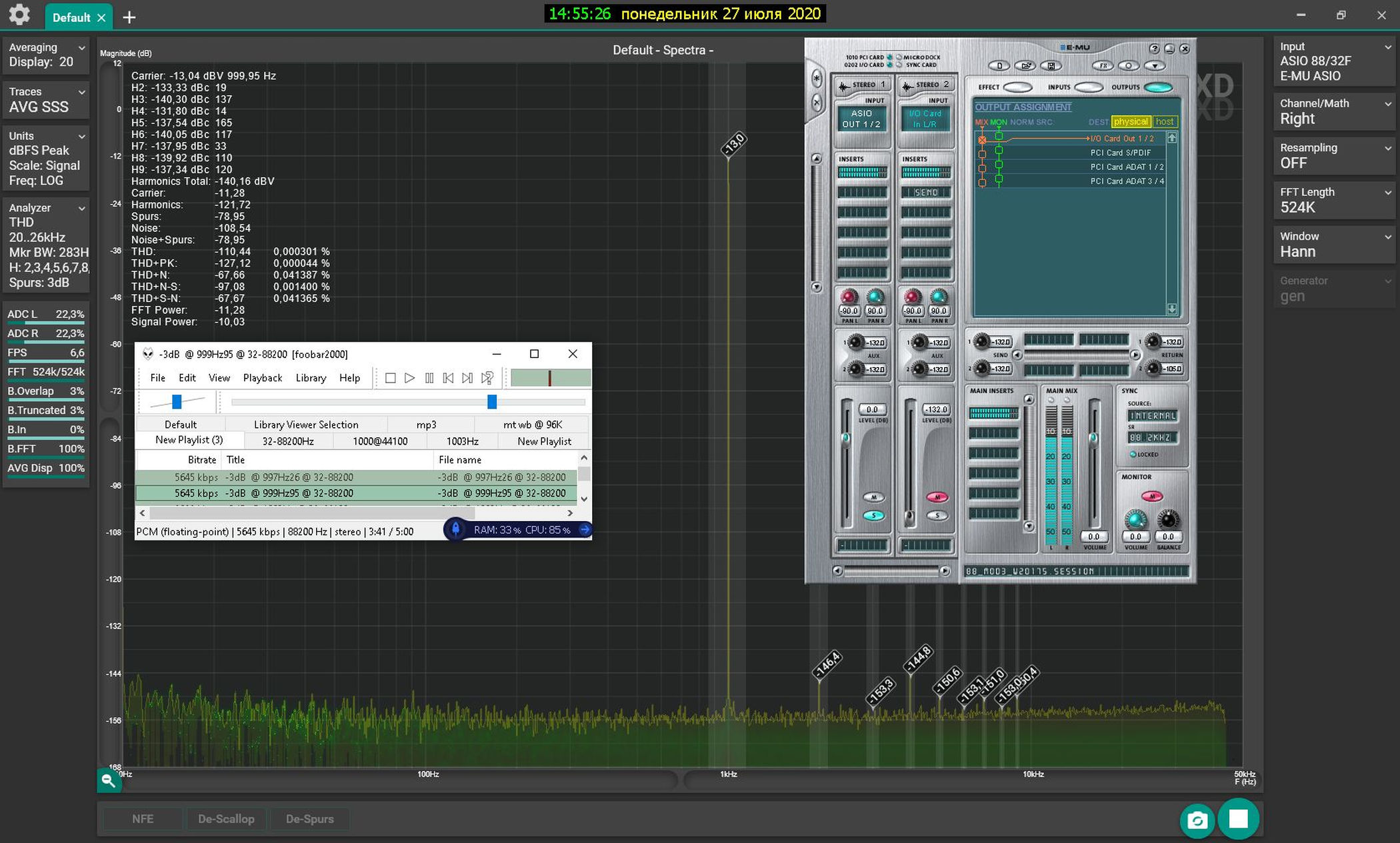

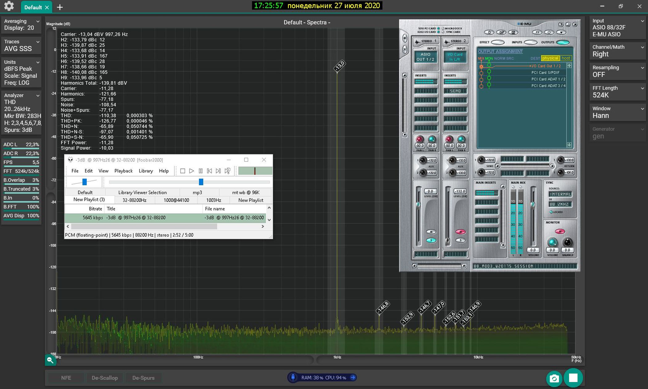

Well, if the first tests were successful, that's a good sign. 🙂 👍

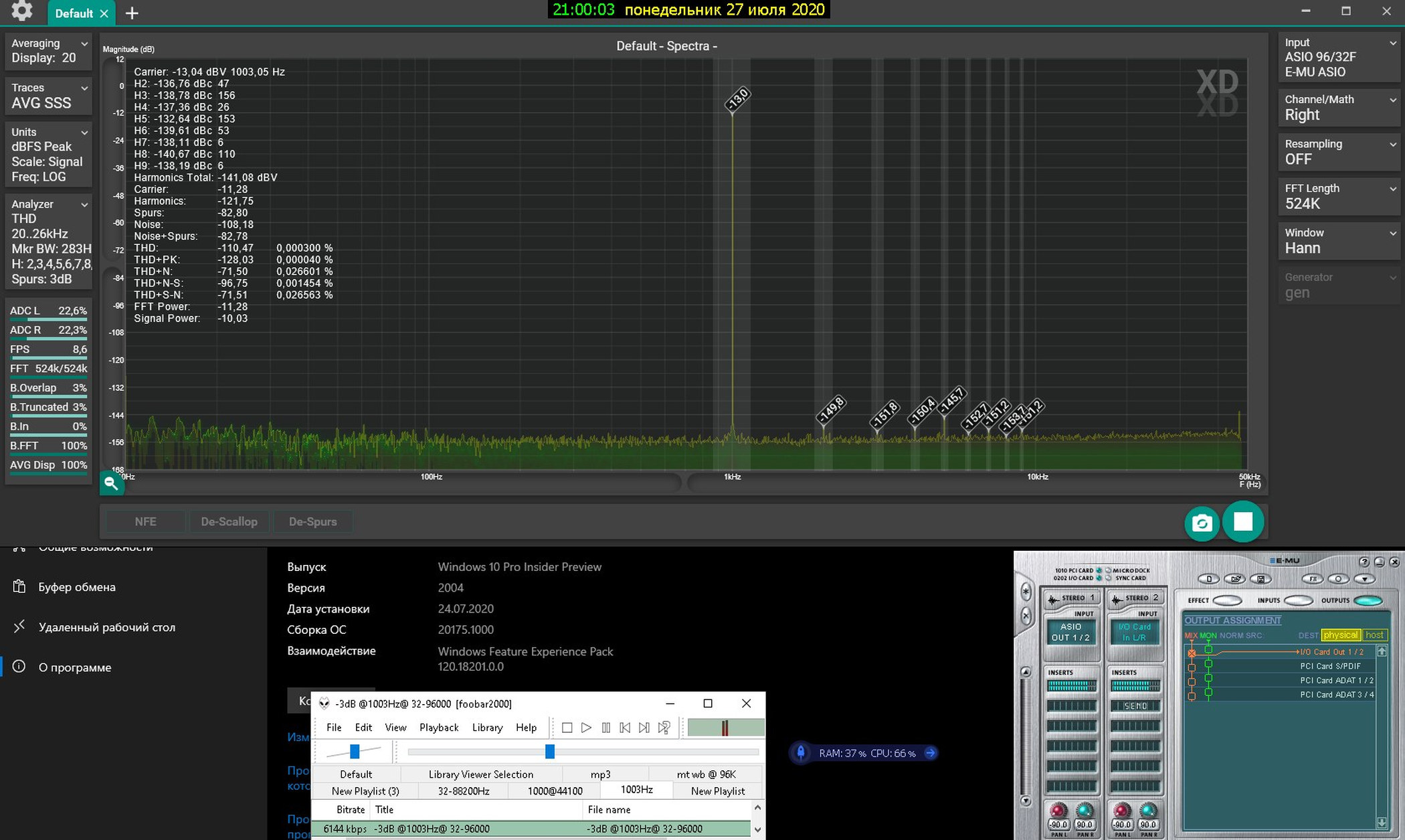

Nice numbers! You are very close to noise floor.
Try sync averaging to reduce noise, start with shorter FFTs (64k? 0.5M might feel a bit slow).
+ try out noise floor extension at "measurements" along with ~50-100 display averaging, it should calculate the level of harmonics in more precise way.
If you have 2 input tchannels connected to the same source, you can reduce your ADC noice by flipping x-correlation feature in "math" menu. It eliminates signals which are different in L and R channels.
Another way to reduce noise is to go "coherent sampling" + disabling FFT window.
It's in "Resampling > PLL". Not a lot of noise reduced, but it's great for drifting analog generators which loose peak carrier magnitude at long FFTs.

Sweet! 16dB lower noise floor vs. 0.5M FFT.
Another 9dB could be squeezed by switching back to 0.5M FFT vs current 64k, then it would be 25dB lower than typical FFT analyzer running at 64k.
Synchronous averaging is sloooow at long FFTs for some reason, i need to investigate/fix it. I guess it skips way too much samples to sync on the signal (like 1/2 of FFT length, which translates into 5 seconds at 96kHz sampling rate). + CPU load... Gotta limit sync window length.

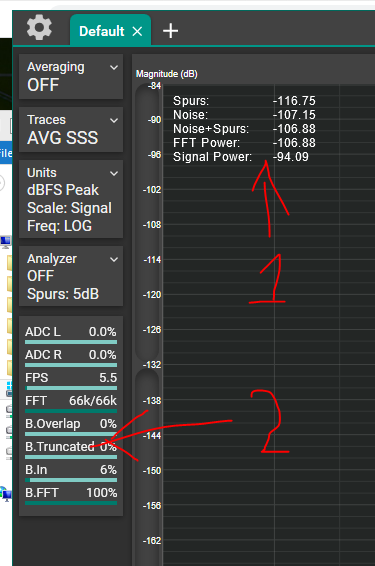

I quite like your development and decided to make at test with the current version from your website.
I first played a little with the Dummy source, and it worked correctly.
Unfortunately, I couldn't get SA to run with my MOTU Audio Express external audio interface. I opened a new Spectrum Analyzer tab in SA, the ASIO driver was configured for 24bit/48kHz/F32, but upon pressing the Run button, there was no spectrum on the display.
After this exercise, nothing appears on the screen even if I use the Dummy source. The latter works again when I close SA, delete the Default.xml file, and then restart SA.
My computer is a Win7 Pro, 64bit, with all updates installed, the processor is i5.
I have no problems with the MOTU card with the same ASIO driver with a couple of other programs (DiAna, REW, Spectrum Lab).
I'll be glad to furnish additional information if required.

Do you get the #1 and/or #2 numbers as in this post with ASIO?
SA01 Spectrum Analyzer software - development in progess...
Have you tried other input methods (WASAPI/MME)?
