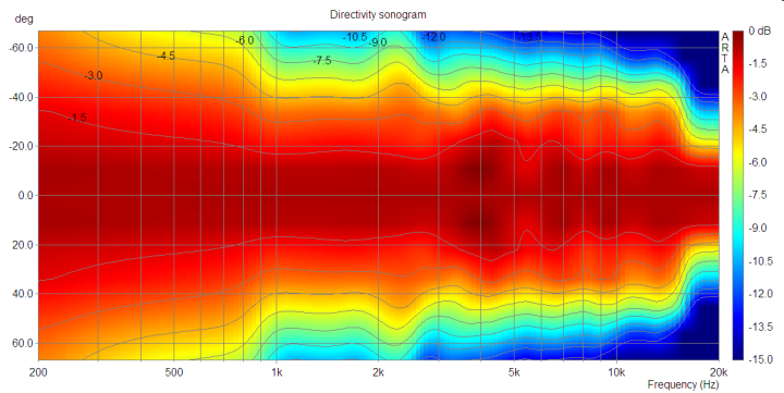

Thanks to Gainphile for the impulse data. Normalised wavelet responses this time 😀 For better comparison! 🙂
Here was wavelet plots for the dipole: http://www.diyaudio.com/forums/multi-way/178806-s16-constant-directivity-dipoles-2.html#post2418709
Again dipole responses normalised for left and right speakers:
Now for the CD speakers, left and right!
I still think the top end above 2-3kHz room reflections are lacking. Comparing to the polar plots (see below quote for CD speaker and above link for dipole), polar plot does not predict lacking signal! Room must eat it! 😀 Due to normalisation of the plots frequency response effects do not play a role here.
Let's see room response for a 150ms period, for dipole and for CD:
Top end reflections rappidly disappear.
Secondly we see dipole works best in the lower midrange compared to box speaker, can see faster decay below about 500Hz.
For 300ms window, dipole and CD:
Again frequency dependent decay of the room reflections.
Seems to be no matter how constant is the directivity the room will dominate the time-frequency pattern !
Instead of constant directivity, maybe the speaker directivity should be invert of room response decay? That turns out widening dispersion with frequency. Not many does that however! Obviously it's not easy, it goes all against the convenient physics of radiation principle. Anyhow the idea is interesting, don't you think so? 😀
edit: And all of these are measured at the listening position, which was about 2.8 m according to Gainphile.

I have since incorporated the waveguides to my dipoles with somewhat success.
I pulled out my fingers and built these.
Muuuch better 🙂
Agree with your conclusions - despite the tweeter range, room seem to dominate.
The horn of the CD seems to be better than the WG of the dipole (faster decay) - possibly less refections from the front wall is mixing in here too (good to see in the short period plots).
