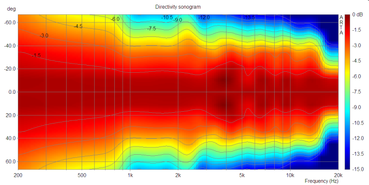

MEASUREMENT
I encountered dramas with the measurement. My turntable is too small for the speakers (designed for flat dipole baffles). I could not rotate the speakers on its acoustic axis so take this with a grain of salt. I also had to normalise to 0deg. btw. it was unstable enough to fall and smash my window.
IMPRESSIONS
I'm in an early stages of understanding these types of speakers. But they are very positive. Let me address my intial skepticm with box speakers first:
