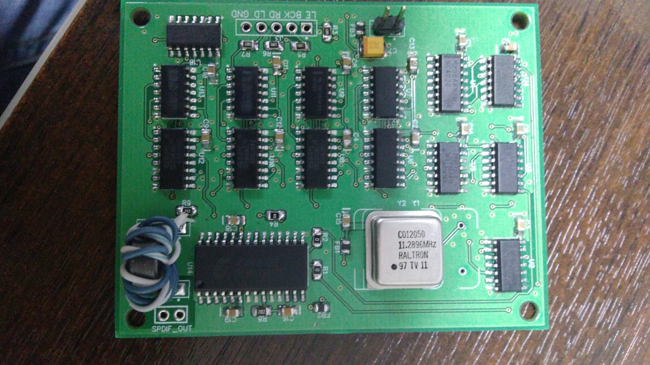

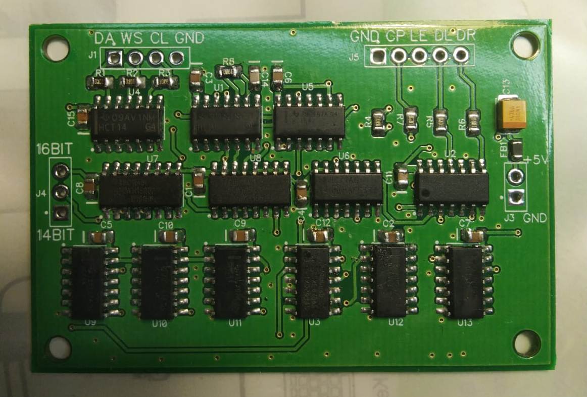

On the logic chips 74 series I developed:
1) Simultaneous(LE, BCK, RD, LD) to S/PDIF out converter, see the attached photo
2) I2S to Simultaneous converter for connecting two TDA1540 to any I2S source

HI AnJu
Great
Culd You please post photo of the
Great
I2S to Simultaneous(TDA1540 14bit or TDA1541 16bit DAC) converter:

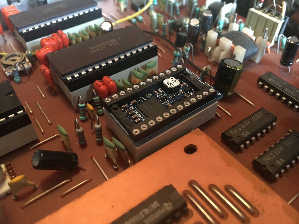

I visited your homepage thinking I could order your "chip", the one that makes it possible to get SPdif out from my CD104 player. There seem to be no "purchase" button for this mod?
Are you selling this stuff, or just teasing us "not so clever" listeners out here?

Hi.
Thanks in advance, and happy cristmas days to come.
Regards Steen

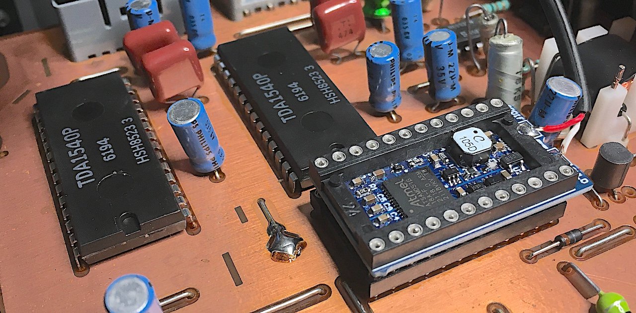

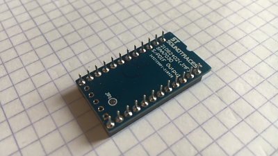

Hi , it's a board designed by soundtraces
https://soundtraces.nl/
Regards Bram
Won't do you much good. No I2S in a CD104. It is all simultaneous data. Which is why the TDA1541A is an easy fit.P.S.: are there a schematic diagram from the unit in post #90 (this seems to be a solution only with TTL/CMOS stuff without programmable MCU) ?
I ask there via email and receive this reply:
You can order these modules directly with me through email. They cost 69 euros plus shipping.
If you send me your shipping address, I can make an invoice for it.
Best regards, Jeroen Fortanier
