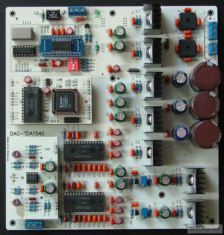

Hello , i have old marantz cd54 with tda1540 dacs. Is this board suficcient for
processing into DAC?
