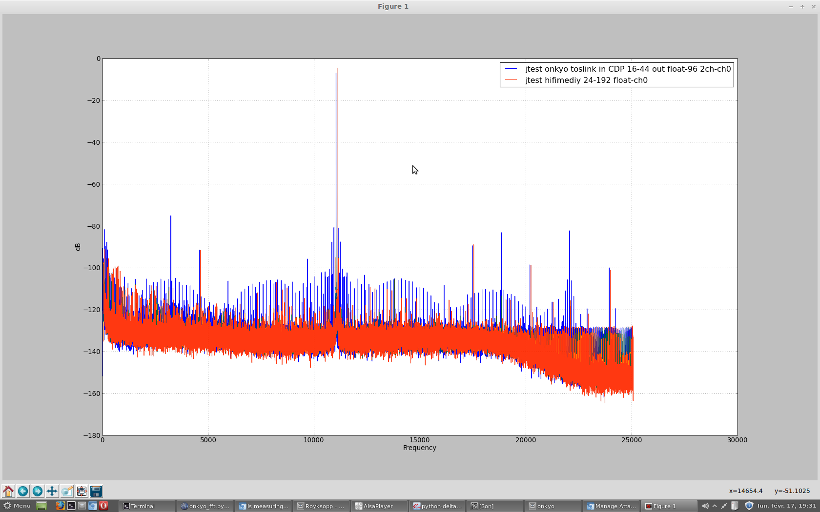

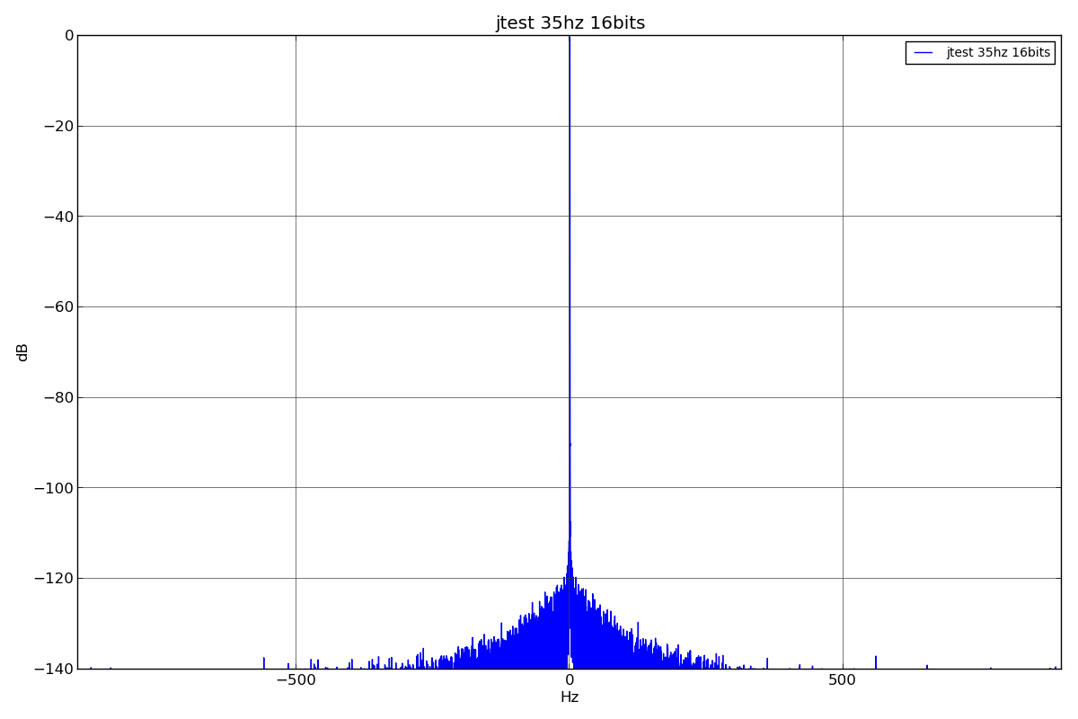

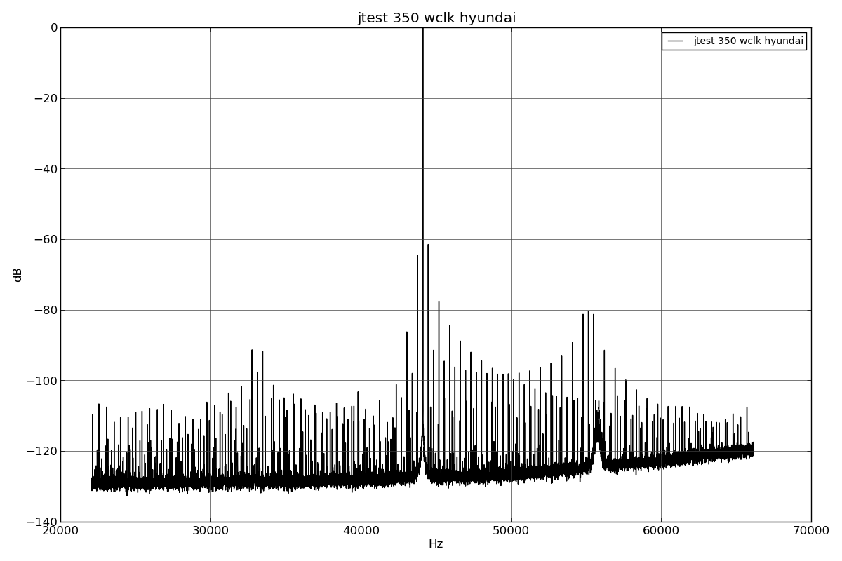

See attached files : one is a €2000 HT receiver from a famous japanese brand ; the other is a cheap WM9905+ES9023 I put together. Both play SPDIF over TOSLINK from a €29.99 HYUNDAI CD-DVD-MP3 player. This player is a true piece of junk, the power supply is so wimpy the display dims when it seeks and its output jitter is truly humogous. A perfect source for this test. One graph is full range, the other one centered on the test frequency, sorry about that...
...and the last one is WCLK coming out of WM8805 with a nice implementation mistake on my part 😀
Brownie points if you figure which is which without looking at the plot legend.
I noted an unusual J-Test frequency of 35Hz. Aren't those usually performed at 1/4Fs?
