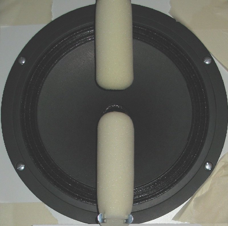

One method I use to limit HF beaming with a FR driver, is to mount a finger of foam from below, as close to the driver as is possible and until it covers up approximately half of the dust cap or phase plug. Sometimes two fingers of foam work better from opposite directions.
I obtain this foam by soaking 4" foam rollers in boiling water until their internal adhesive goes soft, and then work the foam off the roller shaft whilst wearing heat insulating gloves.
This foam disperses a portion of the cone focussed HF beam thus reducing axial HF and improving the radiation pattern. It also assists in suppressing the main cone diameter related peak, circa 3>4kHz with an 8" driver.
I must comment that these 'fingers' look odd and somewhat phallic, but they DO work !
Cheers ......... Graham.

Dear Graham, would you mind posting a photo or a diagram?
If I understood correctly, and "inverted phase plug" should work...

Hi M.
This is the only photo I have at the moment - helping out on a test baffle with the rising charactersistic of a B200.
Not easy to tell from the photo, but the 'foam fingers' are angled inwards.
This method helps counter driver shape related dynamically induced air side resonances, ie. circular cone, and would apply for front radiation no matter what type of baffle, waveguide or horn a wide range driver is mounted upon.
Cheers ....... Graham.
PS. The replacement centre dome on this driver is glued to the voice coil former, not to the cone as is supplied by Visaton.

Thank you, Graham. I have missunderstood your description.

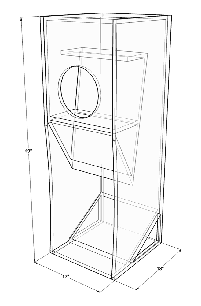

cut sheet errata for EZ10??
looking at the cut sheet: https://app.box.com/shared/fbnx0ij28k referenced from https://spqracoustics.wordpress.com/
is the cut sheet ok?
mainly pieces B and D (i dont know about the others)
piece B = 18" - 3/4" - 3/4" = 16 1/2 " (here i'm missing 1 1/2 " cut sheet says 15" )
piece D = 18" - 3/4" = 17 1/4" but is 16 1/2" in the cut sheet
its late night here, i'm drinking whiskey and scratching my head. i can smell the plywood all over my living room and i really need to hear i can not read the blueprints, because i'm living in the lands with cursed metric measures. all i was about before i got plywood cut was rescaling from inches to millimeters. i know it's been ages. anyone... @Harderror?
i dont know if the other distances are correct
