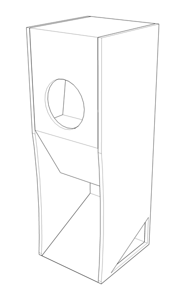

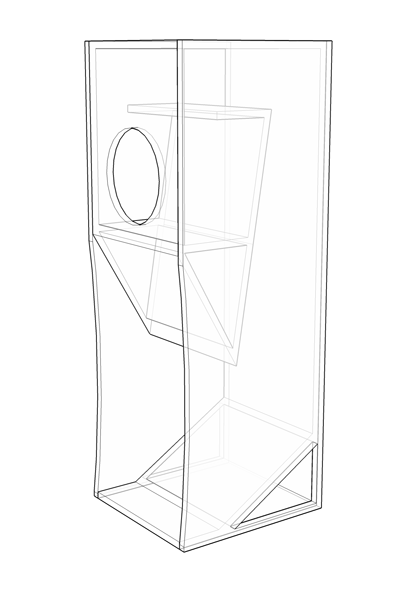

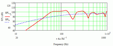

Whilst we’re here, anybody know what’s inside this box in terms of structure ?
Based solely on speculation WRT this cab's likely 'labyrinth', think downward firing Onken variant.

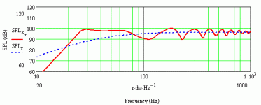

So, maybe there's more to it than I suspect beyond a bunch of damped vents, but briguy's remarks tend to reinforce my SWAG:

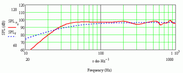

Just like a large, well damped MLTL or Onken sounds with the Altecs or similar spec drivers without/with BSC + HF by-pass, which tube variable DF tone controls does with great 'fluidity' for lack of a better phrase, compared to typical inductor, etc., BSC filters.
