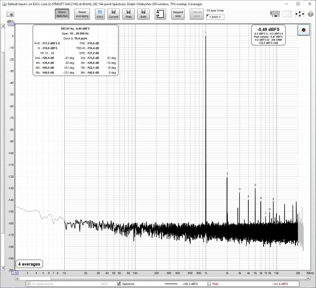

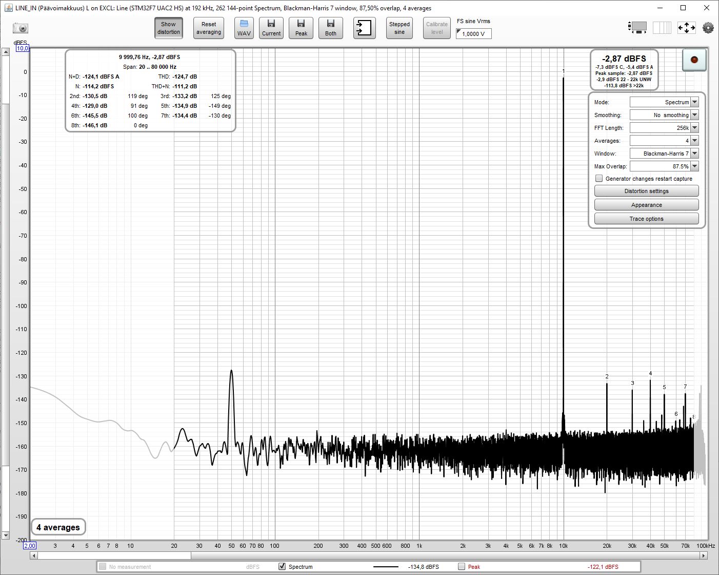

I tried to reduce 1/f and got exactly nothing changed what I could detect. FFT skirt is the same, distortions also. At the same time, 1612(1.1nV/Hz^.5) in Cosmos ADC gives a lower noise vs 1602(2.5nV/Hz^.5).
Mine is the same, about -135db but dual-mode is still worse and not only about 1k H3. BTW, I tried to sum Left+Right by simple shorting,
and get just 1db(132 vs 133db(A) worse noise than summed by beads. 9039pro seems more sensitive for shorting DACs, as I remember, the difference was 133 vs 137db(A).
If you don't see lower FFT skirts with low 1/f noise the problem may be your ADC. The same thing applies to ES9822PRO AVCC supplies (all three).
It doesn't really matter, my first problem now is a so-so performance of dual 9039q2m.. too high H11 and H13 if CLK GEAR SELECT = 0, 1 or 2 is a lot cleaner but the noise is higher too, so I have THD+N limited by the high order harmonics or by noise.
For measurement purposes even single ES9039Q2M works well as the THD compensation is channel-specific. Mono-mode may actually have worse performance depending on how well the summed channels are matched.
