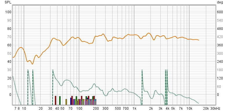

Thanks for you feedback. The dips are 1 or 2 dB - they are higher than in the Harsch paper. I'll need to figure out how to show the plots in the way you are suggesting - since these are post-EQ, I'll have to remeasure them, or find a way of exporting them from the REW filter optimiser. Or possibly use the ACD spreadsheets.
Some older measured responses 1m above floor, 1m from driver, prior to driver EQ:
mid bass
tweeter

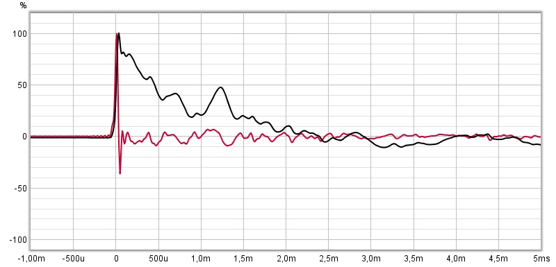

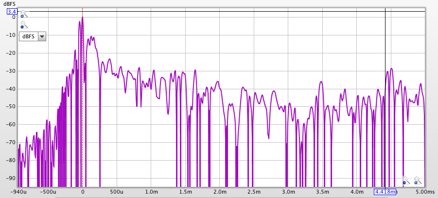

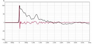

I had dug out an old 50cm measurements - 1m from floor for the LR4 speaker after individual driver EQ, but without BSC.
Note the dB impulse response still shows significant floor bounce at 4.4ms.
When windowed with 4.4ms Blackman-Nutall window and 10 cycle frequency-dependent window.
And the suggested 6 cycle freq-dependent window:
Curious as to the justification for the 6-cycle window.

here, Wesayso actually suggests 5 cycles. I think the reason is that within 5 cycles of the sound waves of interest (above some cutoff frequency), the sound is gated so that it represents that part that hasn't interacted with the room yet.
I got this from private communications with Wesayso and Byrtt, the masters of in-room measurements, REW, and FIR DSP processing. It might be suggested somewher in this massive thread:
https://www.diyaudio.com/forums/ful...-driver-range-line-array-223.html#post4709049

The 5/6 cycle window in REW is a reasonable approximation of the window lengths wesayso uses in his filters so viewing the measurement through it after correction gives you a good idea if it worked.
There is no special significance to it, change the length to see more or less of the room in the measurement. It is better for overall in room responses to gating at a specific point because that will always affect the lower frequencies in a negative way.

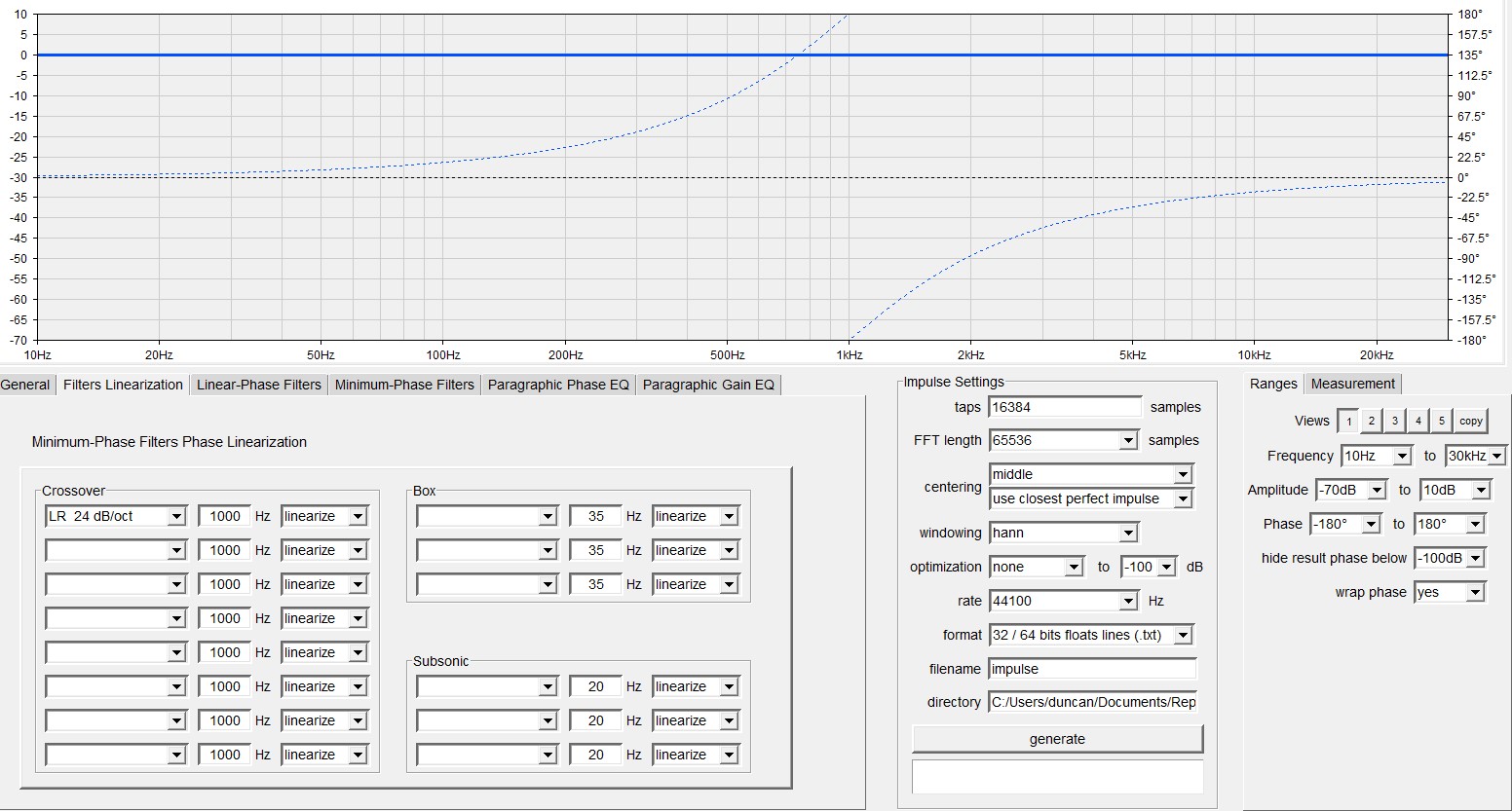

Rephase has a filters linearization option where you can generate the inverse phase shift for LR filters. If you really want the phase shift gone and can live with some latency this is an easy way to do it for an existing crossover.

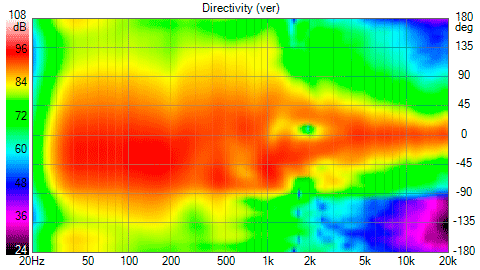

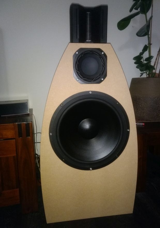

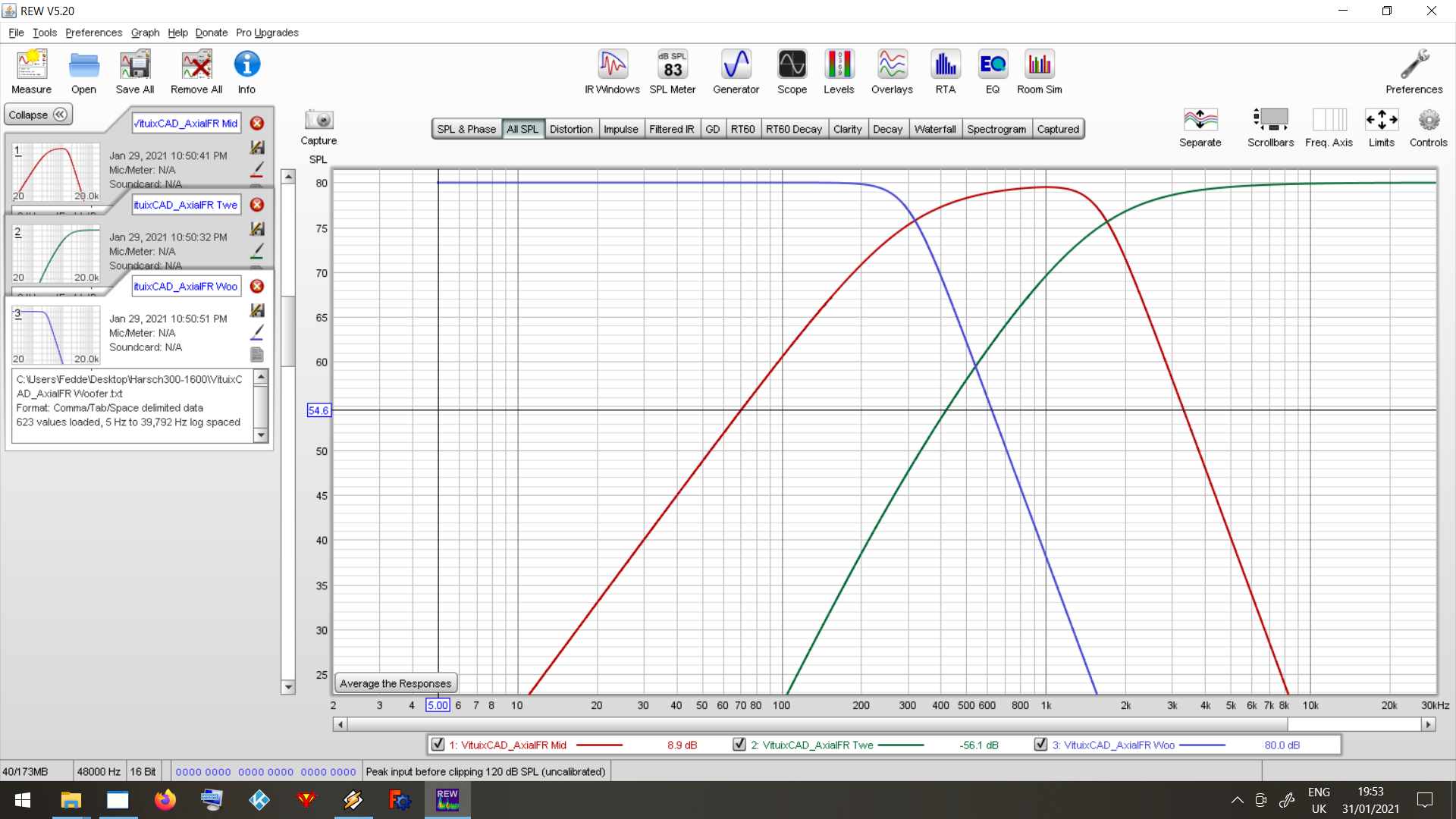

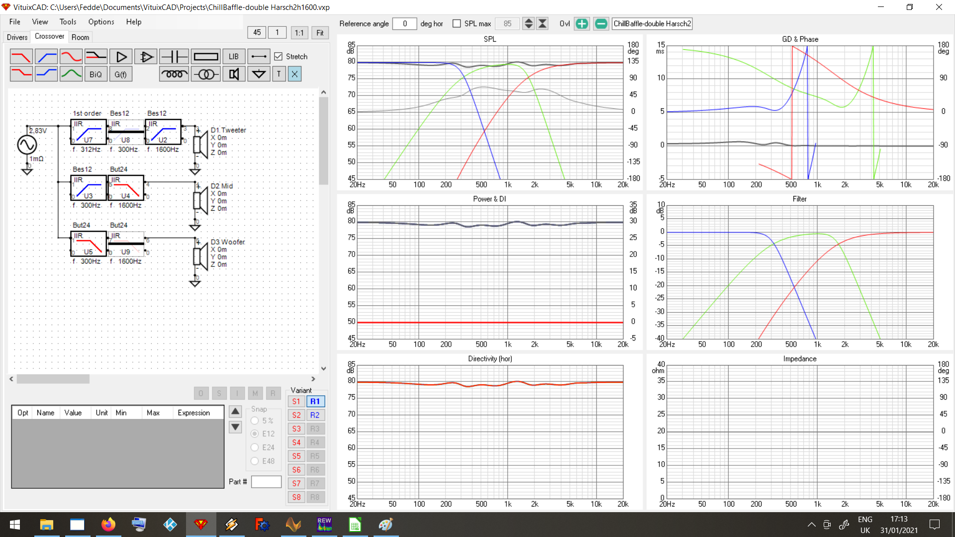

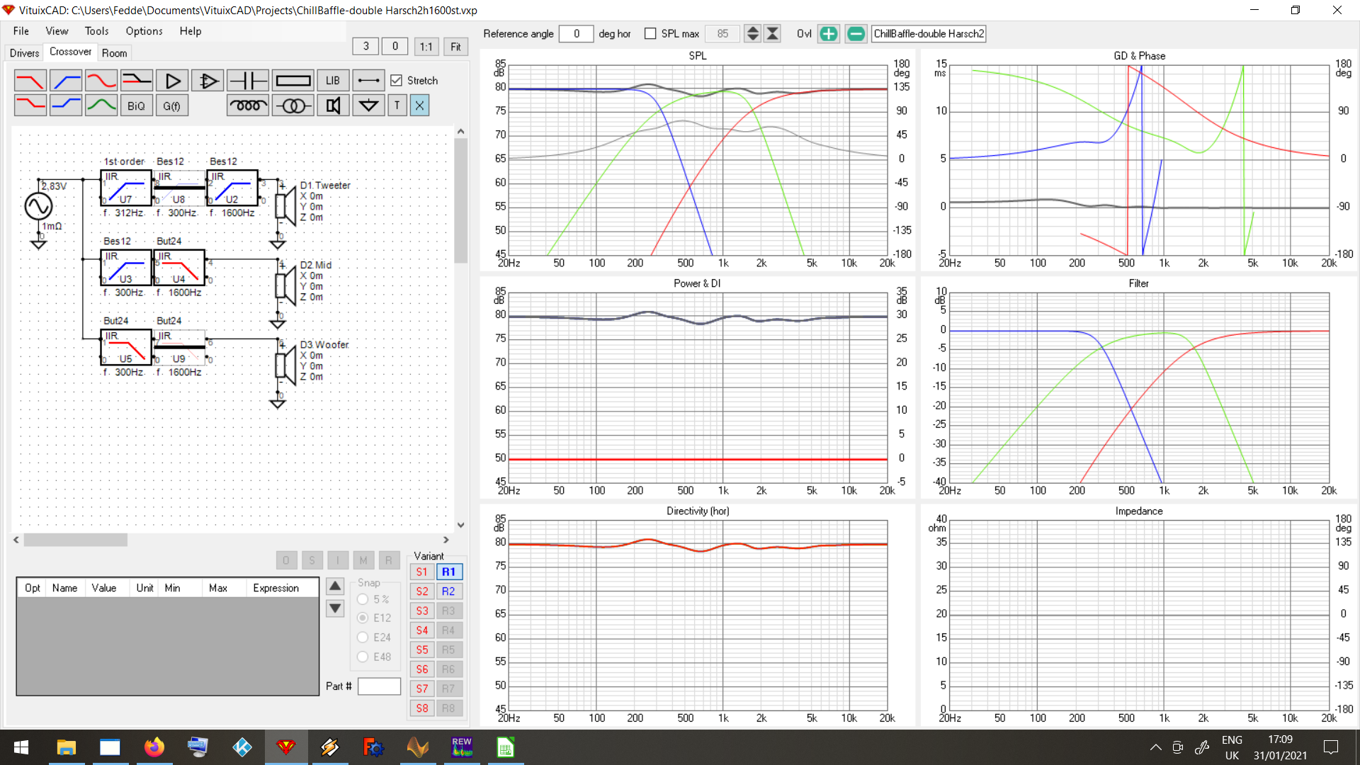

In the meantime, I am busy optimizing a Harsch XO for the latest version of my open baffle speaker:
It contains a new custom 15" woofer, 18 sounds 6ND430 mid and Heil AMT tweeter. I put them closer together vertically, compared to the previous speaker I made. I use Mundorf 4.7 ohm series resistor and 60 uF in series with the tweeter to reduce level and protect it (resulting in a first order 312 Hz HPF).
This time, I selected XO points at 300 Hz and 1600 Hz, a bit further apart to avoid mix-up. According Harsch guidelines, the delays should be 312.5 us for mid to tweeter and 1666.7 us for woofer to mid. I simulated this in VituixCAD.

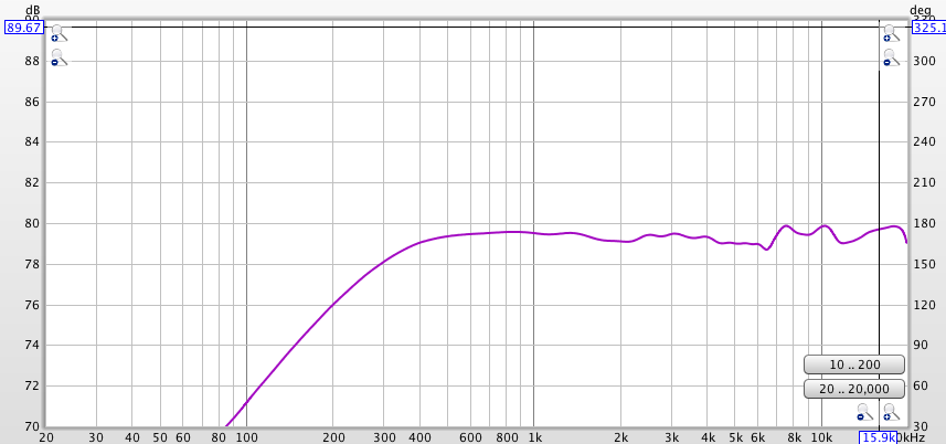

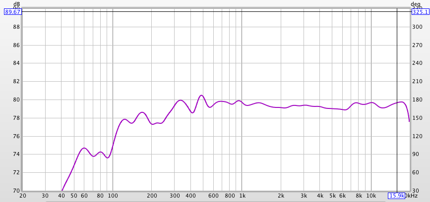

However it looks like a smaller woofer/mid delay (245 us less) improves things a bit:
Earlier in this thread I also read about Harsch variants based on 3rd order BW. This may have benefits. Anyone still using this?
Hi fedde, you should make measurements of the speaker. Ideal drivers won't get you any meaningful results in the simulator. Real measured frequency and phase lets you really tune in the crossover. That said Harsh xo as basis (and tweaked from there) I've achieved the best results yet, better sound than other crossover variations I've tried on my first prototype speaker. I cannot say what atribute is responsible for better sound, need to verify the results somehow. Extensive measurements (spinorama) has helped a lot. The measurements will show what are the natural crossover points, what electrical filters are needed to get the acoustical slopes, diffraction etc. Much better results are quaranteed with measured data, otherwise it is just shooting from the hip. Have fun!🙂
Sure, the simulation is just the theoretical foundation for setting up the filters. By the way, I found it is very easy to create the target curves with VituixCAD. You can select each one of the drivers and do an export of "Frequency response of Driver". The exported text files can directly be dragged into REW, nice:
This turned out to be very handy for debugging where gaps in system response come from (holes in individual curves vs fase issues)... 😎
Interesting project Fedde. Look forward to hearing about how it goes. That 18 Sound mid looks a lot like a Purifi woofer with the dish shaped cone and rippled surround.
The simulation certainly looks like a good way to get initial filters setup. But I have found that combining the natural response of a driver and a lower order electrical filter to get the overall higher order one the best way to go.

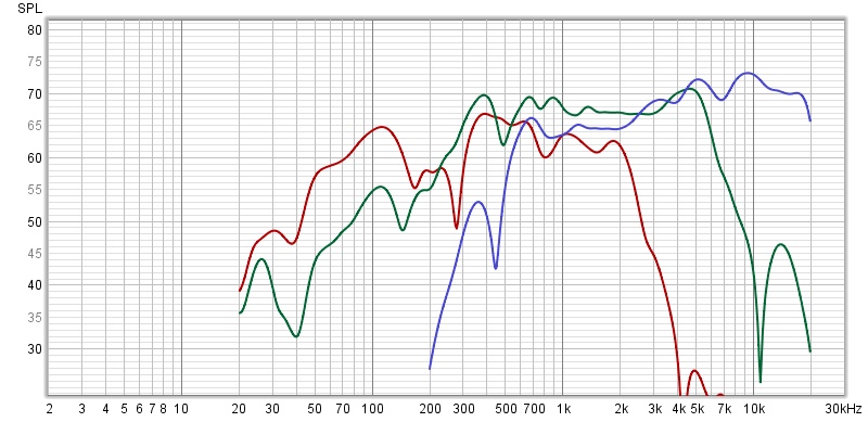

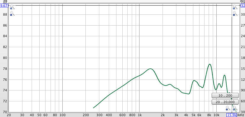

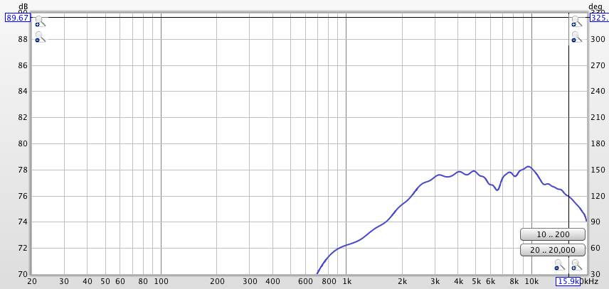

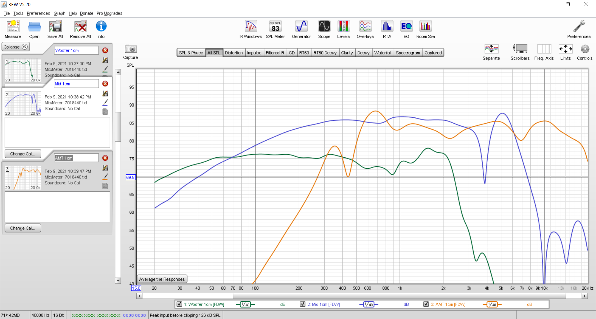

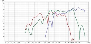

I just made some unfiltered driver measurements in the current baffle design at 1m:
(red = custom 15" woofer, green = 6ND430 mid, blue = ESS AMT)
The AMT has roughly 7 dB reduced level and 1st order HPF at 312 Hz. It starts to lose level at 3 kHz, but stays more or less flat from 700-2000 Hz.
If you look to the mid driver response, a 3rd or 4rd order HPF curve at 500 Hz fits... 😕
Perhaps I have to add short wings to lower this point?
