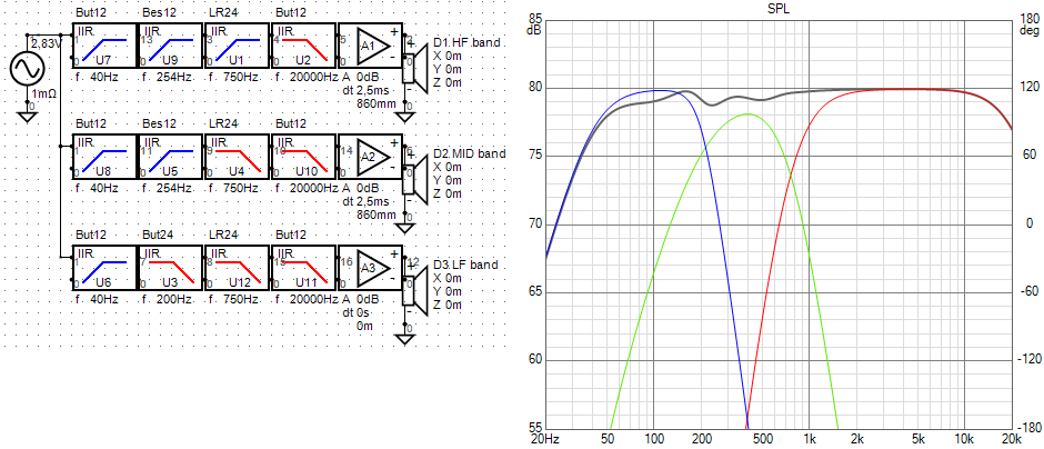

Hi xrk. Thanks for sharing info on this Harsch topology! As I also would like some of the "Harsch" sound, I did some experiments lately on my three way open baffle with Fusion amp. Do you think there is a minimum distance between the two crossovers to make this work? I have quite nearby crossovers: 200 Hz and 750 Hz. I get quite severe freq response dips near the crossovers. For LR4 this is not the case. Additional delay compensations helped a bit, but do not solve it...

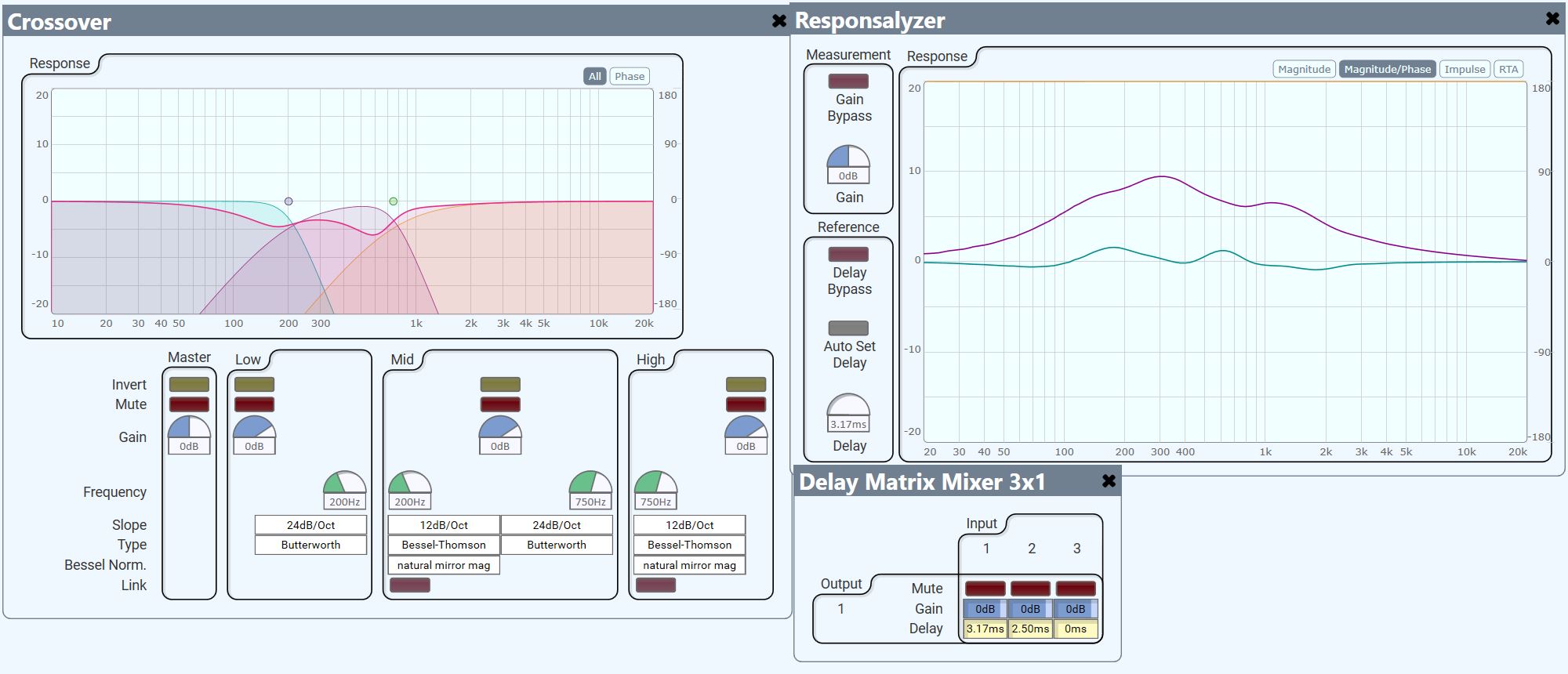

Hi guys,
software is q-sys, an open architecture design program, for use on q-sys "core" processors.

Hi Fedde,
Here's what i get out of processor: Harsch 3-way using 200Hz and 750Hz xover points summed back together.
Inputs 1,2,3 on Delay Mixer are High, Mid, Low
Hope it helps
On 2nd read, I noticed you have the filters differently as I have. I have LR4 LPF for woofer, B2 for mid HPF, B2 for mid LPF and LR4 for tweeter HPF... I thought it was mentioned like this in the opening post? Is it wrong? 😕

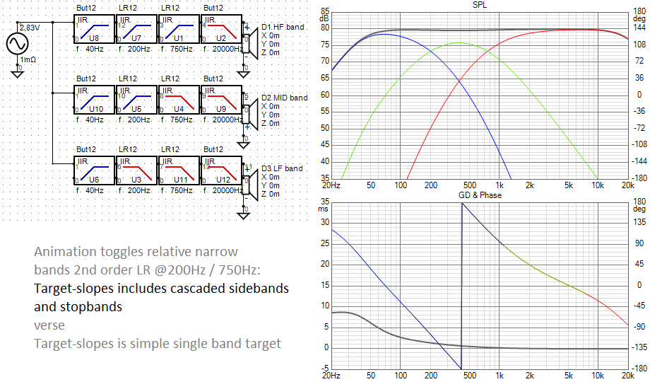

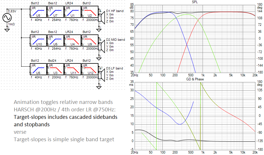

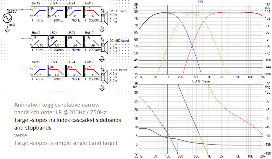

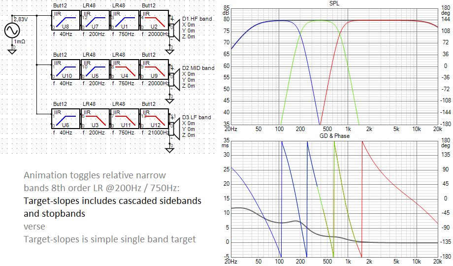

@mark100, if you happy incuding the subjective sound performance then i'm happy too, but have to say objective your post 766 looks have quite some ripple if you compare to original HASCH curve paper into post 1 and my fourth animation below for fedde.
@fedde, can't know what exactly is your culprit but as you say maybe narrow bands and also center to center distance plus vertical lobe in XO region will point downwards because filter slope for HARSCH is not in phase as for LR filters.
Using real world narrow bands can give bit trouble if one target a simple per band textbook slope, solution for that is simple to cascade sidebands and stopband into ones acoustic target slope and error goes away as seen in below 4 times animation, first animation is second order LR, second is 4th order LR, third is 8th order LR, and fourth is a hybrid HARSCH at lowest XO region and 4th order LR at highest XO region, because they each animation are unique how much each of the three passbands cooporate to sum each their region each animation have their different looking error when side plus stop bands are omitted.
Use a mouse click inside animations to hinder X/Y ratio distortions:

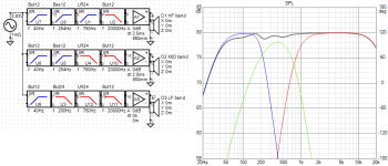

Know animations toggles relative fast in 500mS but all information is frozen there during shifts except for curves and they curves will come fast back to the eye or make a print screen 🙂 that said i slow them down next time its just i can't edit that post anymore.
Here are static graphs for numbers and ripple in that fedde theoretical model, have added power amps buffers so as you can see used numbers for delay time or in distance set for MID/HF sections, if your software is not happy that times 1,27 thing for bessel filter then try use 2nd order LR plus one PEQ Q0,58/+1,3dB because then it works use exactly same frequency as for the low pass 4th order BW slope..
Use a mouse click inside animations to hinder X/Y ratio distortions and improve resolution:
