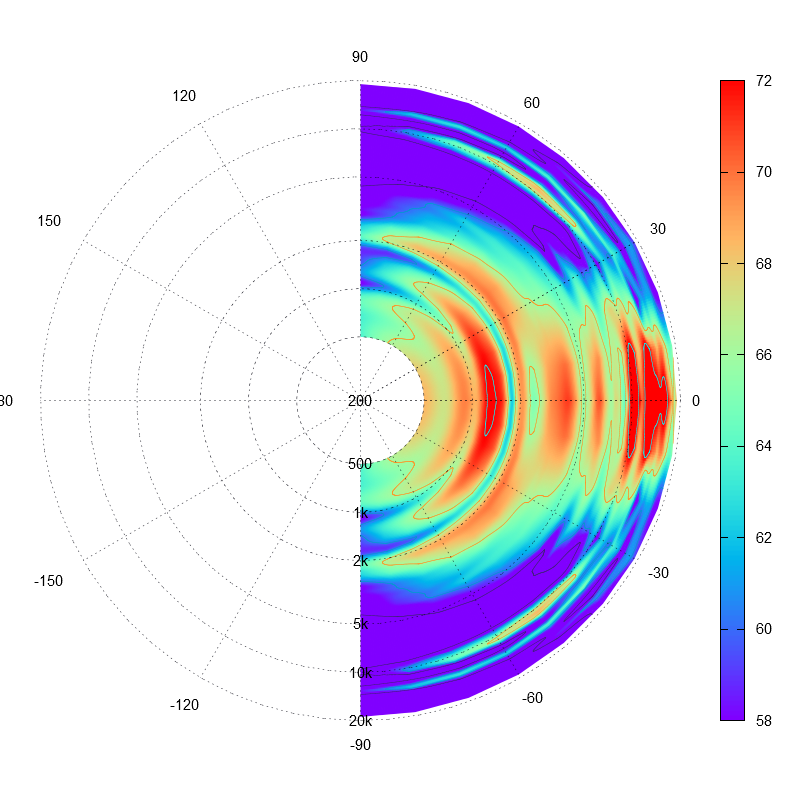

I don't agree. It's best handled with EQ as most wide band drivers have a frequency response that changes dramatically fast off axis. See Rutcho's measurements.

The problem with those high frequency peaks and dips seen in lots of wide band drivers is that there are so many. This will lead to reduced loudness and spectral coloration. A countermeasure would be to apply a broad boost but then the peaks will become audible again. It's a catch-22. All in all drivers with smoother response are better.
By the way, do you plan on doing more off-axis measurements? CharlieLaub has a fantastic tool for plotting these.

I would prefer the 105. Relatively smooth off-axis response. The peak at 7.5kHz shows up off-axis too which suggests that it can be eliminated with EQ.
