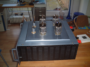

My OTL running 3 year without problems.
Hi Walter
What kind of sockets are you using? Have you cleaned the sockets during these 3 years? How much cathode current are you using?
I have read a lot about problems with sockets for 6C33C but I never had any problems neither in my SET amp during 5 years or in my OTL during 3.5 years.
From what I have been reading and seen on the internet the chinese sockets seem to be a lot of problem, they look like a cheap copy of the ones I am using and I think the spring that pushes the connector towards the pin is too weak or made of the wrong material.
One common mistake is to use normal Septar sockets for the 6C33C, I used those kind of sockets for YL1070 when I designed and built RF amplifiers for the military but these didn't have the springs at all and not good enough for 6C33C.
Regards Hans

Socket 6C33C
Hello tubetvr
often are in Russia. All bases are from russichem military transmitters best quality from the years 1960-75 likewise the tube this work with approx. 250mA at 150V. The pins I have never clean-have already the 6C41Ç = 0,5x6C33C used without problems.
greeting walter
