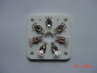

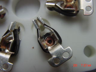

Some pictures of russian 6C33C sockets, they dont seem to be that special, 1 minute on google turned up several suppliers both in US and Europe who seem to stock the same if you judge from the pictures that is shown.
These sockets have survived 5 years in my SET and 3.5 years in my OTL without problems, let me point out that I dont remove or even move the tubes witout reason, in my SET I haven't even touched the tubes except for removing dust on them during these 5 years.
Regards Hans

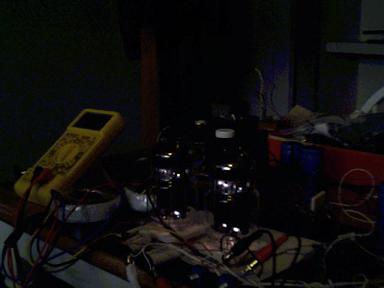

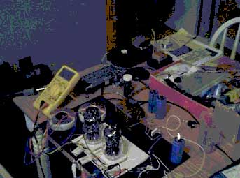

Hi
I measured Heater voltages in my OTL amp today, I have not touched the tubes for at least one and a half year.
Values for one channel
At socket at heater pins
6.29 6.28
6.28 6.27
6.29 6.28
6.29 6.27
So the highest voltage drop is about 0.02 V which with a current of 3.3A gives a combined contact resistans of 6 mohm, not so bad! The combined power dissipation in the socket connectors is only 66mW which shouldnt be a problem.
So my conclusion is that these sockets should be alright with 6C33C
Regards Hans
