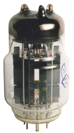

Hello ,
These valves need a bit of care and attention . Due to the very high gm , it is 'safer' to use these at slightly lower dissipation , about 40-45W . Run them close to dissipation limit and you're looking for trouble ! I found this out the wrong way . Sockets need to be considered carefully , I have found problems with Chinese and Russian ceramic B7a . Use a Johnson or British teflon b7a socket . As 6C33 have a glass base , most of the heat is transferred via the filament pins which can cause problems with the socket contacts , use as thick a cable as possible for the filaments which also acts as a 'heatsink' . 6C33 also get VERY hot , I find it preferable to use the teflon sockets which provide a bit of chassis clearance . To date I have successfully used 6C33 arranged in a stacked parafeed 'SRPP' setup , running conservatively at about 250mA . Driver valves need to be considered carefully , due to the low mu , plenty of grid swing is required . 6SN7/7N7 sounded very flat and dull , something along the lines of 6BL7/5687/2C50/6BX7 is preferred . The good news is that after checking a few weeks ago , the bias in the amp is virtually spot-on what it was when the amp was built a year ago so I would expect these to have a long life .
A hairy-chested valve , not one for the 12AU7 pre-amp building 'boys'

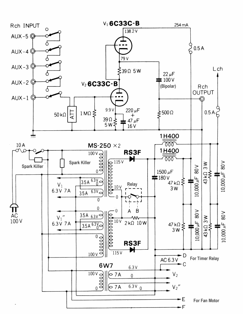

Is it a headphone amp? the reason I ask is that the output capacitor seems very small so maybe it is assumed that the load impedance is high.
As this circuit only goes in class A the ouput power is very limited, for any useful power for speakers you have to run in class AB which is not possible with this circuit.
Using 200 mA idle current and 2 6C33C I put out 25W in 8 ohm class AB, tubelife is very long and no longterm problems so far.
Regards Hans
