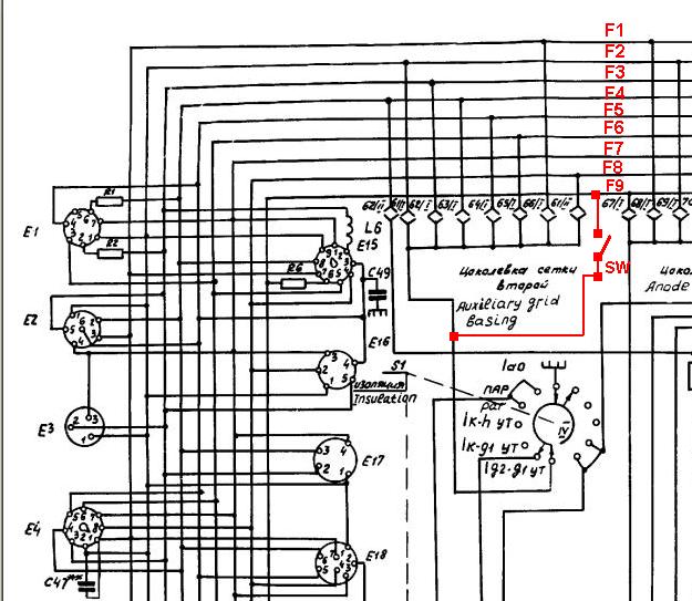

Well, for using the socket no.11 at full capacity, I just installed a switch that connects line F9 (or 'I' in the russian schematic) with the G2 power supply (the common point of the contacts {61,62,63,64,65,66}/I and 61/II.
When I want to connect F9 to the Ug2, I just push that button :)
Here is the modified zone (see also the attachments):

WARNING! VERY IMPORTANT!
When using the installed switch "ON" (i.e. line F9 connected to Ug2 power supply),
ALWAYS CHECK THAT {43/II ; 51/II; or 50/I} pins to be NOT CONNECTED !!!
