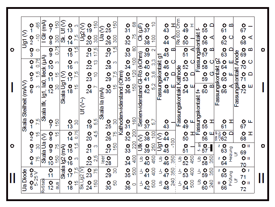

Hello, I am new owner of a L3-3 and with your very useful guides I'll be hopefully able to calibrate the tester.
I have a BIG question though: where I can find a pin board layout with the correct numbering of each hole? Sorry if this sounds dumb, but I cannot find such information. The only thing I found it's a card with all holes punched, but the numbering seems incoherent with your indications (6/I etc.) Thanks for you help! Stefano
You can print PDF copies of perforated boards with 1:1 size ratio, cut them, and use instead of original ones. This is like I did. Kinda boring making so many holes, but this is the best choice available
If the card you have has all the holes punched, then it is the calibration card or grid card. The upper half is I and the lower half is II and each half is numbered from 1 to 72. The first column is 1 thru 6 for the upper and lower. The second column is 7 thru 12 ans so on up to 72. See attachment
Thanks for your help, it's really appreciated
I've bought a digital signal generator and will be hopefully able to perform the transconductance calibration very soon, as per your instructions posted here.
I'll keep you guys updated about this.
Best, S.
Hi guys! 162 cards for non russian tubes in sPlan format is here _http://slil.ru/28906942. Free viewer is here _http://www.abacom-online.de/uk/html/splan.html
