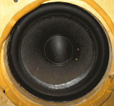

having now two of these elements

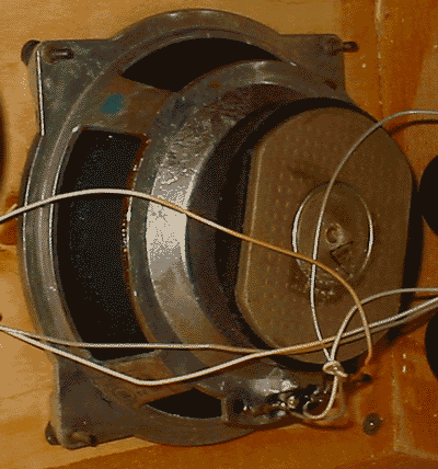

a pic from behind
