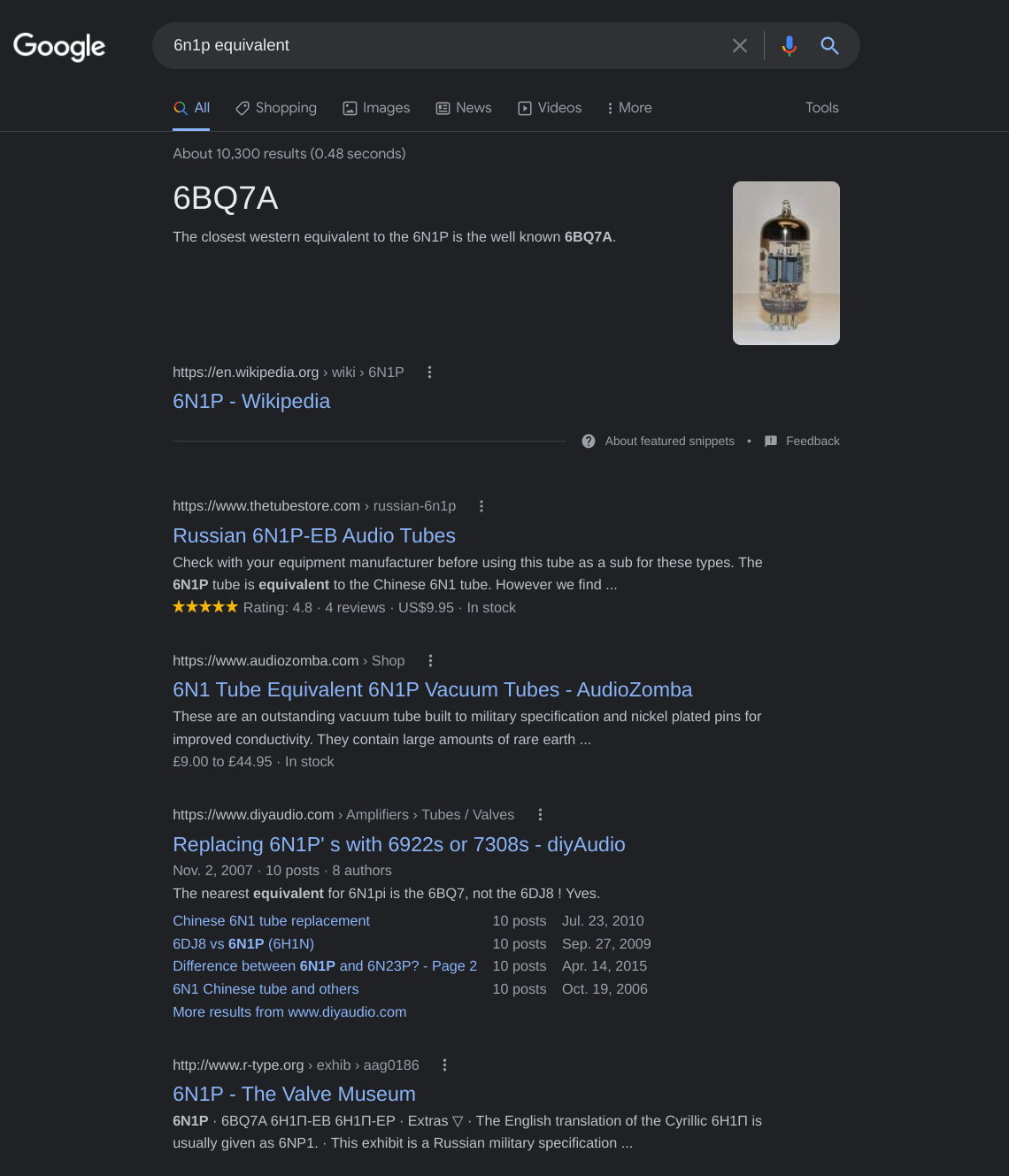

This! 6N1P == 6BQ7A though.
My old GE TV had 2 6BQ7A in the channel selector, they were designed for VHF/UHF, I thought the 6N1P was designed for audio.
6n1p is not even close to 6BQ7 , it is like the triodes inside old ECC40 , including high filament current 600mA
Maybe the 6N5P is a better RF version but the curves look close. There is no true western equivalent to 6N1P as far as I can tell..
