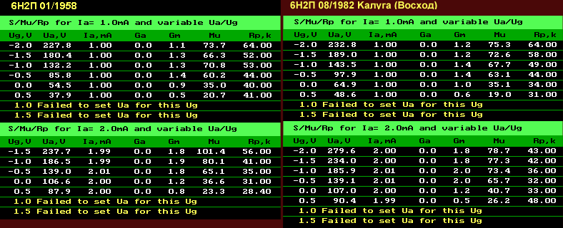

6N2P is the only tube that replaces a 12AX7 as far as I know.
Same reason I use them - 12AX7 isn't as good IMHO.
Tube Tester Files - 6N2P - 6H2P
Tube Tester Files - 12AX7WB Sovtek

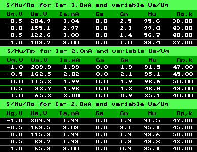

TBH I don't know. 6N5P and 6N1P work the same in the same circuit though but I heard the 6N5P was designed for RF.
Tube Tester Files - 6N1P - 6H1?
Tube Tester Files - 6N5P
