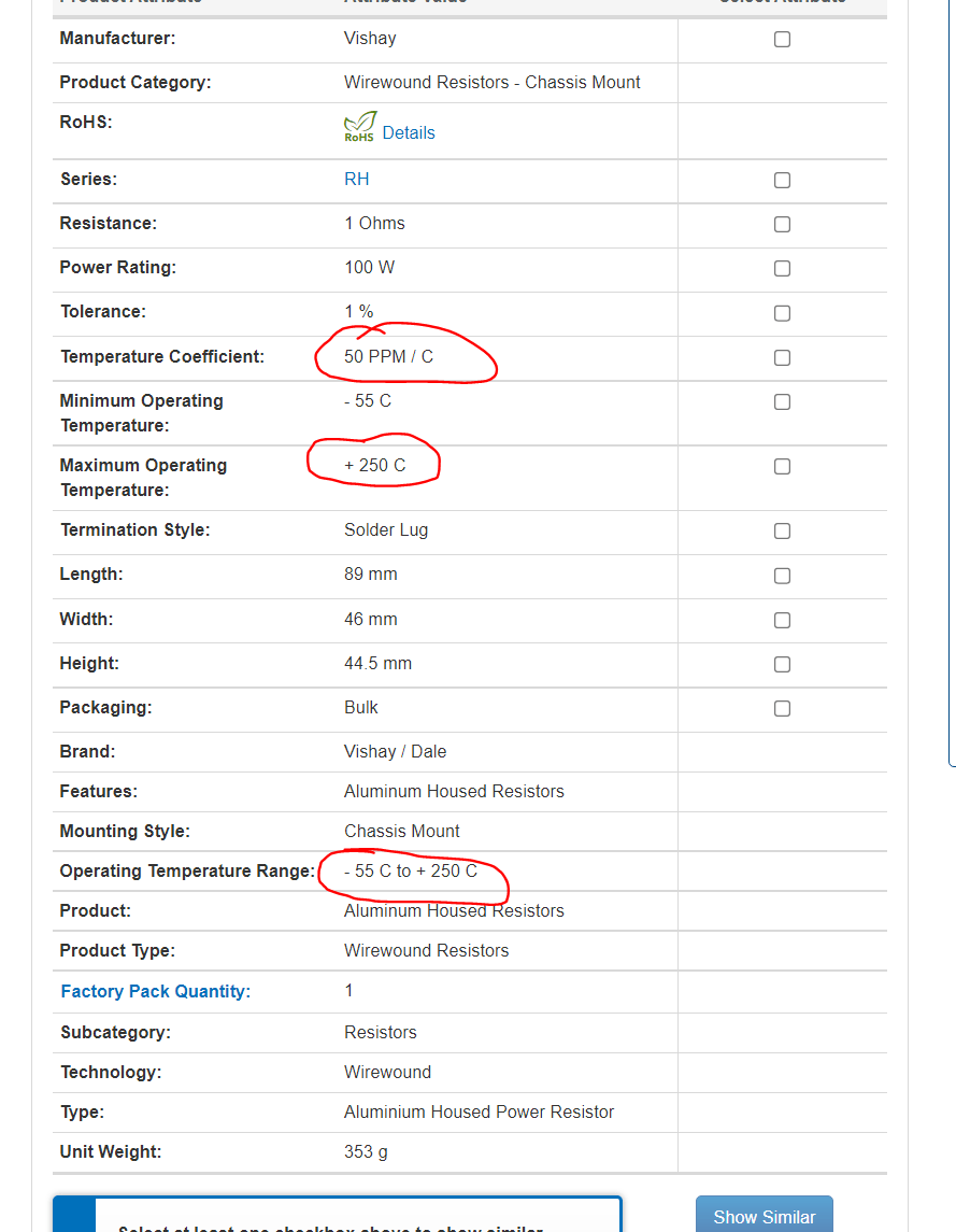

thanks.... I need to get parts.... need to get scope.... 2 channel, max 100Mhz. USB. Not overly expensive like the behemoths at work.
Ideas?
For function/signal generator I can use a PC with an external DAC.
Yeah, those expensive external resistors will prove to be the kabosh on the practicality of the endeavor, but it should be fun. Hopefully it won't be like the very first power supply I built... it had NO on/off switch because then, at the tender age of 22, I know exactly what I was doing. Hmmm...
This one is an overkill
The cheaper one will do. Maybe get 4 x 8 ohms, so you can play with 16/8/4 ohms (stereo, both channels driven) combinations..?

Thanks.... I do need dummy loads to match the dummy running the test.
Funds... well, I just did the shopping, fridge in the garage has plenty of good IPA.... the kind that is 8% and 9%, plus I got beaucoup de wine, spirits and cigars. I might have to invest in a fire extinguisher and run this in the garage.... I'm very good at smoking electronics. Too good indeed. ;-P

Sure thing. You can find this for other parts as well, but not for all parts, and, most likely for the parts on the same die.well alot of infighting and conjecture in this thread but after some thought and some quick research it seems an industry giant agrees with tonyEE;s thinking....
https://www.analog.com/en/technical-articles/paralleling-amplifiers-increases-output-drive.html
Those f...ers are matched to mV if not uV levels. Newer ones often use CE output stage which is "a current source".
Connecting in parallel as done by Self, JFI, require some knowledge, experience and, God forbid, some testing.
Power things paralleled I've seen were BUF634, which again, were well matched diamond buffer IC.
BTW if a giant agrees with someone it does not make one right or otherwise.
