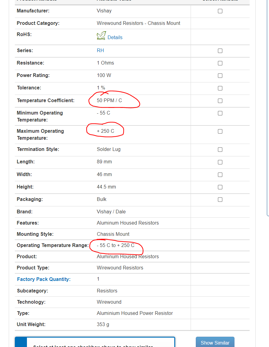

That will depend on the load, and how the speakers are connected to the (paralleled?) amplifiers. The best would be to try and see, with your amplifiers, with your speakers and your speaker wiring (and how that wiring is connected back to the amps). You could do a lot of testing on the bench, just get some 100W resistors, a tone generator and a cheapish oscilloscope.
Mouser, 1%, 100W, wirebound resistors are ~18 bucks each, part number :
Mfr. Part #
HSC1001R0F
Mouser Part #
279-HSC1001R0F
There is also another 1%, 100W, wirebound resistor, but these are ~160 bucks each
Mfr. Part #
RH1001R000FE01
Mouser Part #
71-RH1001R000FE01
Do you know why such a difference?

The cheaper one will do. Maybe get 4 x 8 ohms, so you can play with 16/8/4 ohms (stereo, both channels driven) combinations..?
If paralleling the amps, make sure they don't oscillate. You could add a bit of capacitive load... just as a simulation of speaker wiring capacitance.
