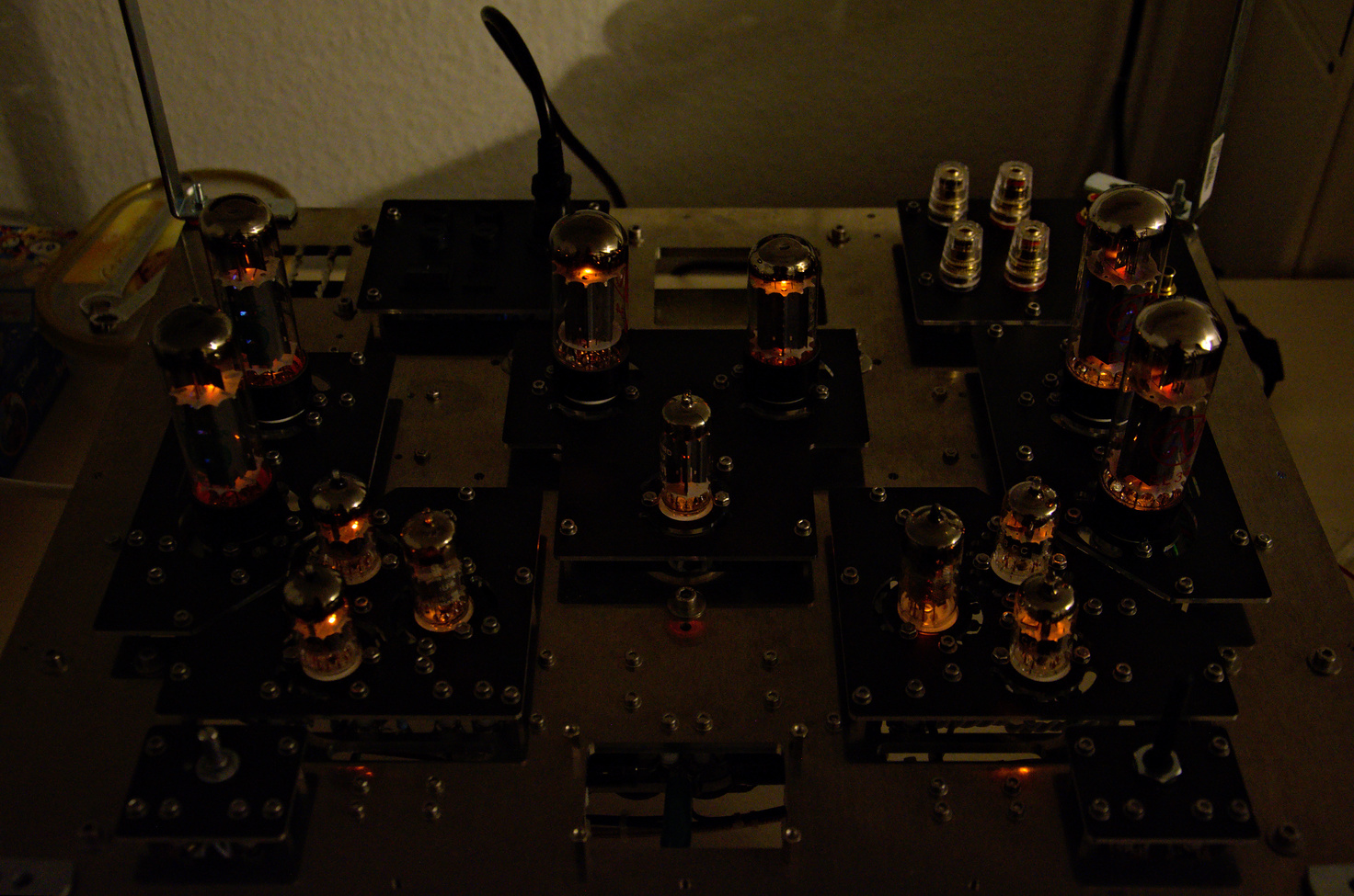

Another step forward...
... this weekend: The input and output wiring is finished...
attachment.php
Now, only one panel is missing (middle front), three indicator lights will be mounted there to indicate HV enabled, B+ left up, B+ right up. They are powered from an unused 5V winding and switched via the auxiliary contacts two relays directly powered from the B+ rails. The relays switch on the heaters of the EZ81 for the negative rail as soon as both B+ are up.
A nice result: Although there is not yet a full enclosure, the amp is absolutely quiet with no signal present. No hum, no noise even with the ear close to the speaker.
Only a slight hum is audible from the power transformer, it vibrates more than expected. Hope to get that damped a little with the housing design...
Kind regards,
Andreas

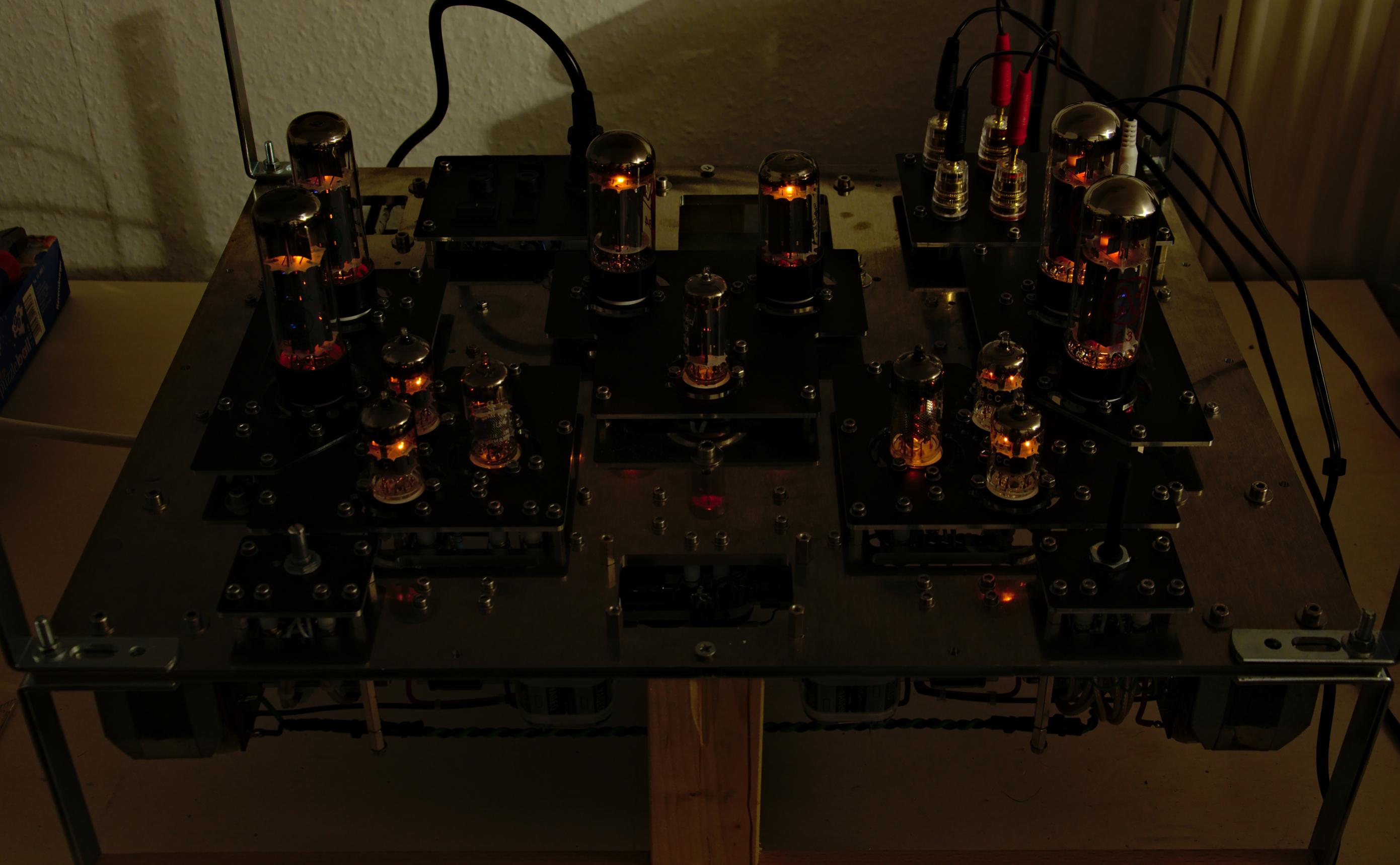

Hi there,
I thought I might give an update:
The amp is running fine now, I prepared the structural parts of the housing and put the finished chassis in. Still got to do some stress testing with a new 5AR4 rectifier, I replaced the second JJ with a Sovtek to have the same rectifier tubes in both channels. But after some spark-ling experiences with JJ and Sovtek 5AR4 in the (admittedly demanding) power supply there will be some testing before the amp is moved to the living room for temporary use.
Current state of the project:
In operation:
Next steps:
1. Make a nice wooden frame around the basic MDF housing.
2. Find a manufacturer of high quality potentiometer knobs.
2. Finish the top plate to cover the whole thing nicely.
Rundmaus

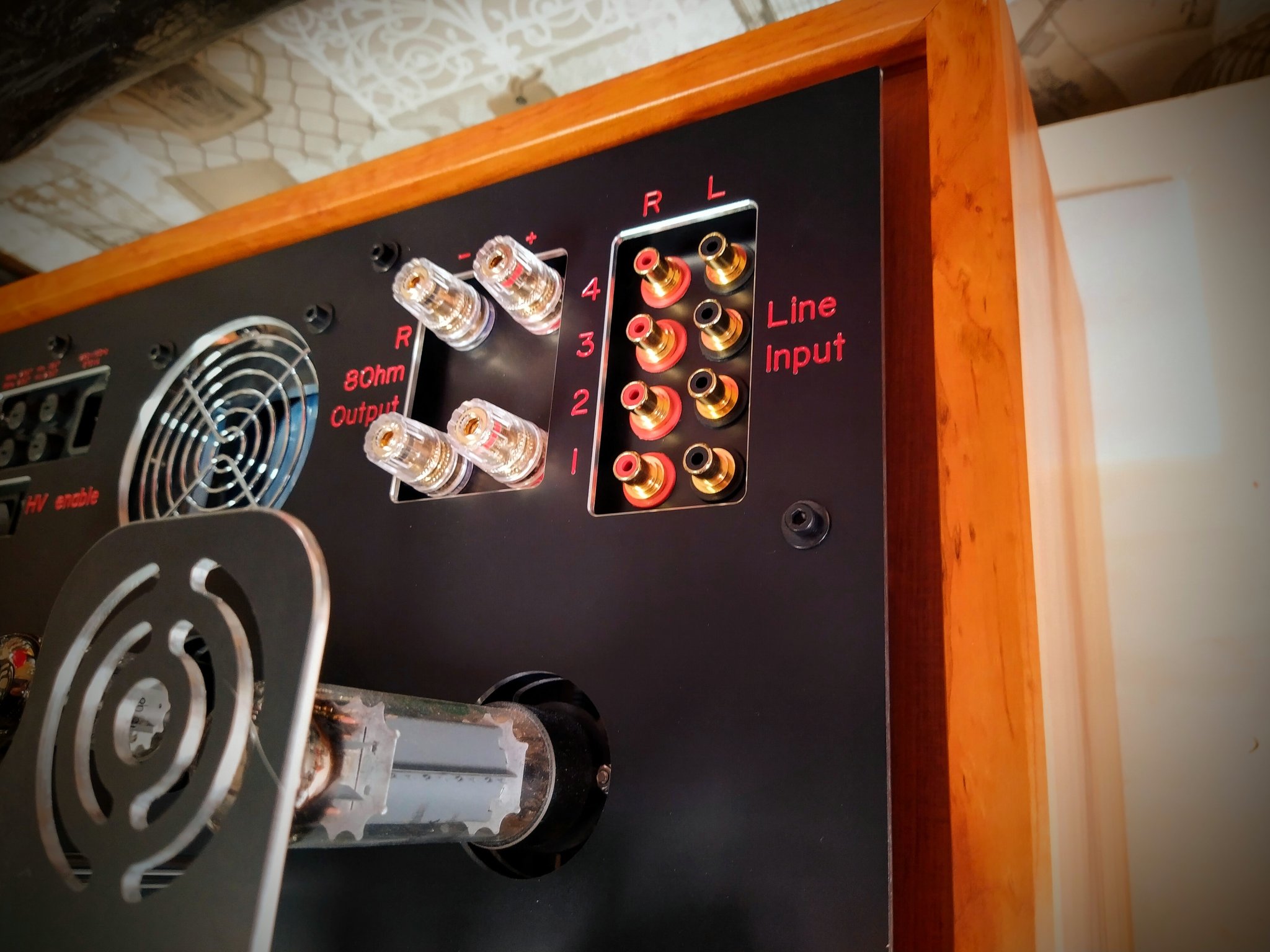

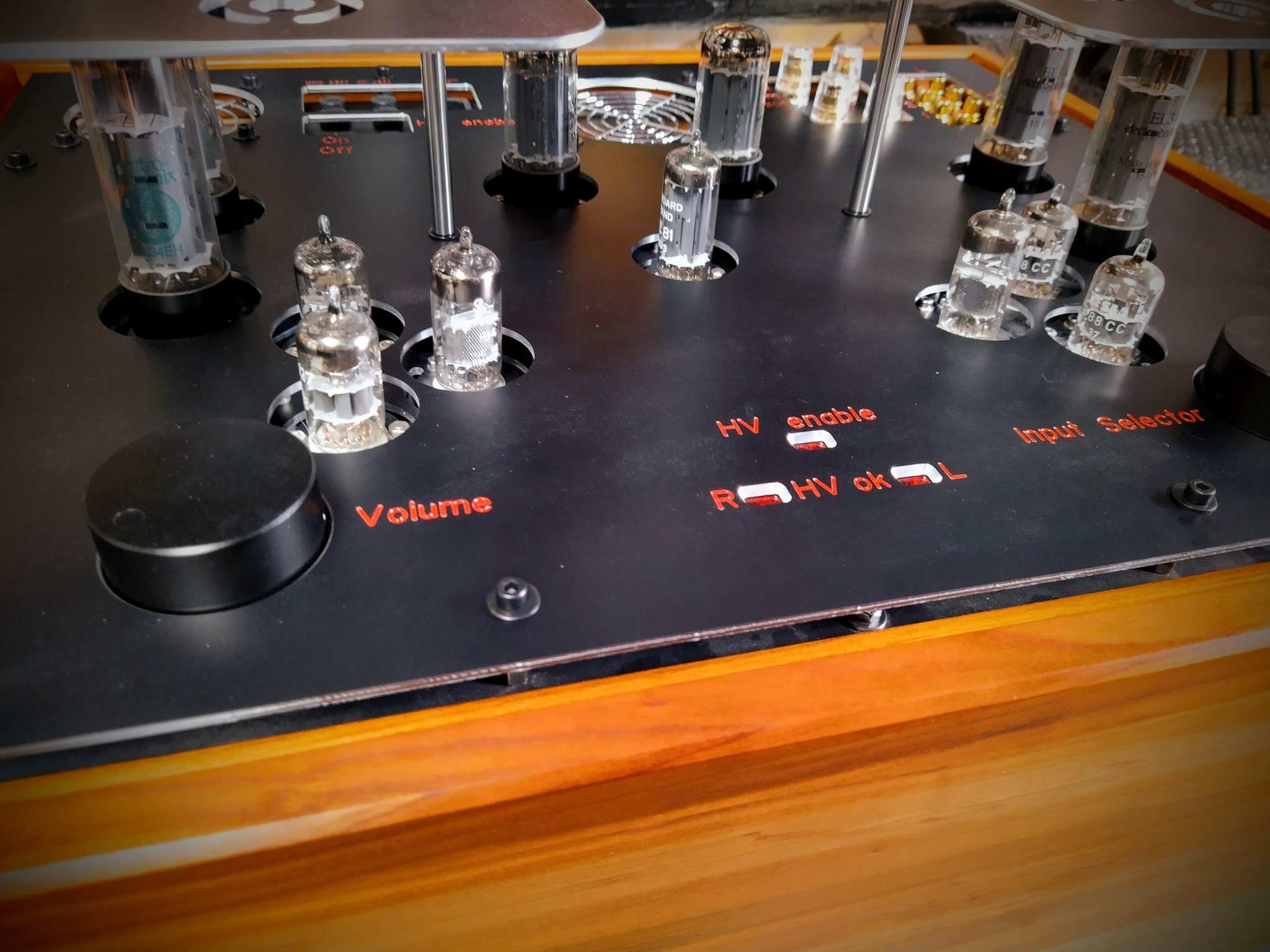

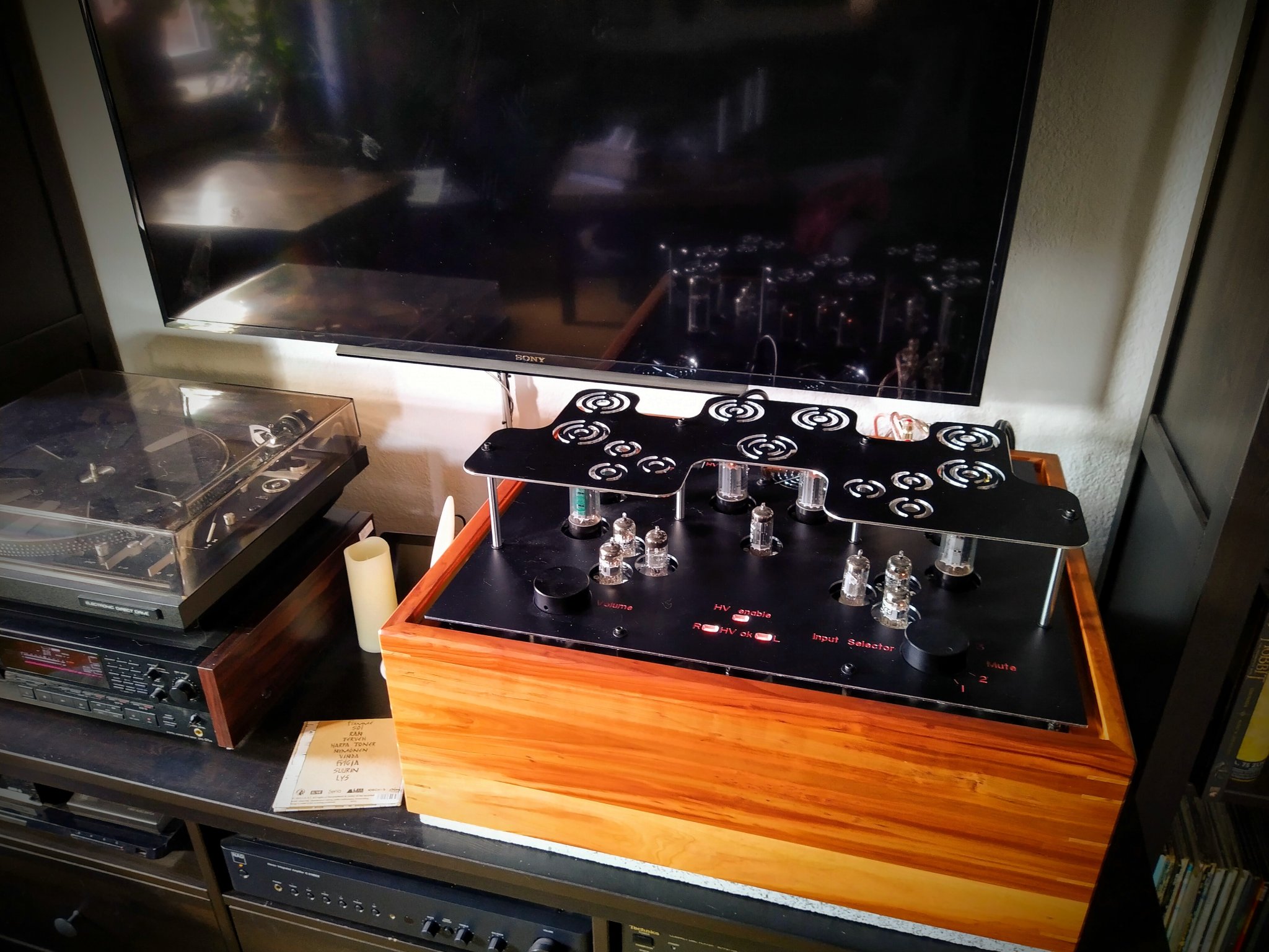

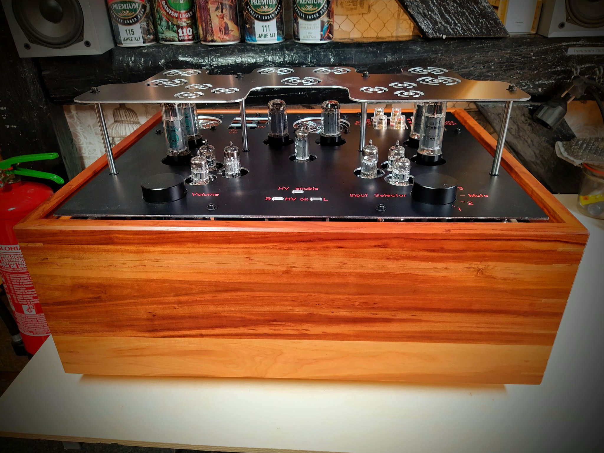

So it finally happened.
I haven't been active in the forum for a while, maybe some older members might remember me.
But I just felt compelled to let you know that the longest and slowest project in the history of DIYaudio has finally concluded.
With the commissioning of a beautiful housing made by a local woodworking artist, my amplifier is finished after more than ten years into the project.
I'll make sexier pictures once it's off the workbench, but here's a first look. Enjoy!
Rundmaus
