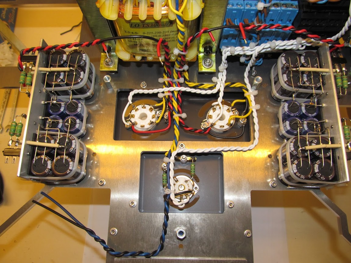

But again, a little progress has been made, the cathode resistor assembly with the EL34 cathode resistors and the large bypass electrolytics is finished:

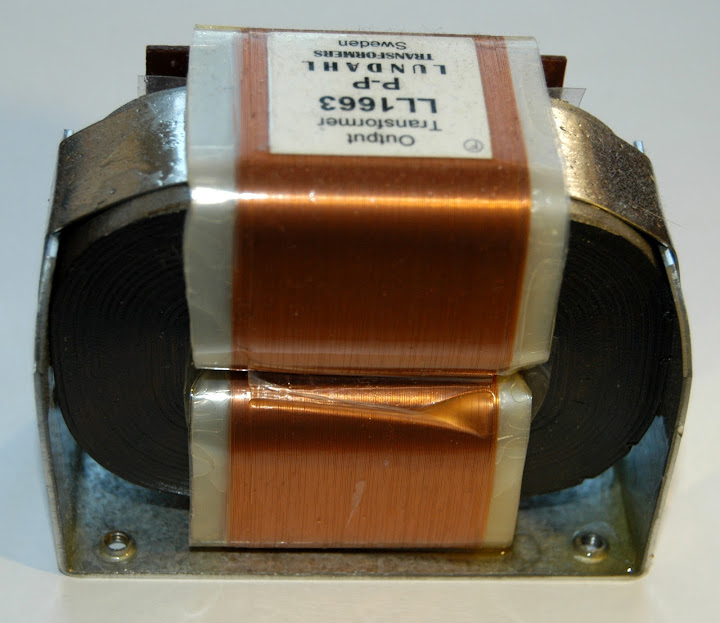

And last month the output transformer for the test setup has arrived from Lundahl:

Good news,
one channel is now completed and running. No magic smoke exited any component upon powering up. Everything works nicely, including seemingly good, undistorted sound from the test speaker!
No trace of hum audible, even with the ear being close to the speaker. Without signal, only a slight buzz can be heard close by, coming from the power transformer and the isolation transformer below the workbench.
Component / wiring side of completed channel:
Note: Signal input and speaker output are connected 'quick and dirty' for testing purposes only. The I/O connector board, source selector and volume pot are not present yet.
Top side of the completed channel:
Note: In the completed amplifier, all subchassis will be covered by a single, powder-coated cover plate with the corresponding cutouts for tubes, switches and connectors.
