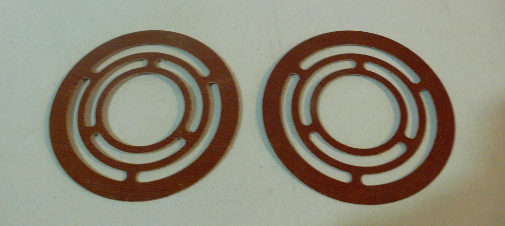

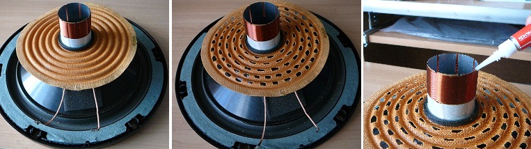

1. So in the old days they lowered the resonance of the centering tissue washer (dynamic state) ....
2. This is the spider itself. Long time does not apply.

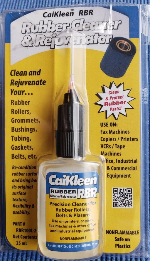

I've been noticing for several years now that some woofers with rubber surrounds
end up having the spiders with significant sag, about 1/8". This was on all the SPICA
TC-50 woofers I have, 6 of them. I also see it on Celestion SL6 s both in a set. I'm
not sure what these are made from, the later SPICA woofers might have gone to PVC.
Anyone tried CaiKLeen?: Is there a chemist in the group?
Also, I once used WD40 on some rubber household parts that were sticking only to
find that the rubber expanded, probably due to the solvents. I wonder if this might
work to expand and soften those "rubber" surrounds. A last resort I suppose.

I usually replace the hardened surrounds, but I have heard of people using oil of wintergreen to restore rubber surrounds..but it is toxic when ingested, so you wouldn't want to use it where children or pets might get in contact with it.
I think any petroleum based rubber treatment is probably only temporary anyway.
I've tried several treatments including wintergreen oil, brake fluid, Rubber Renew, etc. All temporary at best. New surrounds were the only solution for me except for treated cloth surrounds. I have stripped and retreated them with the dissolved butyl rubber from RoyC.
