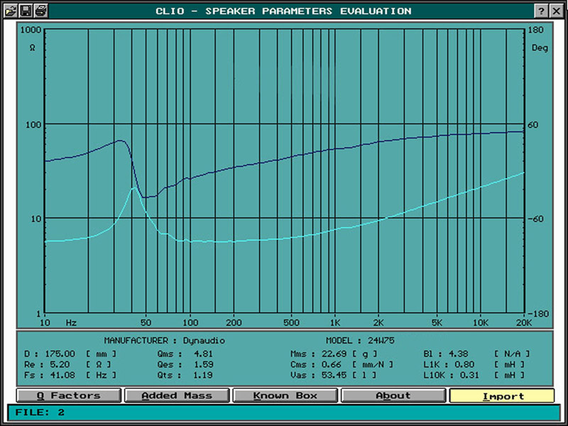

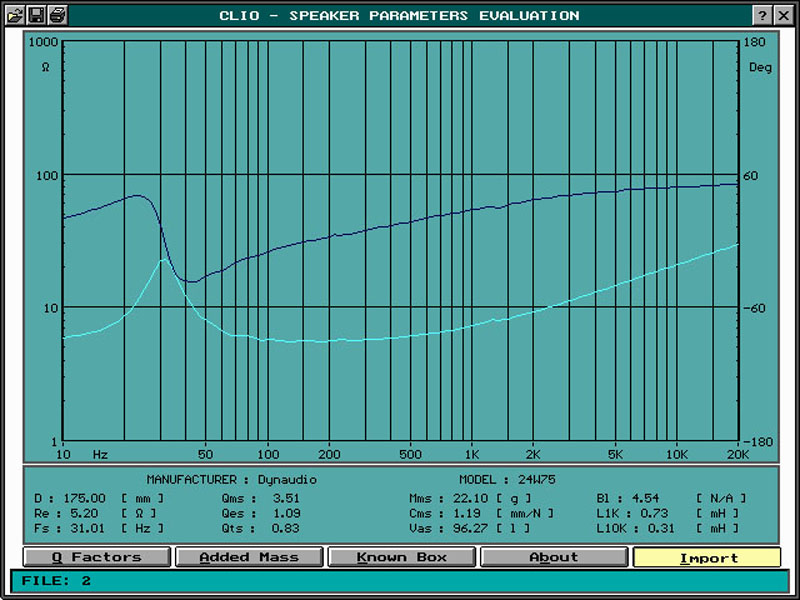

In my case the difference was this.
Wow, what was the drive level? Rubber surround?
Is that "before and after", or "after and before"?
I don't know the exact voltage of drive level, it's the same in both
measurements in the fashion Audiomatica programmed it.
The higher Fs measurement represents the same driver with a
stiffer foam surround I got from a Dutch ebay seller. Funny thing
happened, the bass sounds now tighter. I should also say that modified
driver in the box has Qts approximately about 0,9 without dcr of the
LP coil. The stuffing did that. Before, then after.
..so the newer surround is quite a bit more stiff than it should be - that makes sense, its adding resistance that should only be part of the spider. (..happens all the time with corrugated cloth surrounds in pro drivers, must be pretty tough type of foam.)
I'm guessing it was tested at a lower voltage.

... must be pretty tough type of foam.)
The new foam looks really good, only when you touch it,
you know it's not original and it feels tougher allright.
I've looked in the Clio manual and it says that Internal mode
of measuring impedance, which doesn't need external amp,
calculates based upon output impedance of 100 ohm and outputs
sine wave test signals at 0 dB which is 0,775 V rms. The internal
mode is accurate for measuring between 1 and 400 ohms, for the
greater values, the external mode with sensing resistor and an amp
should be used.

For the most part changes in T/S parameter at least within normal use parameters, have little to do with the surround - rather its mostly about the spider, particularly with "roll" surrounds (rubber or otherwise). The testing for T/S is based off of Impedance around resonance - which the surround really doesn't effect much. You can also get varying numbers based on the amount of voltage used in the test relative to the rest of the motor's performance (..i.e. Impedance at resonance usually "flattens" out some with higher drive levels ..like 5 volts or more depending on the driver). The "DATS" tester can go from .35 to 2 volts (..which is a bit less than your standard 2.83 volts for impulse response measurements at 1 meter.)
This is completely wrong. The surround/edge contributes quite a bit toward the total
compliance. The PSB woofers shifted considerably, and many have noted that if cheap
low compliance foam is used the Fs shifts up quite a bit.
