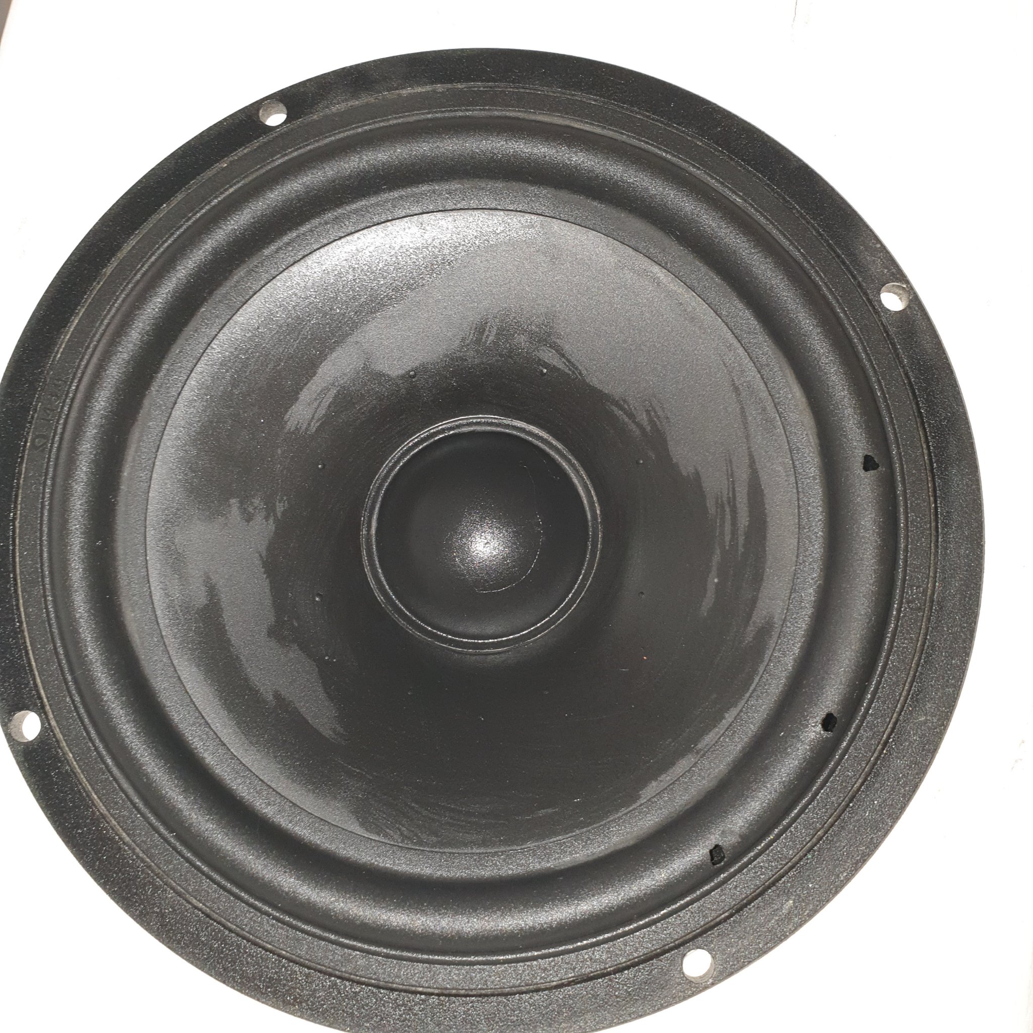

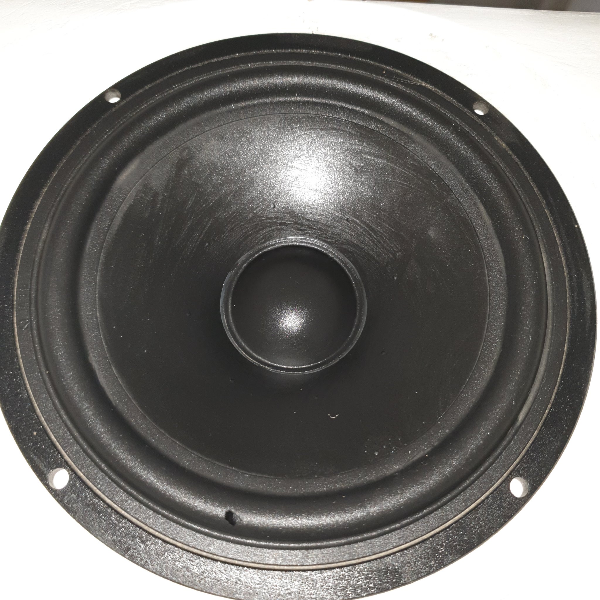

Hi.I put my Vifa P17WJ00 woofers in warehouse but i found them like this in the picture attached 🙁 One of them has 1 dent and other has 3. I do not know how it happened. Maybe mouse ate the rubber. Please check.
How can i fix them? I do not want to change the rubber surrounds right now.
