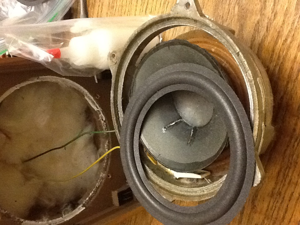

I'm trying this - I found it on ebay (this is the ebay description) NEW 5 " INCH FOAM REPLACEMENT MIDRANGE / WOOFER SPEAKER SURROUNDS / GLUE KIT
Cost around $14.00 for a pair + glue.
I 'm in the process of trying to use them. They look like an 'almost' fit. I found instructions on youtube (can't remember where, of course)
I'll post results of the attempted repair.
The picture shows the replacement part, the speaker and the glue bottle that came with the kit
Continued...
It was quite difficult to get the new suround on. One has to be careful not use too much glue. I didn't get it as centered as I would have liked, so I have reinforced the weaker side with a layer of thin, cloth based paper. I'll try it tomorrow and post results as to how it sounds and whether it holds up to loud noises.

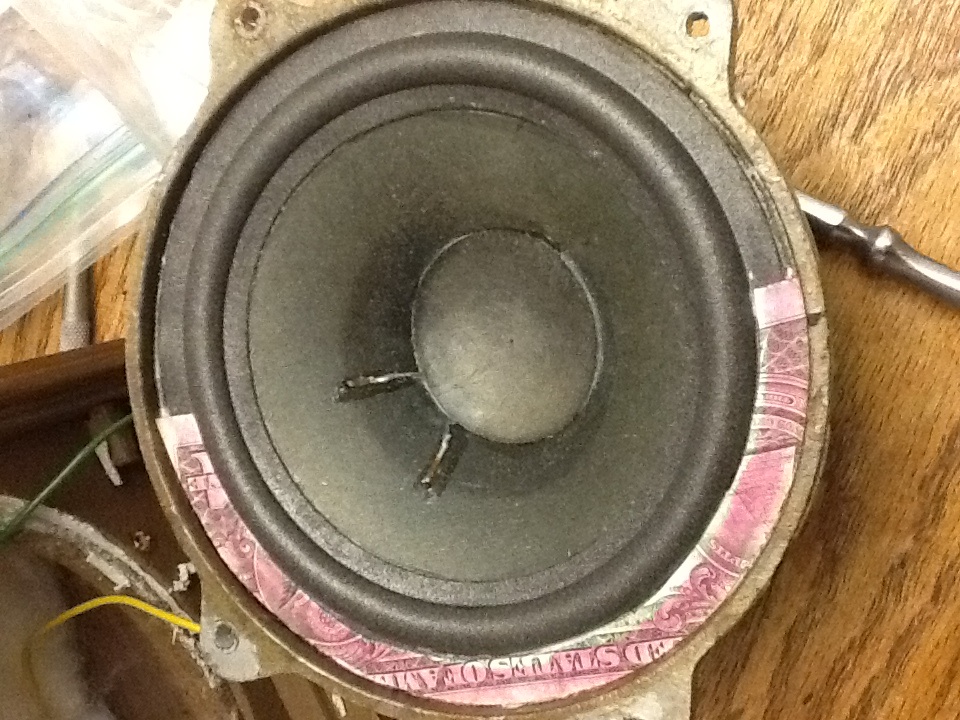

Foam replacement kit on ebay continued(2)
Well, the repair worked. The thin, cloth based paper is of course part of a dollar bill.
The second speaker foam was in much better condition, with just a few cracks. This i smeared with a layer of the glue that came with the kit. That seems to work, too.
Not bad for a pair of speakers I bought for fifteen quid from a thrift shop thirty years ago...

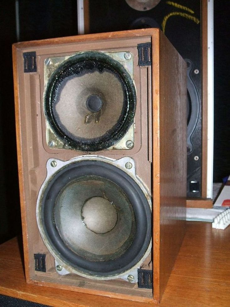

Talking of surround treatment, Just wondered what material is the grease used on the tweeter surrounds.
I have a pair of vintage woofers that use the same type of thick grease on their surrounds. ( The surrounds are made of cloth - Just like a spider - so to seal them, the factory used the grease)
Does anyone know what this material is and where can I get them?
