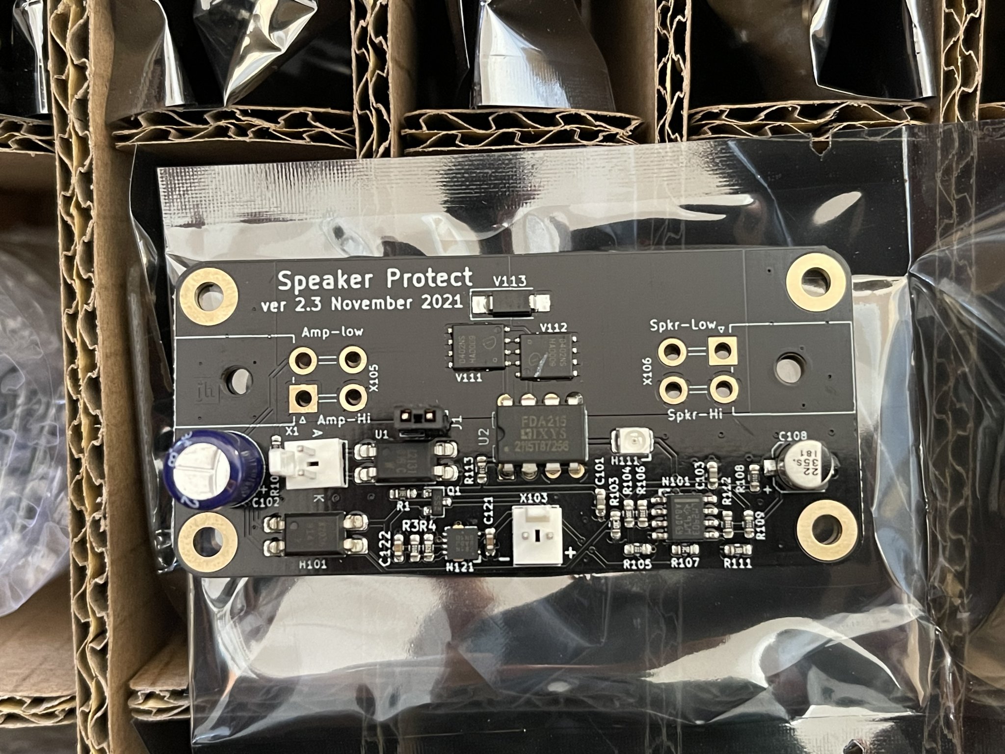

Hi Randy,
It sounds like the power amp (speaker) RTR SSR may be what you need. Those are available for immediate shipping from my shop for $120/pair.
https://www.etsy.com/listing/932716741/rtr-ssr-speaker-protection-gen23?ref=shop_home_recs_3&crt=1
They will also give you added benefit of turn on delay for no thump and instant off (via either open collector logic from your PSU or MCU, or via included bonus low capacitance PSU board) for no turn off thump.

To answer your question if the headphone ones would work, yes - the MOSFETs are rated for quite a high value and they could be used for speakers. The wire connections are smaller Molex KK 0.1in pitch though vs larger 0.250 Faston tabs or Molex MiniFit Jr connectors.

@jhofland
Great, thanks for the confirmation.
@xrk971
I know about your speaker protection board, just seems like overkill for my project.
I think I'll buy the headphone protection board, and give it a try.
HE6 is 54 ohms, so it will pull a lot less current than a speaker, and I'll hard wire/solder the connections, so I'm not too worried about the smaller connector.
