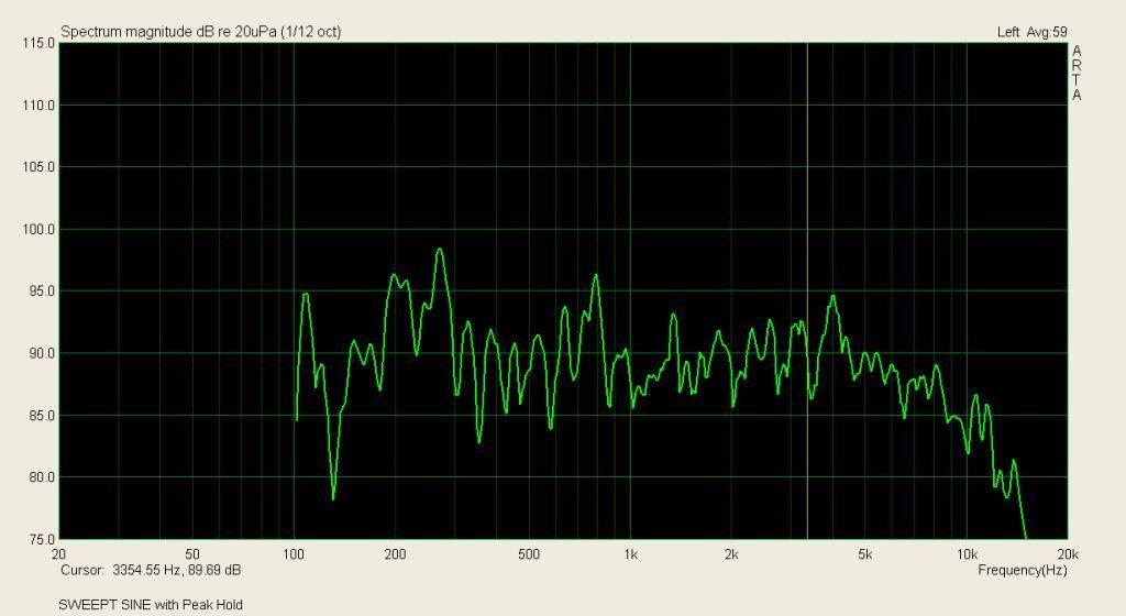

I found a swept sine wav file at audiocheck.net. Here is my measurement with peak holding.
Without signal in silent room below 2Khz the curve is klimbing from 15 DB up and down ! But flat above 2 khz within 2 db with smoothing on.
is the + 2 or 3 db at 4khz can give a brighty treble or peak energy in treble ?
Why below 2 khz without sound the curve is not flater ? Hope to be in topic.
Pink Noise give a diferent result with peaks at 3300, 4500, 6 to 7000 hz

I don't see a problem here. This s/w is measuring the level in fractional octave bands, so if your residual soundcard noise is essentially 'white', then you would expect the plot of the noise to rise at 3dB per octave. At a first glance, this appears to be what you get.
This is the reason why you use a pink noise signal for fractional-octave RTA measurements. (Pink noise rolls off at -3dB per octave, so produces a flat response curve when measured by an RTA). If your plot was measuring the noise in bands of equal Hertz (perhaps in 1kHz wide bands) then you would see a flat measurement result if the noise is white.

Don't want to high jack the post of Jayadev. Sorry for my low knowledge, but does it mean that I don't have to be frighten by big variation of the curve in a silent room when my mic and RTA are switched on ?
Because the low end of the mic+room are always enough flat (I have peak of more 10 or 15 db below 1,5 khz in silent room) for sweep sine or pink noise injected ?
Is it another way to say that with pink noise injected with a good enough micro (here ECM8000), I will see only the trouble of room+speaker in bass area and not the relation between mic+soundcard+phantom powersupply added to the measurement of the speaker ?
Given a muted input, the absolute noise floor is below -100dB, slope being irrelevant at such low levels. This is a 'good' result. If you have -80dB noise floor with mic turned on and gain set correctly (0dB input to output, 60dB at mic producing 60dB at loudspeaker) that would be classified as 'Excellent'. It is practically impossible to have actual noise floor below -60dB in most urban settings. I don't know where you live, but most cities in India are frightfully noisy at all times of the day. In a very quiet, untreated room in the middle of the night, I get about -50dB when the microphone is set to 'medium' sensitivity. Real noise floor is closer to -40, treatment can improve this handily but I haven't got around to doing it.

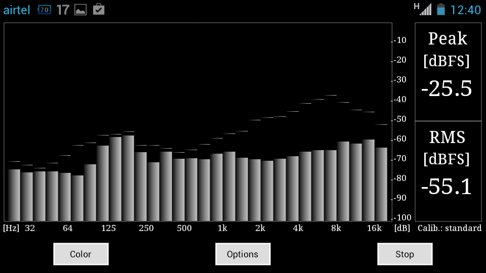

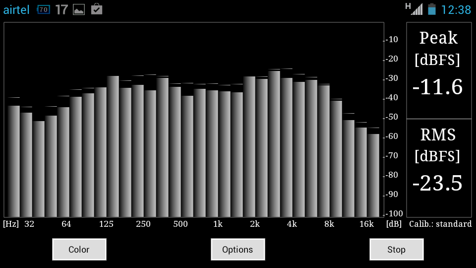

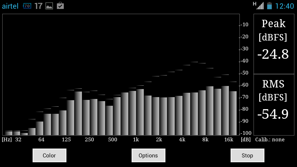

BTW I tried to do more experiments with existing phone mic and measured the woofer and tweeters separately:
Default reading when app is loaded in the room without playing any sound, only PC was on:
Reading of the room after loading standard calibration:

Reading of pinknoise on the woofer:
Is it fully inaccurate or is it giving atleast little bit of idea?

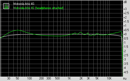

This is what gsmarean says about Moto Atrix mic which I have :
Motorola Atrix 4G review: Enter the Atrix - GSMArena.com
That graph is for headphone output, not microphone input. GSMA does not measure mic response.

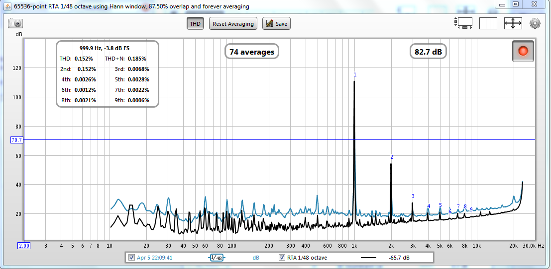

I bought a generic usb soundcard because my current laptop (lenovo x230) doesn't have a mic input.
The usb soundcard I bought gives horrible measurement. In the attached picture, the blue plot corresponds to the loopback in/out, while the black plot is from an iphone 5 source.
I borrowed my sister's macbook pro and I got good thd+n levels (< 0.001%) with its built in mic input, but I don't want to use it for my amplifier measurements.
I also tried my cheap generic usb card on the mac book pro, and of course, the result is almost the same on the attached picture.
